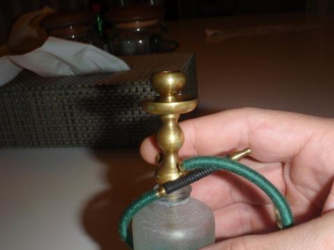

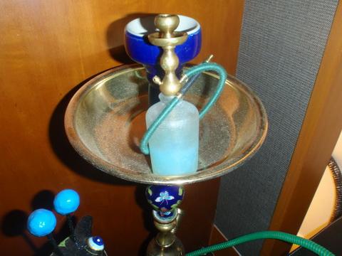

Over the past few weeks i have been making some drip tips, but because of the limited amount of knowledge i have on a metal lathe they all appear to be similar in shape .
I was wanting to know how is it possible to achieve tapered and bevelled shapes by using a lathe.
The first picture show's a couple of drip tip that I have made.
second picture show's some of the shapes I would like to achieve.

There's several ways I know of. But the easiest would probably be to just file them on the lathe.
Make sure you read up on it so you do it safely though. Using a file without a handle or getting a sleeve snagged on the chuck could do a real number on you.

You either need to grind a form tool or have a cnc lathe

Yup. They are used for E-cigs. Not the kind you buy all pre-made... more for the advanced e-cig user. It allows you to "drip" you nicotine liquid into your e-cig without having to basically take it apart.
I made a bunch for my nephew when he tried to break out into to vaping (smoking e-cigs) business.
Just make sure you are using stainless steel.
As far as shapes? Try using a ball turning attachment on the lathe...

You could file up a form tool from sheet metal and make a basic follower mechanism for the cross-slide. Use the compound slide to advance the tool.

Thank you for the reply Pete, I've just tried to goggle a  "follower mechanism" but I could find anything, would you be able to point me in the right direction please.
Re: How do i achieve this?
« Reply #15 on: November 15, 2013, 03:08:35 PM »
Use the term 'tracer attachment', you'll find what you want.

Do you intend to produce many of these to close tolerances? Since they're mostly decorative you could just rough out the majority of the material with plunge cuts and a parting tool, then smooth the steps with a file and emery tape. If you need to keep close enough to a plan for some reason you could figure out how far to plunge each step.
Here's a shoddy representation.
Although the way i'd do them would just be to cut the bulk material free hand with the carriage and crosslide handwheel and file it smooth.
I know there's a great temptation to try do everything in clever and overly technical ways, but it's just not worth it for these one-off jobs. Keep it simple.

Those forms can be quite easily achieved on a lathe, you will however need a 'radius turner' to make things easy.
Have a look at 'Divided he ads' (Ralph) posts.

As you have called yourself 'Piper' and show a strangled octopus :lol: you should know what a chanter and drones looks like.
So the question is how did they make them? Actually, it is simple enough if you forget these dreadful carbide inserts and think that there are other things which remove metal or wood. What carves nice shapes in pipes and a lot of other things is not fancy carbides or fancier exotics but plain and simple 'form tools' in carbon steel or better high speed stuff.
I made me a left hand and right handed pair of form tools to do my chanter and drones in ten minutes.
You don't need fancy stuff, you need form tools.

« Reply #38 on: November 17, 2013, 01:29:46 PM »
No need for a ball turner since doing one offs and no need to set up.
Far easier and twenty times quicker making or using a ground up form tool or even a carbide radius works extremely well I do it daily but limited to 9.5mm depth. 2 mins for above shaping tops polished, really simple.
Offline piper1
  • Posts: 61
« Reply #39 on: November 17, 2013, 01:38:08 PM »
Thank you, would you have any more information/pictures about a ground up form tool setup please.
Offline Jonny
  • Posts: 780
« Reply #40 on: November 24, 2013, 04:46:35 PM »
You have a couple of options, one may be to grind a hss tool up to required shape but that's probably ok if doing a few or more.
If its one or two off I would just use a selection of normal tools and literally rough it out to shape then an easy sand in maybe even file amazingly easy.
To do the shaping in 1st piccy dead simple, set your favourite tool at an angle plunge in and profile. The angles left should be finished item.
Radiuses have to keep an eye on what your doing by eg moving carriage 1/2 pace of cross slide so working the two together and constantly altering as curvature changes.
Other way is to set top slide to cut specific angles maybe in conjunction with opposite side of tool.
