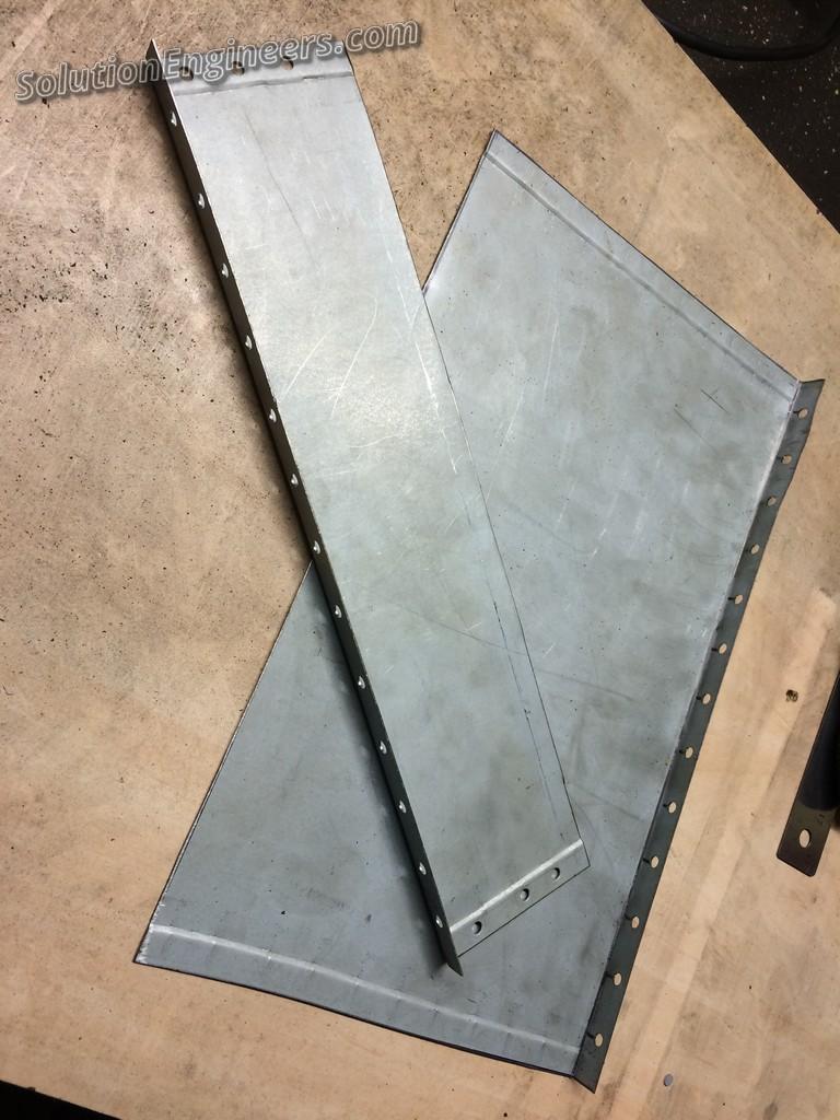

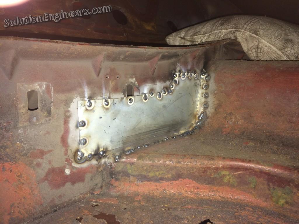

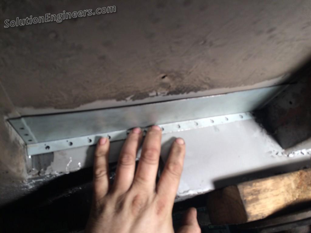

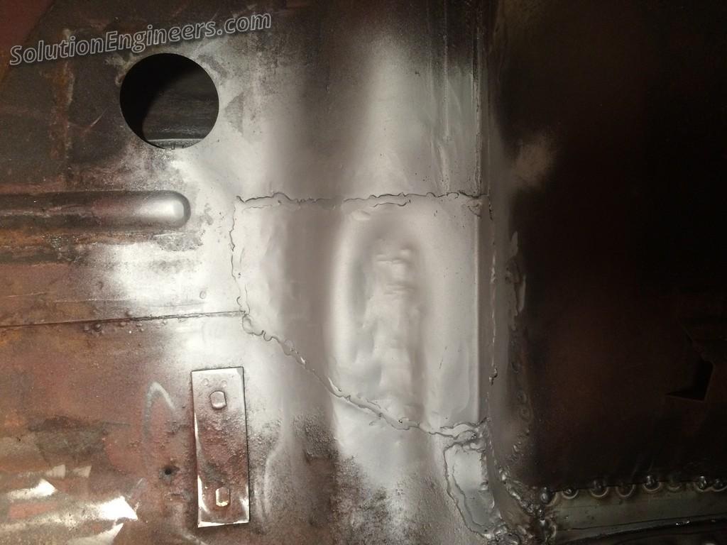

So... not a lot new under the sun, but I did get photos of the newly welded in panels. Damn, but welding to rust hurts (sparks, t-shirt, pain)... I clearly need plenty more practice with the MIG too...
The photos show a panel which rises vertically from the rear of the floorpan, up to form the front of the rear seat base. The rear seat bottom then runs downwards at 45 degrees (roughly), intercepting another panel which runs horizontally backwards from a couple of inches above the floorpan, which then curves up to allow the rear subframe to sit in place. It's a bizzare affair, but it does make a nice strong triangular section. Nice and strong, that is, until the water gets in & can't get out, at which point it starts eating....
Anyway, I cut the floor pan back, made a cardboard template of the area in question, cut the sheet out & welded it in. The first one got some plug welds in the middle for extra pizazz. The second one didn't because, well, I forgot OK. Too keen to play with the power tools....

Looking good. A tip I use for car body is use a lowish current and pulse the trigger. Also although you normally 'push' mig I then to point the wire away from the direction of travel so the wire goes into the pool. Stops it burning away so easy.
Like I  say though nice job :)

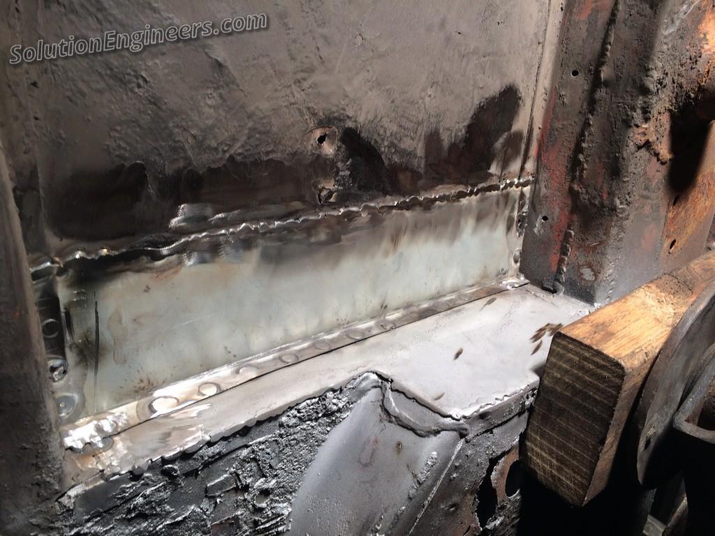

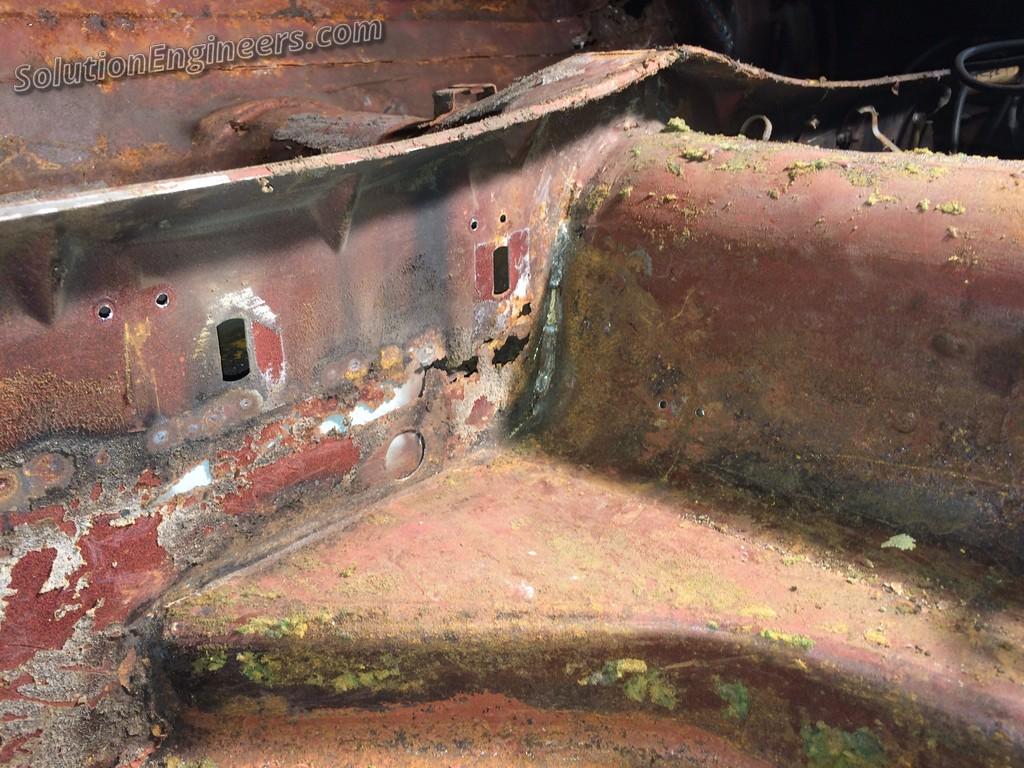

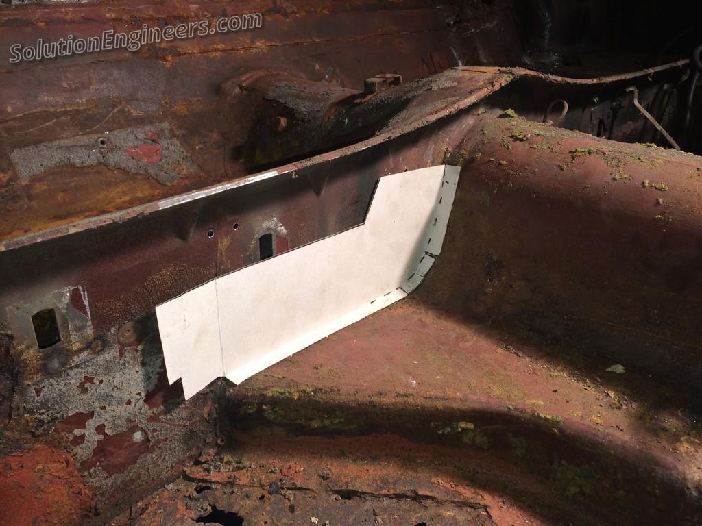

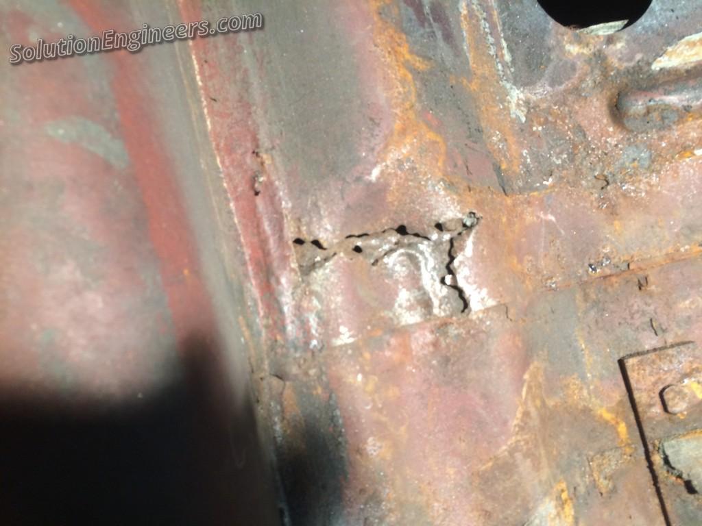

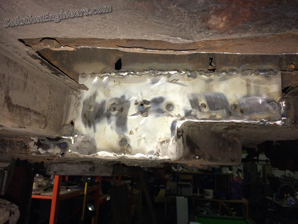

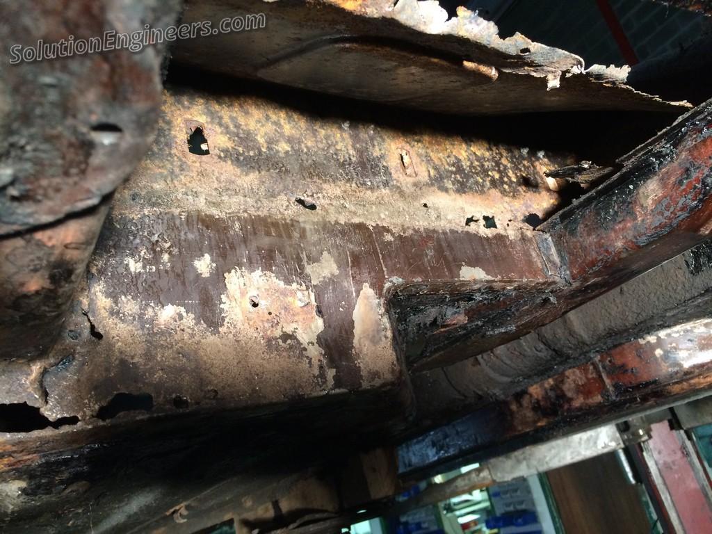

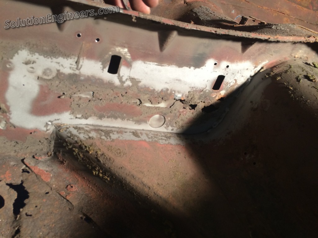

This weekend was "tackle the rusty chassis rail" weekend.... so, the panel was prepped:
There used to be a flange there where 3 panels all met & were welded together; but the flange had rusted to almost nothing. So, I've decided to simply weld a flat plate over the lot, it'll be seam and plug welded in, so should be plenty strong enough:

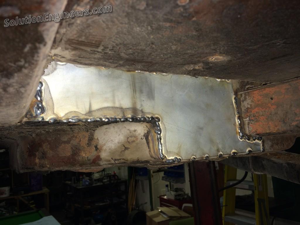

Welded in:
Grind back the welds, and blow over with some weld-through primer:
The other side wasn't quite so bad, just a bit frilly around the edges. So a smaller patch was made & welded in:
Then tittivated:
Finally, the outer box strip is formed, and welded into place, before being tarted up with a quick spray of the silvery stuff:

Meanwhile.... more of the same old, same old. Find rust, tidy up around rust, make plate, weld plate in, blow over with zinc primer, rinse & repeat....
Pics show: The plates I made up to close the holes I cut in the floor. A new plate on the inside of the cabin which go where the front of the back seats are. I'm not sure what that bit's called. Anyway, it's frilly as hell, so it gets beefed up. Finally, the rear seat back corners are holed on both sides, so a plate is made up to cover the damage. Lacking the properly shaped hammers, my colleague used the back of an impact screwdriver to make the basic curve shape, tack welds were used to keep everything in place while the next bit of corner was made. Just visible in the last picture, is a V-shaped piece which ties the wheel well back to the body of the car...
I haven't started on the floor pans yet....

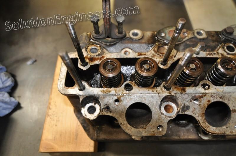

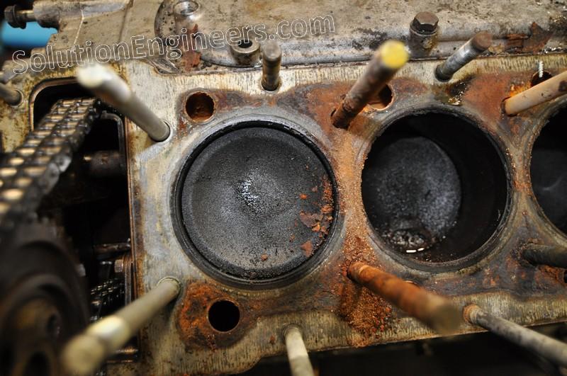

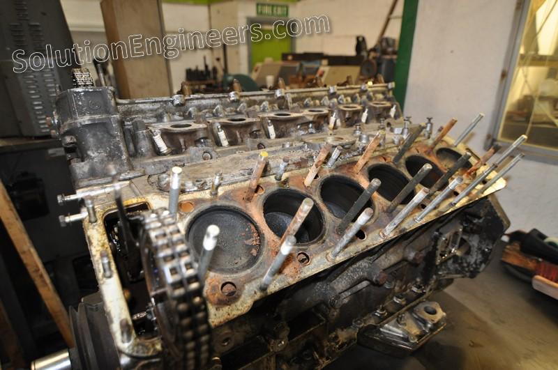

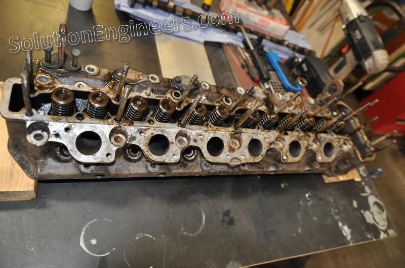

The time has come to bite the damn bullet and strip the engine down to its component parts for thorough cleaning, measuring, etc.

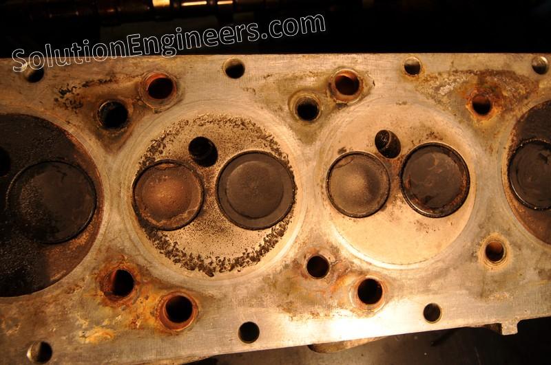

First off, "B" bank cam, cam carrier, and head is removed. This operation goes surprisingly easily - I was expecting a bigger fight from the head, in the end it virtually popped off all by itself. The interior of the engine is dirty, and has collected a fair amount of debris, kind of what I expected really.  Everything seems to be in relatively good order though, although I have yet to measure everything & check for warpage, etc. A good soak in solvent plus some vigorous scrubbing is bringing the parts up like new (no photos of the clean stuff yet).
  • Posts: 2462
Re: Jaguar XJS V12 racing car
« Reply #67 on: January 27, 2015, 06:53:11 PM »

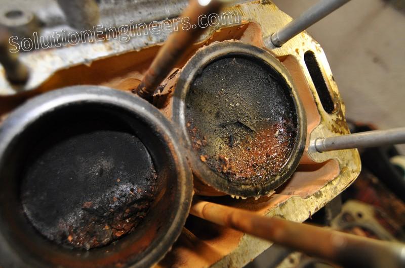

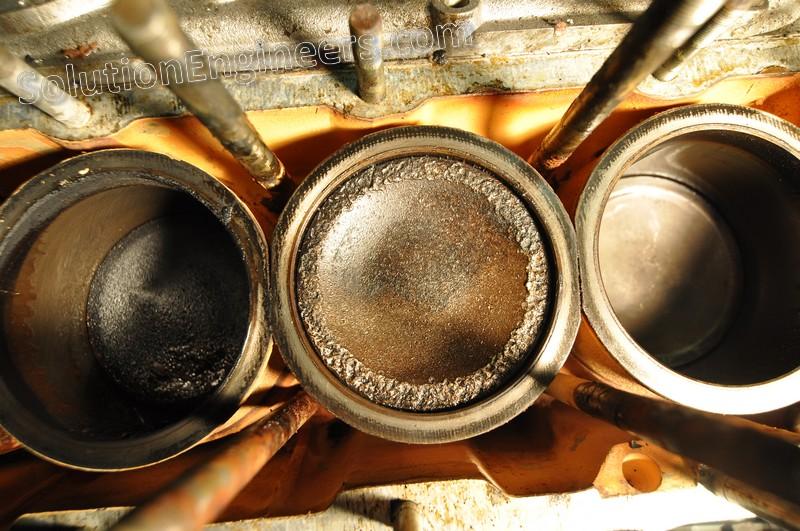

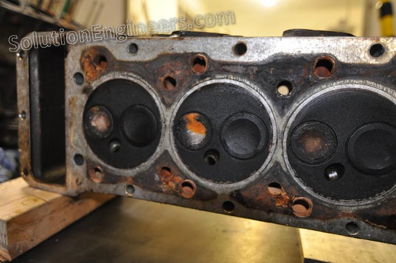

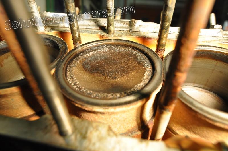

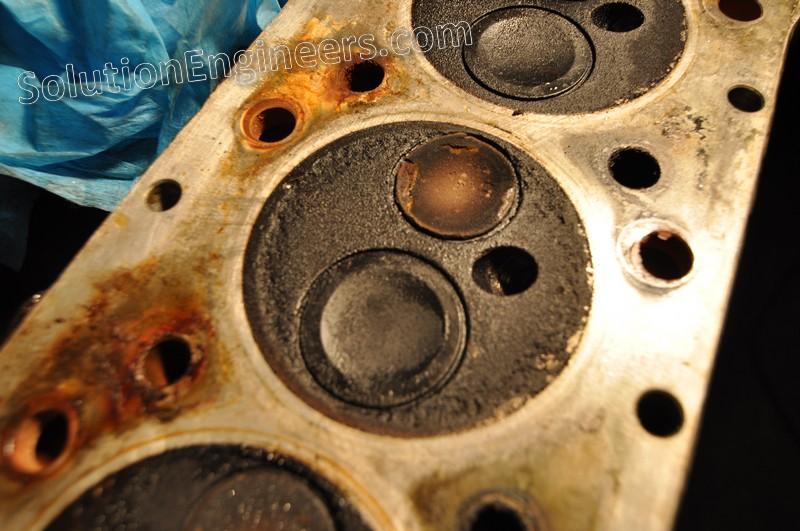

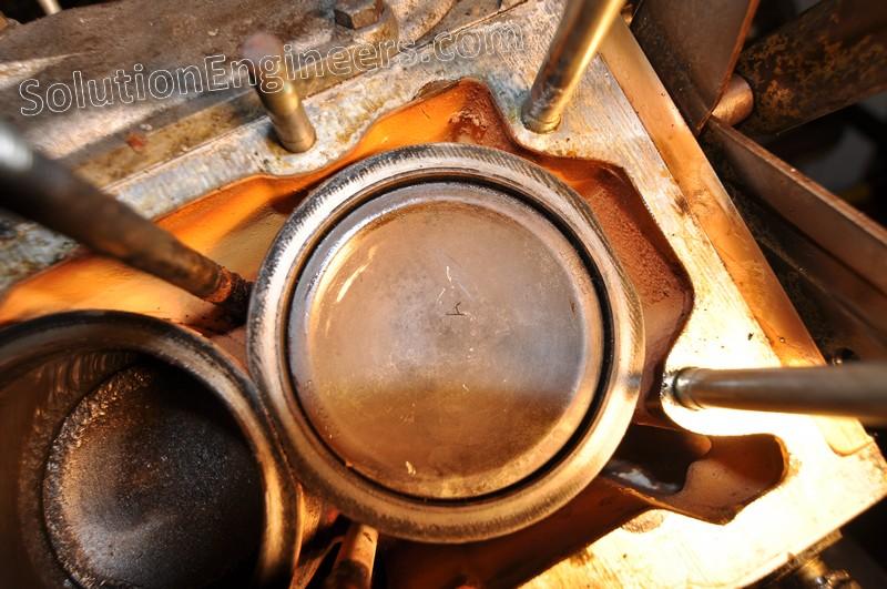

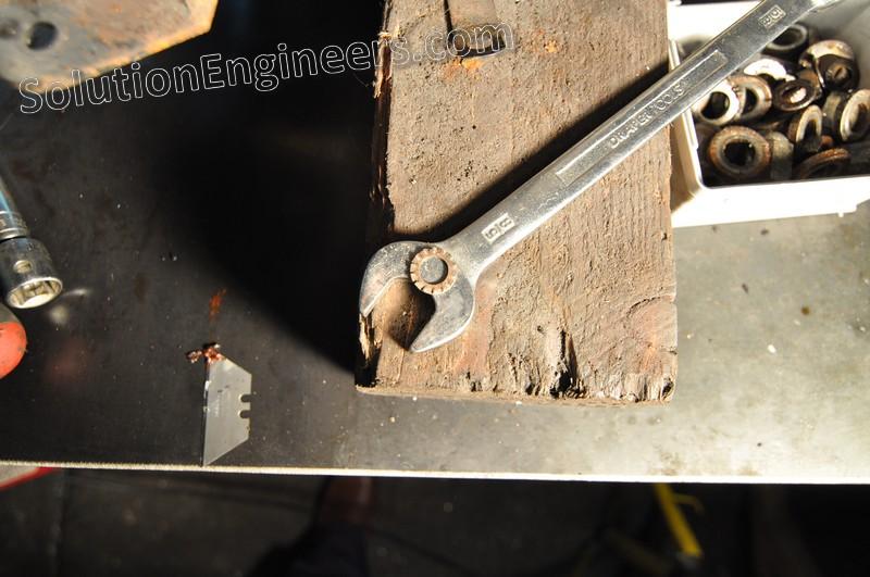

Stripping "A" bank revealed a bit of a problem... No 2A has had a small washer - about 1/2" diameter - banging around in the combustion chamber for an unknown period of time. The piston has taken the brunt of the beating, but there's some damage to the head as well. Hopefully, it's all repairable with a TIG welder, some filler rods, and someone with a decent surface grinder.
  • Posts: 2462
« Reply #68 on: January 27, 2015, 07:05:43 PM »
So... strip-down wise, there's not a lot left. All the studs came out - eventually, and in one piece - unlike my Halfrauds stud extractor set which balked at the 2nd head stud! Thank goodness for the rather more robust Draper unit, although that has its frustrations; it has a tendancy to come apart into its constituent components as you try to free the now jammed in stud. Hey ho.
So... sump to come off, oil pump, rods & pistons out, main caps off, crank out, liners out, and then we can begin cleaning & measuring the block...
What is coming out: 5.3 litre spec liners, pistons, rods, crankshaft.
What's going in: 6mm bigger liners (96 vs 90mm), same rods, new shorter pistons, 6 litre crankshaft.
The crankshaft will give me an extra 8.5mm stroke, the bore an extra 6mm diameter, all told I should end up with an engine that displaces 6.8 litres (416in3) and - if I can get the volumetric efficiency up where I need it, I should see north of 600bhp and 480lbs/ft torque...

Ouch, and it would be a hardened spring washer, too. Looks in perfect shape!  You're doing a great job here. Nice to see this car coming back to former glory. Well surpassing it at some point.  :thumbup: :bow:

I am probably being totally ignorant of something obvious here, but how in hell does a spring washer end up inside a piston - has it been there since build?
  • Posts: 542
« Reply #72 on: January 28, 2015, 05:27:29 AM »
Well if there are washers under the heads of air filter housing mountings they can be sucked in.
It happened on one of my cars (a long time ago) on the A1(M).  It made a dreadful noise.  I got it towed off the motorway and took the head off on a garage forecourt to extract the washer.

interesting. I'm amazed there is space for it to fit, but then I guess for good gas flow the spaces should be big!

The pre-HE V12 actually has quite a large space (0.150" at TDC) between the top of the piston and the head, so there's room for the washer to sit in there & fly around the place. All the dings are half-moon shaped, so it's obviously when it's landed edge-on that it's done the damage.
Given that the heads were relatively easy to remove, I'm thinking they've been off before - probably not that long ago in mileage terms. I'm also thinking they re-used the head bolts, judging by how well held in they were by comparison... I imagine the washer got in the last time any serious work was done on it. If you leave the inlet manifold on on a normal Jag, it's almost impossible to get anything into the cylinders; if you take the manifold off, it's almost impossible to keep stuff out!
Apparently, Jag V12s are prone to dropping valve seats if they're overheated (being an interference fit), but because there's so many cylinders and so much sound deadening in the cabin, all that can be heard is a faint tinkling sound - even though the seat is being beaten to a pulp by the valve...
