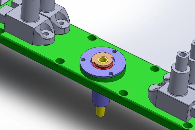

So... whilst waiting for the parts to arrive, I've embarked on a bit of design work for the engine. Since I'm not using the traditional distributor, my original plan was simply to delete this, and build a new valley plate to house my 12 coils. Most modern petrol engines use coil-on-plug; and since most are also dual over-head cam, the plug (with its looong nose), goes between the two cams. As this engine is single OHC, this is impossible, so the plugs are off to one side, and there's no room for the nose. In fact, there's no room for the coil on top either - so mine will be coil-near-plug, the next best alternative.
Here's the original valley plate (so called because it sits in the "valley" between the two banks of cylinders):
And here's my alternative design. The inset is a Mazda RX-8 coil (not to scale), I'll be using 12 of them:
(obviously, I'll be using green aluminium.... (c) Brian Rupnow (with apologies to Brian)
And here it is fully populated:
I may add some upstands to help support the higher level coils... or I may just beef up the mounting posts somewhat. Milling that lot out of solid will be a horrendous waste of material, so I'll just make spacers to suit.

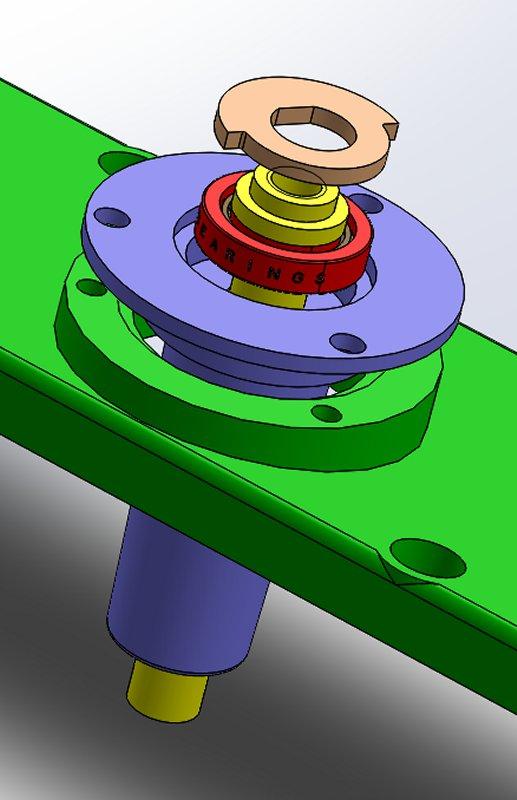

The empty middle section will contain the nub end of the old dizzy drive, with a single tooth wheel & sensor built in, that will give me the cam position accurately enough to sync the ECU with the engine. All that will be visible will be an aluminium cap with some wires coming out. Straddling that will be the new throttle tower, which will convert the pull of the throttle cable via bell cranks to the push/pull motion needed to open the 12 ITBs. More on  that later.
I have a slight problem with the dizzy drive mounting... it has to be in exactly the right place and tipped at 6 degrees from  the horizontal to match the original, and I'm not sure how to measure it up. Please see my question in "How do I?", which I'll be posting in a few minutes.

Iff youre mill table is long enugh pack the lower side up , untill a clock guage reads zero on the distributor mount , and skim off the rest , mount your plate and spotface for the bolts .

If you're using a single tooth wheel to get the cam position isn't there an easier way to achieve that - for example a sensor in the timing chain/belt cover sensing a lump on the camshaft wheel - or a sensor detecting something on the end of the distributor drive.  Using the distributor sounds over complicated, difficult to machine and heavier than necessary.

Hi Jeff - good post, that got me thinking along the same lines as Sparky over on the "How Do I??" thread. I can use a DTI on the existing plate to set the angle up, and then drill/bore the hole in the right place & at the right angle on the new valley plate.
Russell - there's nowhere "tidy" to fit a single-tooth wheel. Obviously the cam housing is full of oil, and unlike (for example) the Lexus which has an external cam drive (because it's belt driven), the Jaguar is chain driven & thus immersed in oil. The next shaft of note is the dizzy drive shaft, which I can't avoid using (it's driven by a sprocket at the based of the "V", where you'd find the single cam of a pushrod engine). This is also bathed in oil, being just above the thrashing crankshaft. The dizzy drive is accomplished with a helical gearset at the end of the shaft, which pushes vertically(ish) up out of the valley plate.
I plan to use that shaft, but I'll re-create the bottom of the dizzy (only smaller) and simply mount my 1 tooth wheel on the shaft, the sensor in the housing, and a small cap to go over the top of the lot. It should only end up around 2" diameter, maybe less. The main reason for the 40mm hole is to fit a ball bearing race inside, on which the shaft runs.
I'll get it all drawn up this week so you can see where I'm going with it.

Iff you skim off the mountnig lugs , your vally plate will be at 6 degrees and the distibutor square to it .

Get yourself a dissy from and XJRS that had Zytec, It has the 12 choppers but also another ring with just the one tooth. They have dodgy pickups with odd voltages so a dead one might come very cheap and just add a suitable pickup.
Another place for the single pickup is the back of the B cam. I have this on my XJR5 for real early Lucus Micos injection system.
XJR5 006
