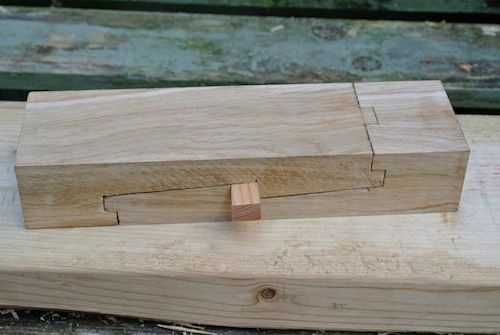

As no-one's complained, or kicked me off for working on the brown stuff, here's another one.
For my next trick, I will attempt to make a scarf joint, without aid of assistants or a safety net, you people in the front three rows may wish to stand back a bit, or at least don a Mackintosh.
Once again, cut a bit of oak off the bit of oak I really really wanted to get this cut square as I’m still not brilliant at this.  It seems that I can do it when not concentrating, but not when I am?!?  So I found an old trick to help.  First knife your mark square, then chisel into it a bit then cut on this mark;
…zzzd zzzd zzd zzd and you should have a perfectly square cut, did I?  Did I b*****y!;
So I thought I’d trim the end, using a nice square block of wood as a guide (luckily I’d made one earlier);
….now we should have a nice square end.  However we still actually had a b******d end so I took the block plane to it and Viola;
Time for a quick walk wi’ t’ apprentice.  Boy, you need to see my nuts now, much bigger than the last time I showed you, plus the weather’s cooler now;
Back at the wood and I’ve discovered that the white pithy bits are white rot.  This is a fungal thing and was in the tree when it was still standing.  It appears to travel up the grain and turns the wood to fluff.  I’m not sure how much is in the whole lot, but this bit of the block just fell out.  The wood on either side of the ring seems sound;
…ssshhhhh shhh ssshhhh, with the plane, ooh that’s a nice shaving;
…..and we have a nice square lump of wood, just a touch of work to remove a slight slope and it’ll be great.  I think I’m getting better as I haven’t had to take as much off to get this square;
As the Hampshire monsoon is upon us again, I’m taking the time to work out whether to do a Japanese scarf, or an English one.  In many respects they’re identical with the odd slight difference.  There are some English ones every bit as fiendish as the Japanese ones.  This is the “Kanawa Tsugi” which is one option;
I’ll put some thinking tea on (Taylor’s Yorkshire today) and look up some more and get back to you if I’ve made a decision or when I’ve b******d up some more wood.
Procrastination; now is that an art or a craft skill?

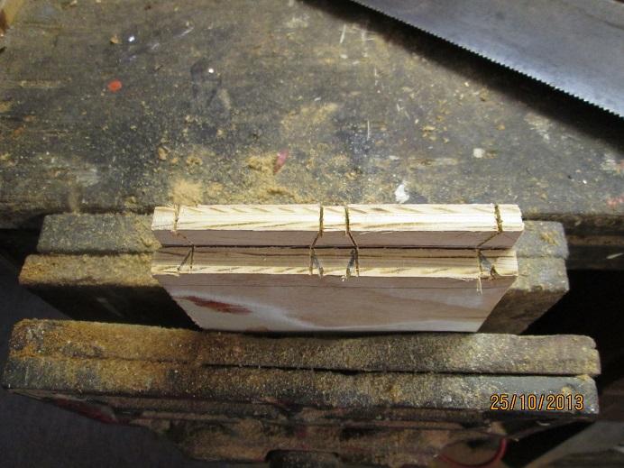

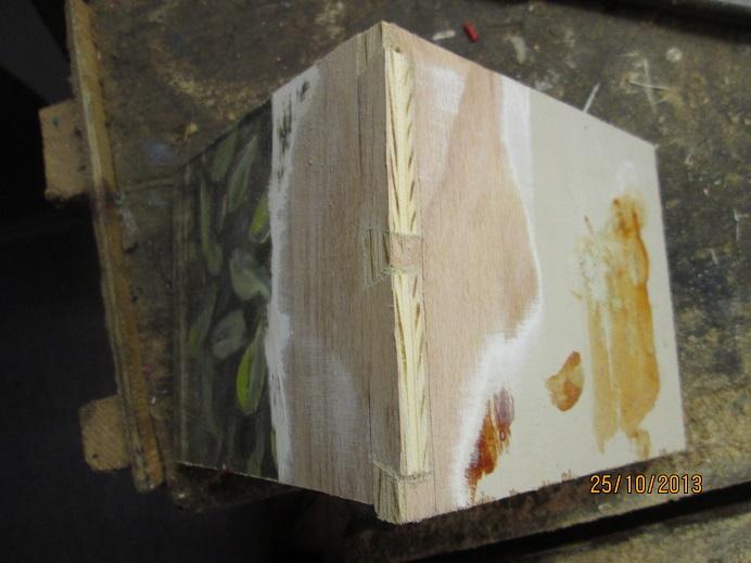

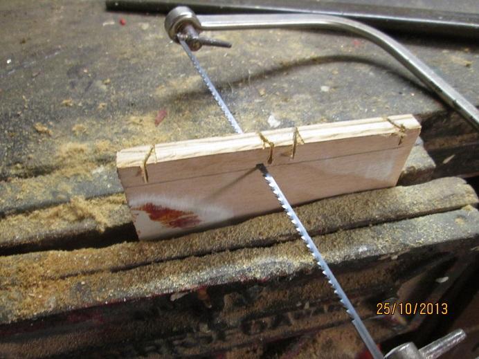

Another suggestion for cutting off square with a Japanese saw -- always mark with a knife all 4 sides of the cut, then with the saw, cut in all 4 sides slightly -- say an 1/8" deep along those marks. Go back to your first side and then do the cutoff.
Marking all 4 sides checks that your marking is true and square and accurate -- since the lines won't meet up if not.
Cutting all 4 sides gives you mechanical guides -- guides the saw in the cut (like a miter box) and also prevents break out at the bottom corner of the cut.
Of course to mark all 4 sides truly, you cannot have a rough side as you do in the first few pix. Sides must be trued first for a square to mark the cut properly.
Keep up the good work. Persistence pays off!  :thumbup:

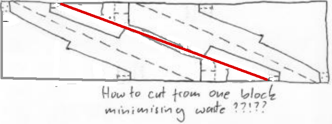

I've gone for cutting the block in half as I think that's more like what would happen in "real life", plus the challenge of marking the joints out was getting beyond the current brand of tea :scratch:.
Suggestion: mark out a template and use that to mark your stock. I like aluminum flashing for that. You can move it around and get best cut usage on your stock. Plus it becomes a lifetime tool to add to your collection. Plus it creates uniformity in your joints.

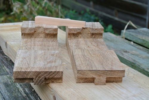

Meanwhile, back at the ranch; Unusually for me “ahem”, progress has been slow for the past couple of days, could be due to the weather;
I had managed to split the wood into two bits, I had intended to cut diagonally to save on waste and had had some good suggestions on how to do this, but in the end I just cut ‘em square(ish);
Next I planned how to mark the joints out.  There are some conventions to do this, based on the width of a Japanese square (15mm), which helps speed up and accuratise (that’s not a word is it!) marking out.  Not having one of these I sort of approximated.  I made the length of the slope 3x the width of the wood, not including the “noses” and did everything else in English;
…and then knifed this into the wood, highlighting in pen;
I’ve marked a face and face edge on both bits of wood to try and mark from the same reference, initially I was going to mark both out before applying saw, but I really couldn’t be bothered so will mark part 2 from the finished part 1.  The weather cleared, so I ran out, set up the “bench” and started a bit of ripping, following the order in the book only to completely go off line and create a compound curve inside the wood;
….ho hum, I could always go back to plastic models for a hobby!  I cross-cut out the waste;
…bashed a chisel with a hitting stick;
…started to plane the slope to the knife line, with a 60 ½ and the heavens opened, so I called it a day, Sunday I think I called it!

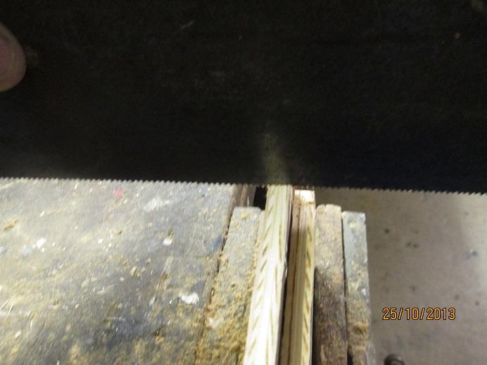

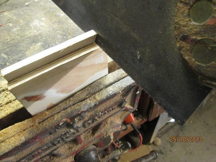

Well you got me making videos now  :zap:
Don't know if this will help, but it shows what I do using a Japanese saw to make a square cut on a piece of scrap. The cut is marked with a machinist square and a sharp scriber all the way around. Checked for truth (making sure lines all connect). Then the saw is used to cut slightly into the piece at the scribed lines all around. Finally it is cut through.
The resulting cut is square when checked on all 4 sides, using no miter box, poor quality scrap wood ripped from a stud, no vise, and a pretty wobbly hold, too. (I was trying to keep it in view.)
About 2-1/2 minutes to mark out and cut -- and that was slow to make it a demo.
[embed=600,400]<iframe width="600" height="400" src="http://player.vimeo.com/video/77343287" frameborder="0" webkitallowfullscreen mozallowfullscreen allowfullscreen></iframe>[/embed]
Re: More wood butchering from Ross, Scarf Joint
« Reply #18 on: October 20, 2013, 03:56:15 PM »

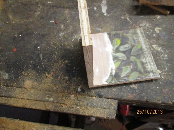

Because the video is not very good resolution, here are still shots of that cut, from all 4 sides:
Side 1
Side 2
Side 3
Side 4

VTSteam, thanks for the time and effort in putting that together :thumbup:
It makes great sense.  So far I'd read and understood the technique where, at least it appeared that a cut is made part way through one face, rotate and do the next line part way, rotate etc.  Doing that I was just undercutting on four lines :palm:.  I'll try your technique next.
I think I'll try this on the rip cut for the next piece, cutting a kerf as far down each side on the line as I can.
It's nice to see someone else working outdoors, though that's what I'd expect from the other side of the "pond".  You also seem to have better weather.

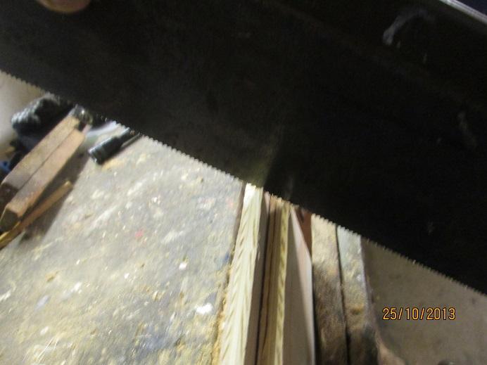

You're welcome Ross! I thought it might be helpful also to see the angle of the saw while cutting -- a picture (or video) is worth a thousand words. I start each marking cut with the saw a little higher than finishing that cut, etc. Think of pulling the saw along the line. These saws cut on the draw stroke. Think of them as string, and you're trying to draw a flexible piece of string across the marked line. The grip should mainly be the thumb and side of forefinger. Hand should be on top of the handle. That lets the handle pivot and stay level. Don't grip like a tennis racquet.
Good luck!

Unfortunately your hand is just out of shot.
I've seen confusing pictures of holding the handle, some have the thumb pointing along the blade, some pointing down.  I think my thumb tends to point along the blade on the top of the handle.  You may be right and I'm holding it like a tennis racquet (I'm rubbish at tennis :().

Well, one half of the joint’s done, not overly impressed with my skills but hey-ho.  Not much work done today either.  First off, I used the block plane to get the “lower slope” flat and even, then pared with the chisel the “upper” slope as there was no way to get in there, unless I used the shoulder plane and therefore couldn’t be a***d.  Then I managed to b****r up the rebate at the top by being too enthusiastic with hitting stick and chisel.  Additionally, this rebate was narrow and the only chisel I had to match was now ground skew!!;
Then I chipped away at the tenony thing on the end, this time using a gentler touch and going a bit slower;
Boy, I’ve been taught chiselling by about 5 different people and appear to have forgotten everything they must have told me.  This bit came out relatively satisfactory though.  So here we are, one half of a scarf;
I’ve marked the other half, from this and if the weather improves we’ll see if I can do this in one day.

Finito Benito, or some such.  Yesterday I found that the “step” in the middle had to be re-cut a bit, at an angle for the wedge.  I couldn’t actually put the two halves together initially as it got in the way.  I’m not sure whether this is something I missed from the book or just messed up when marking out.  After last night’s deluge of Diluvian proportions, plus thunder and lightning (very, very frightening, ooh Galileo…….), which had left an inch of water in the tea mug, I was surprised to find a dry and sunny morning.  So out pops I, pare, pare, pare, scrape, scrape, scrape and;
….two joint parts which almost fit together and a hand planed wedge, which also fits, almost!  Starting to put them together;
Put together and wedged loosely….;
…..and here’s four bits of oak pretending to be two, along with my outdoors plane collection;
I’m sure I’ve learnt a lot more than I think, including not giving up when things all go ***s up.  One thing I have learnt is why the Japanese build their houses out of softwood and not seasoned oak!  I need more practice on the pull-saw, chisels and not rushing, but overall I’d have to say there are a number of things about it, which are positive.  One was that both parts of the joint were straight and flush to each other…….hmmm, not sure what the others are, but I’ll come back if I remember.

At last here is the sweat shop method for cutting dovetails (Victorian), my grandfather taught me. Being the 7th generation of carpenter and last I have 2 daughters. If they were starting work today one would be a good carpenter.  Having done her own loft conversion, with a little help from me. I don't post very often as at my age it's nice to be a junior.
    I did a drawing but this site would not take the format, so I have done a demo instead.
 In to the fire wood box for some scrap. First place the pieces together & draw the line     (photo 1). Repeat on all the ends. If making a box 8 lines on 4 pieces of wood, clamp the wood in the vice. (photo 2, only making 1 joint so not placing the 2 back pieces). Run a thin bladed saw across the top (No 3), then dip down to just mark the lower piece or (pieces) (No 4) Next cut the the tails until just marking the lower piece. (No 5) Remove from vice using the marks on the end cut down to the line, remove the unwanted materiel with a copping saw. (No 6) Job done in 3 minuets flat.

Thanks RGY, that's a very neat job for 3 minutes work :thumbup:  I think I've got that.
Just to clarify on picture 5, the wider part of the pin is marked earlier with the saw, down from the higher board, in line with the wider part of the dovetail.  Then when the dovetail is cut, the saw lightly scores the top of the "pin board" at the narrower end of the dovetail, and you join the two marks for the pin, or more precisely just lay the saw across-wise from mark to mark and cut down to the line.
That's really good, no faffing about with dovetail squares etc  You just need to be good at holding the saw vertical for the pins.

« Reply #43 on: October 25, 2013, 12:32:07 PM »
Yes that's spot on. When I started my apprenticeship the first thing i had to learn was always cut square. Sorry second the first was sweep up & make the tea.
