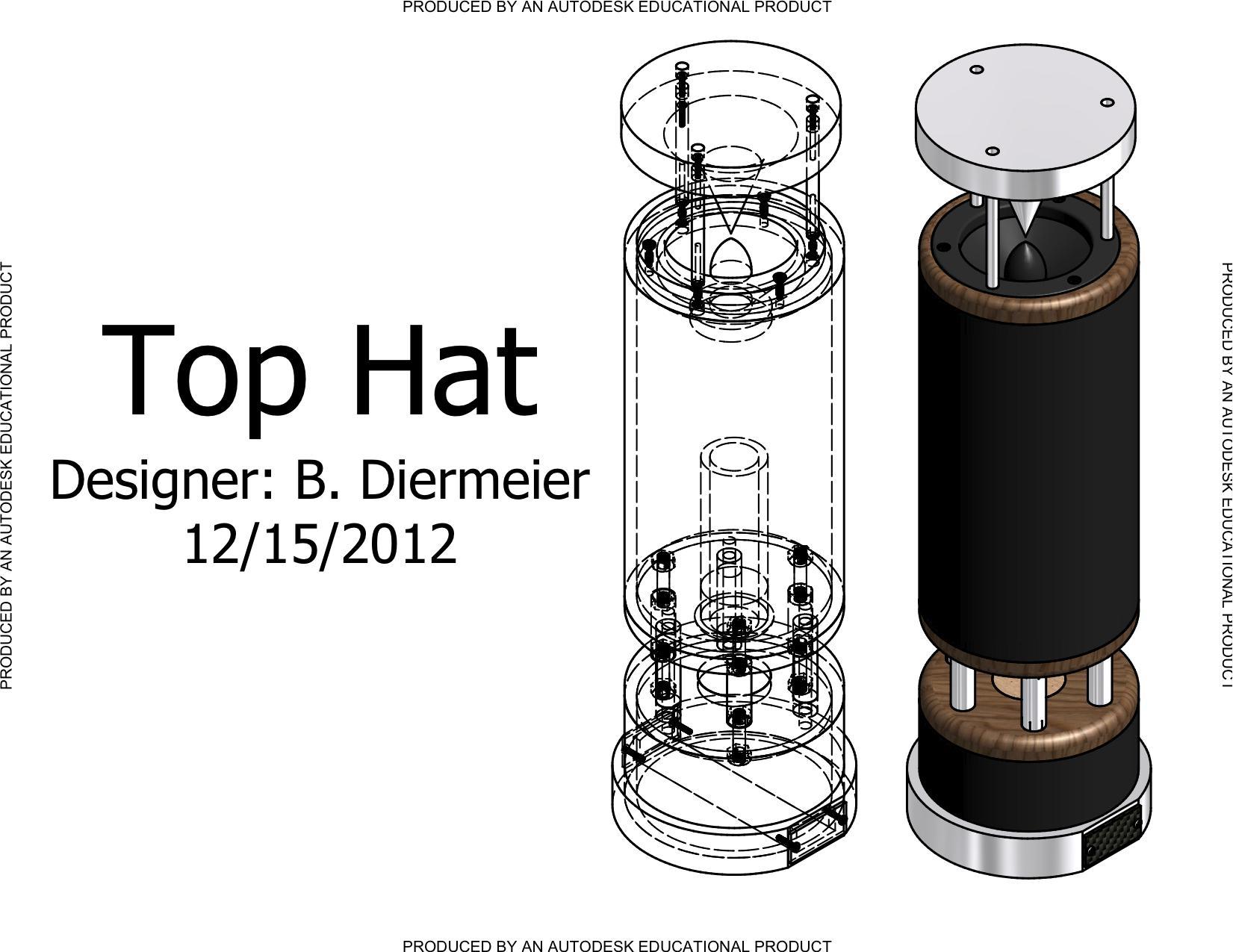

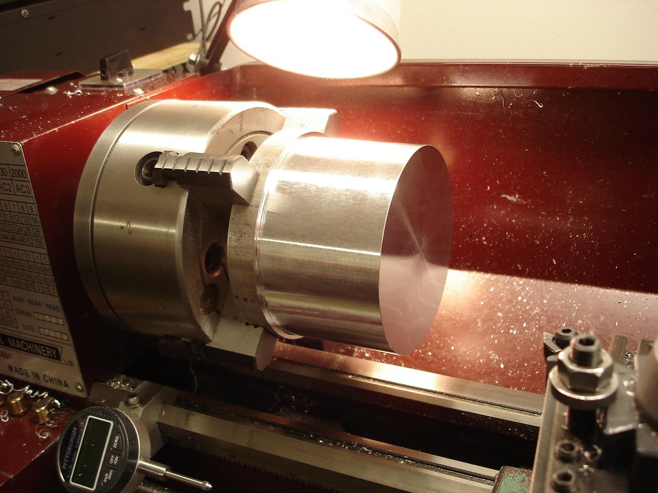

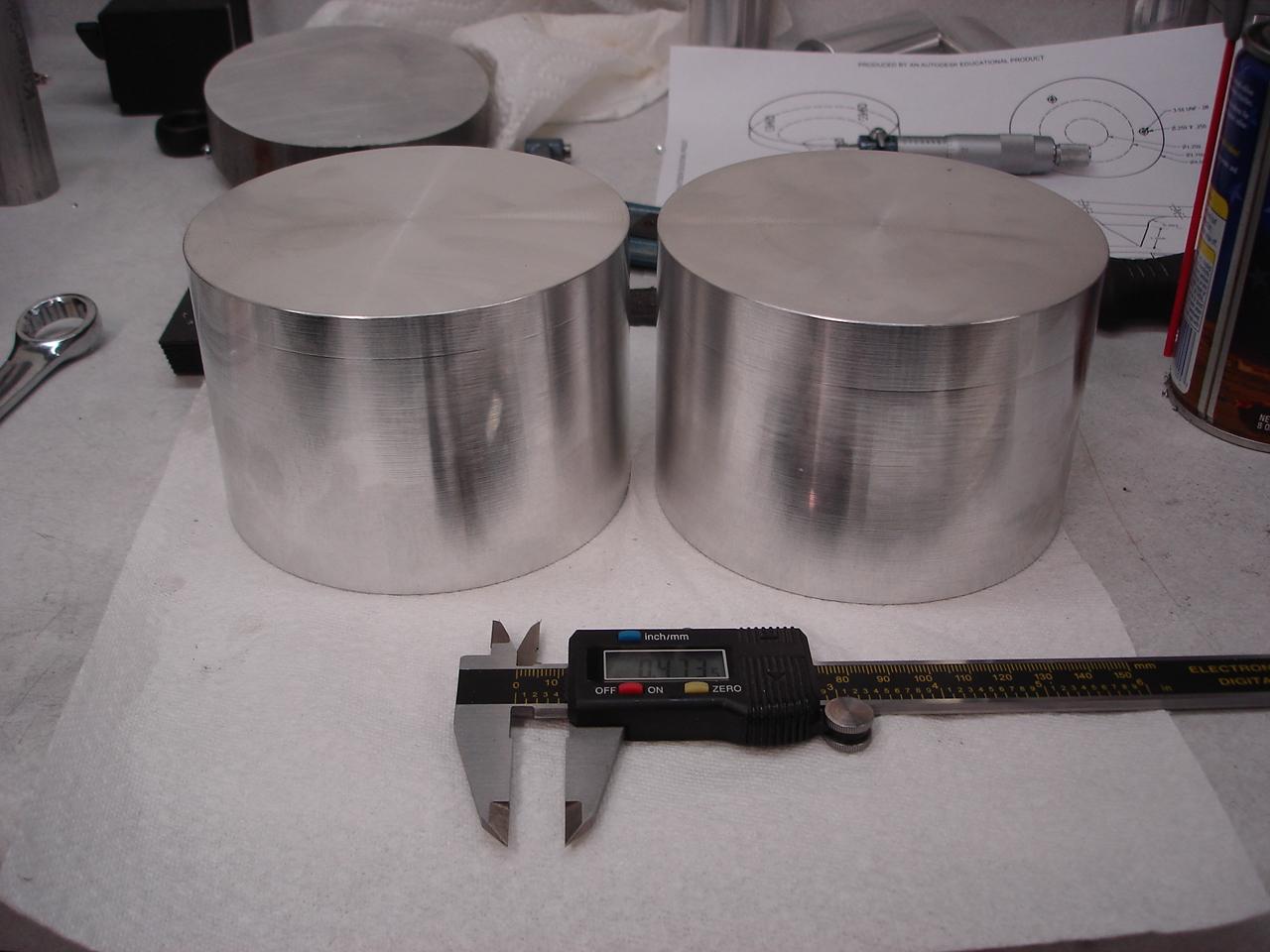

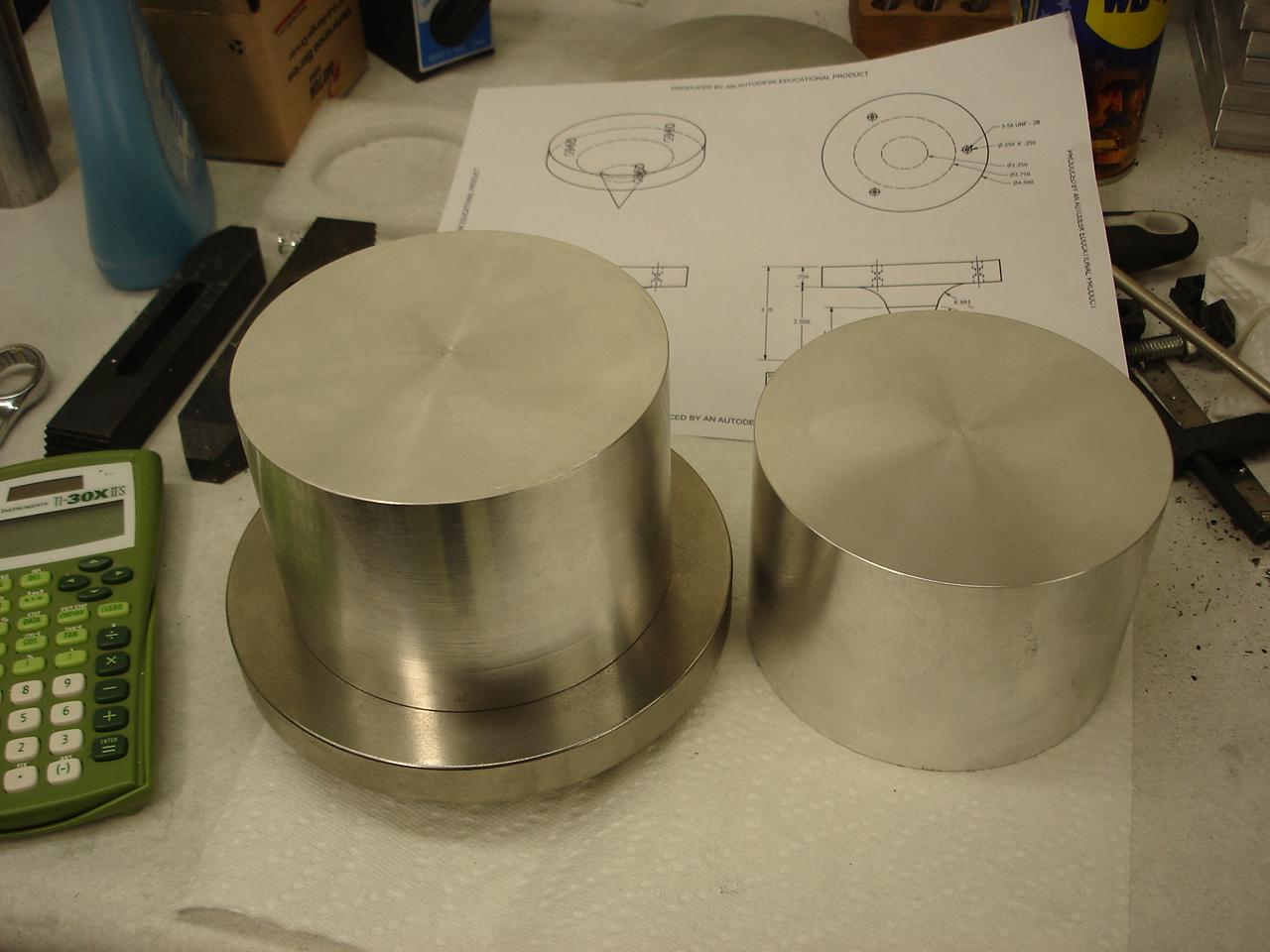

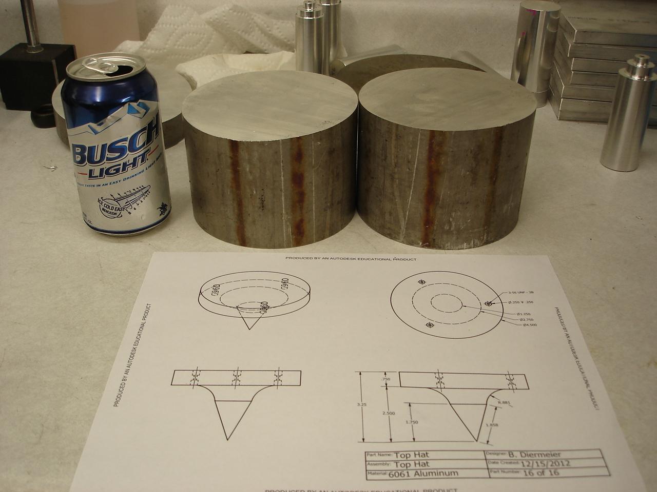

My 16 year old nephew drew up some prints for some desk top speakers and asked me to make some parts for them.  The speakers are full range and the "Top Hat" will disperse the sound in a 360* area.  The body of the speakers is made out of PVC plumbing pipe and the rest is aluminum and wood.  The pipe will be painted when done and the aluminum parts will be polished to a shine.
My challenge this week is to make the "Top Hat" part.  It starts off with a 5" diameter piece of aluminum that I rough cut in to two 3.5" pieces.  Then it's off to the lathe to face off the pieces and turn them down to 4.750 in diameter and 3.250 in length.  I had to use my 4 jaw 6" chuck as my 3 jaw was too small so it took a while to dial in each piece to the lathe.

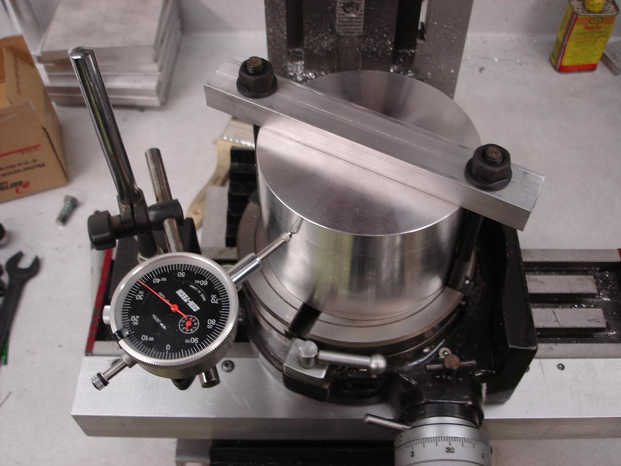

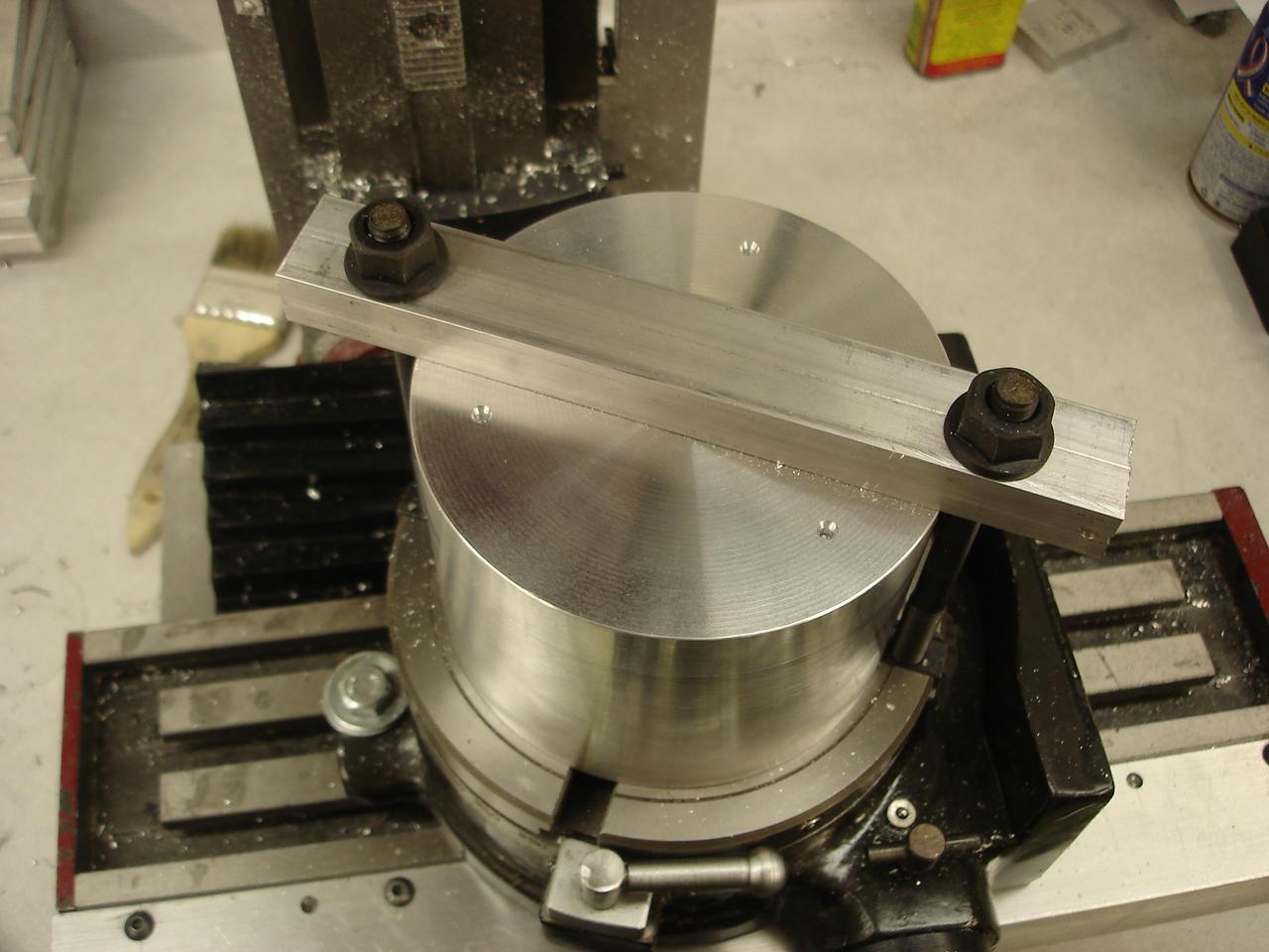

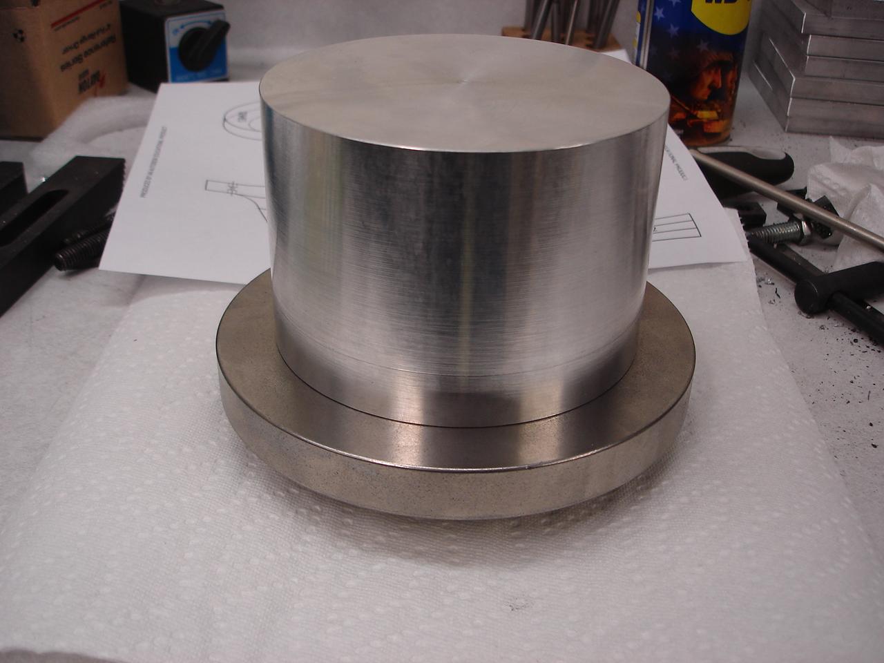

After turning the parts I moved over to the mill and set up the rotary table.  (This is one tool I don't use enough in the shop!)  I set up the rotary table to drill three holes equally spaced apart in the two parts which will be used to mount them to a face plate.  These holes also match up with three of the six holes in the speakers and will be used to hold up the top hat in the future.
It was a pain to get the parts dialed in to the rotary table, but after they were dialed in I drilled the three holes and tapped them for a 10-32 bolt which will hold them to the lathe face plate.

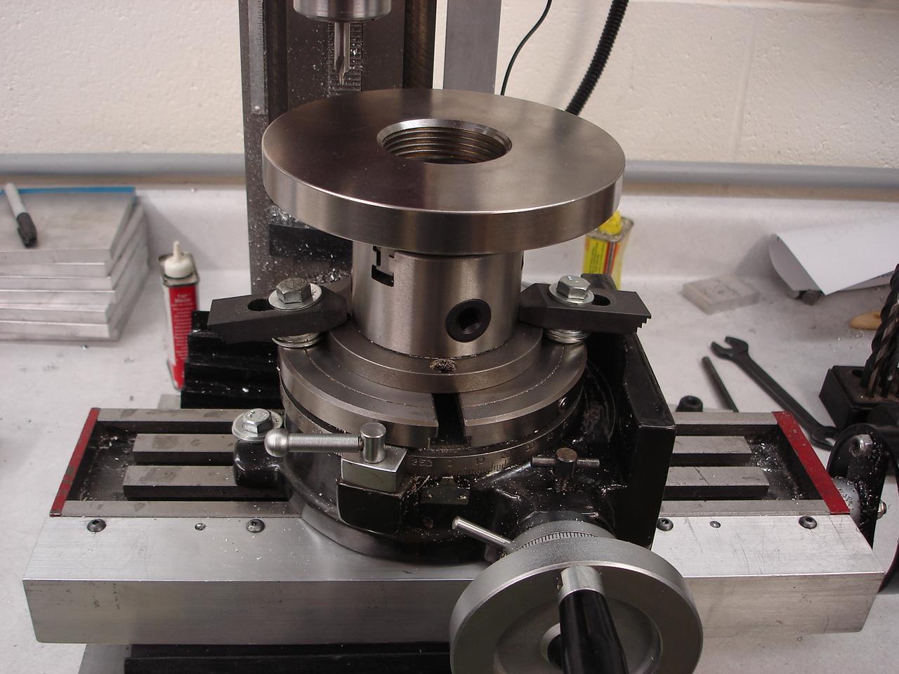

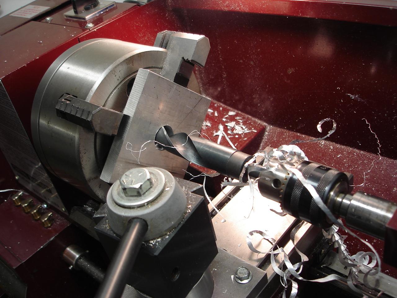

My CNC lathe doesn't have a face plate so I bought a 6" chuck adapter for the lathe and also mounted it to the rotary table and drilled the same three holes so I could bolt the parts to it in the future.
So here is where I call it a night. I have both parts ready to turn on the lathe and the face plate is ready to mount to the lathe.

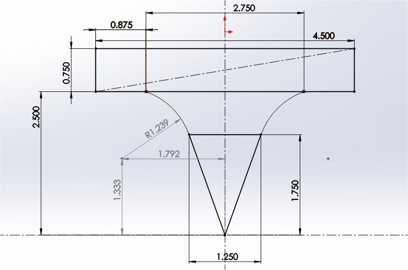

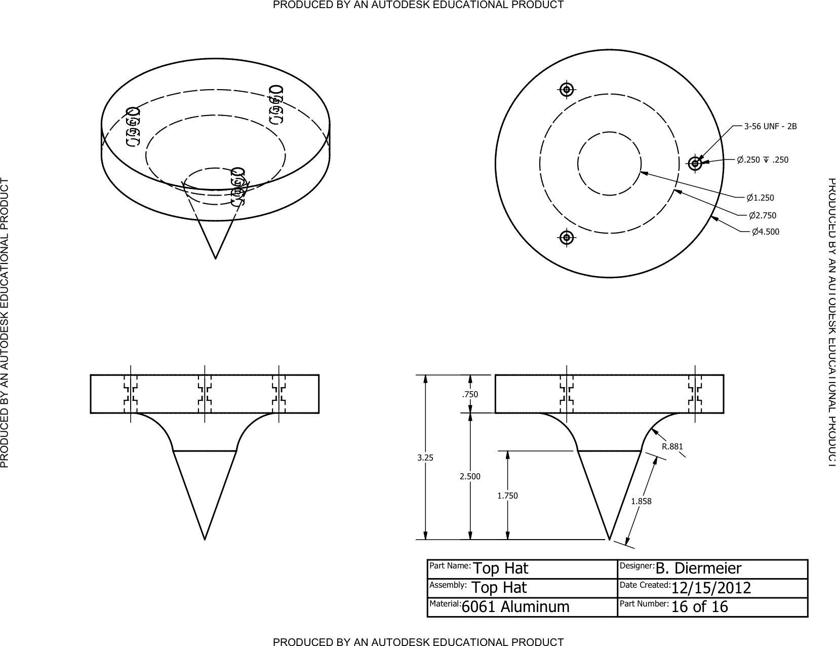

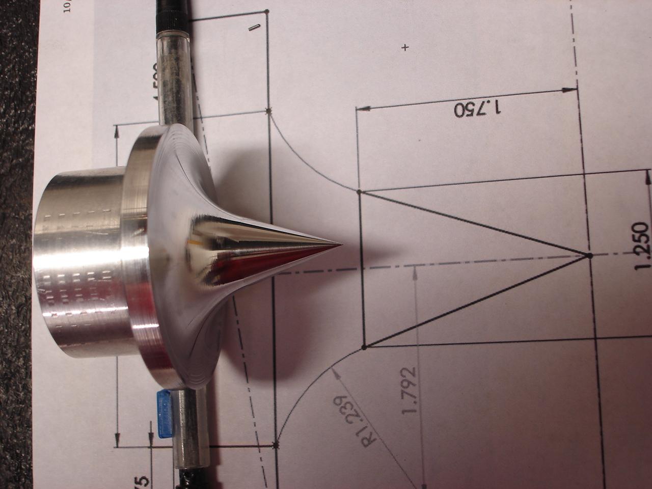

For anyone that can help with the G code, I'm ok with changing the Top Hat part a little from what is pictured.  I just as long as the taper is around 2.5" long and is around 2.75 inches in diameter in the end.  One nice smooth transition would be fine as the shape can be a little different than what is shown in the picture.  Just let me know if you have any questions.
Thanks for the help!

« Reply #4 on: October 09, 2013, 08:14:39 AM »
Nice work sir! Interesting speaker design too... I might be tempted to try one of those myself...
Anyway, I'm wondering if the blend problems you're having are actually in the drawing rather than the lathe; it looks to me like the radius cut is too deep, so the "exit" of the radius isn't at a tangent to the tapered section. When it cuts, is it leaving a sharp corner on what looks like a bit of a bump?
As you'd included a dimensioned drawing, I took the liberty of copying it but using the tangent arc feature, which suggests a radius of 1.239" instead of 0.881" - does that help?

AdeV  Thanks, I really like the revision and that is the look we are trying for.  I think a large part of my problem is that I don't have my tool programed into Mach so it doesn't know what type of cutting profile Im using on the tip of the tool.  This works Ok when I just use one wizard, but when I try to run two wizards back to back they don't blend well at the transition.  I should stop and take the time to fully set up Mach but I'm not fully sure if I understand how it all works so it's just easier to not mess with it!  :)
I'm going to make a test piece at half the size and see what I can come up with.  I will post pictures in a day or two if I get some free time to work on it again.

The gap is so a bass port can vent from the top pipe.  There are more drawings of the speakers that show the port, but I only posted a few pages of the print.
We are not sure if this is a good idea or not and plan to do some testing to see if it helps.  I'm kinda hoping it sounds better with out the port because it would be easier to build.

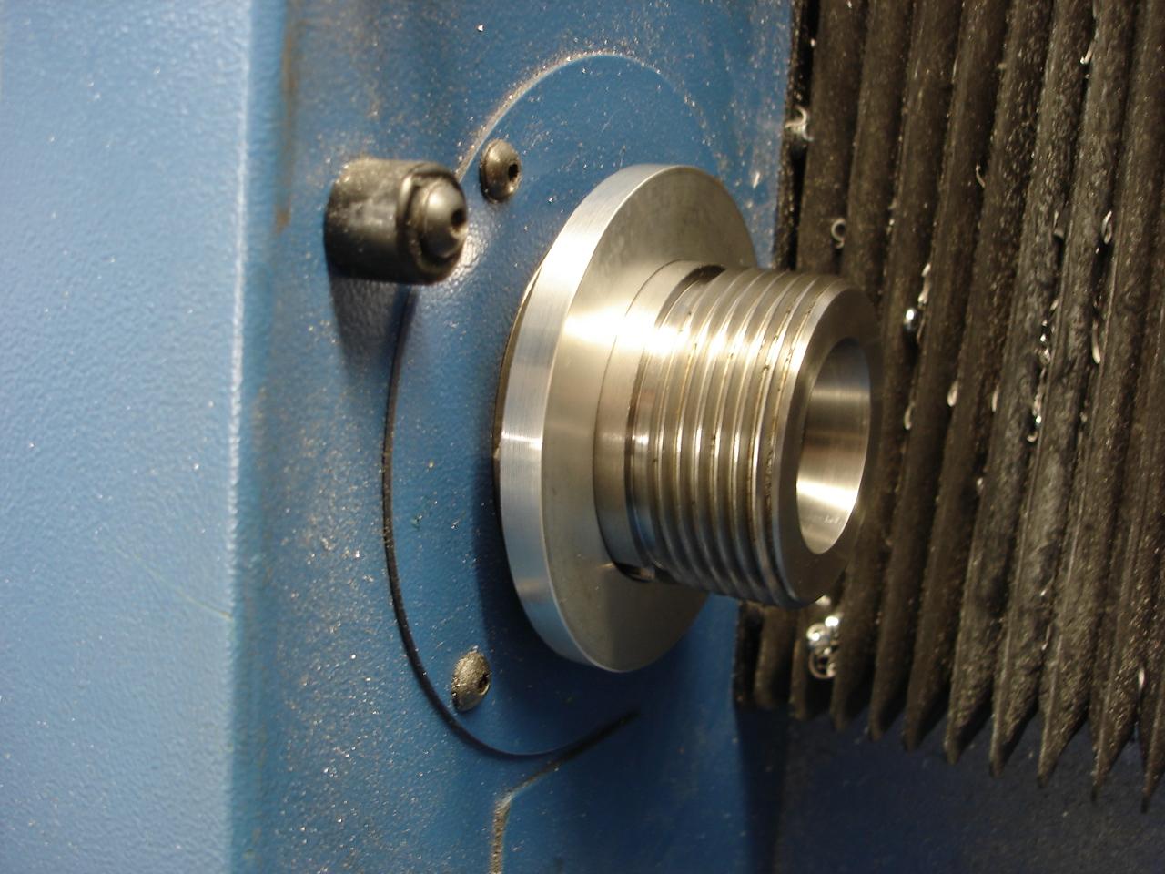

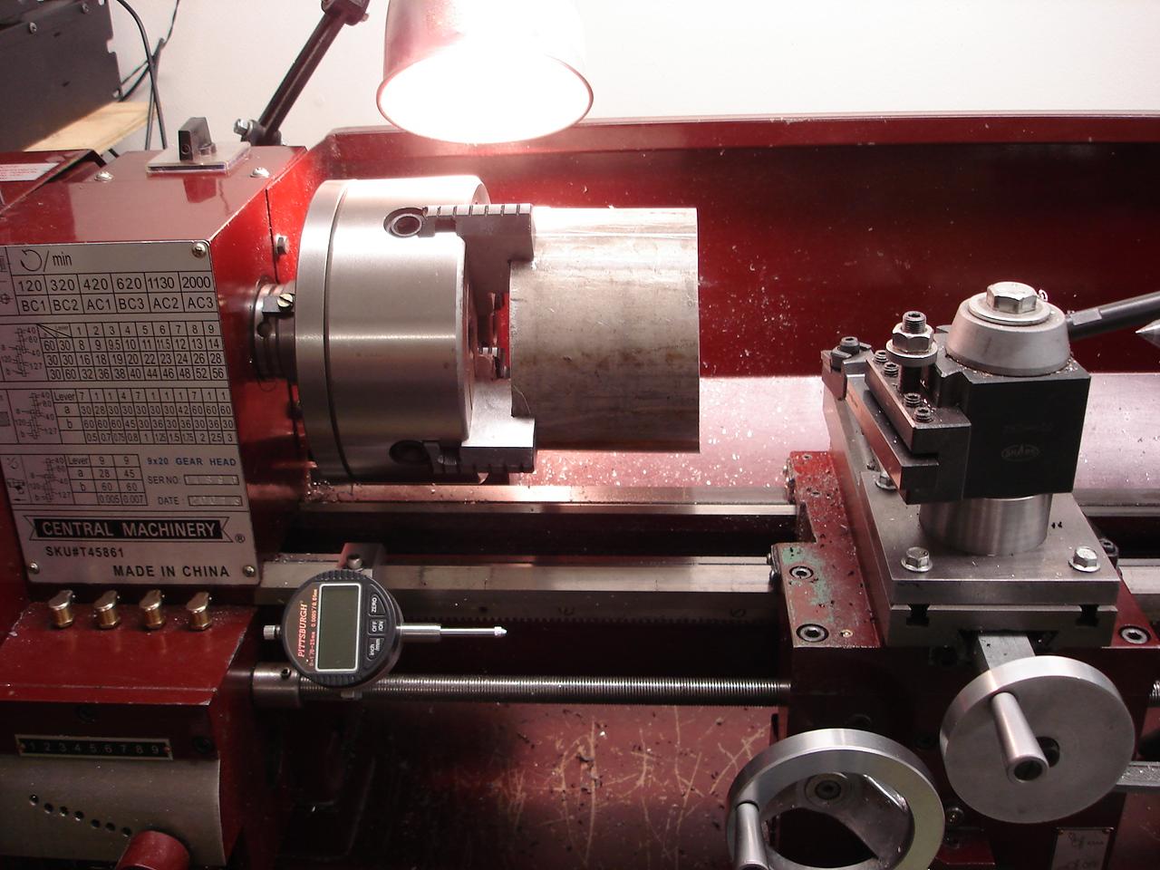

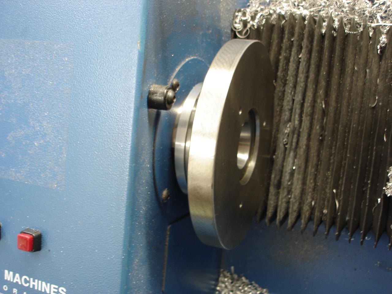

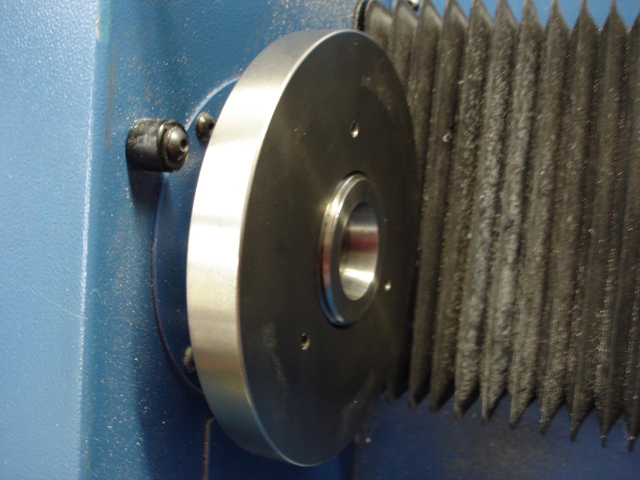

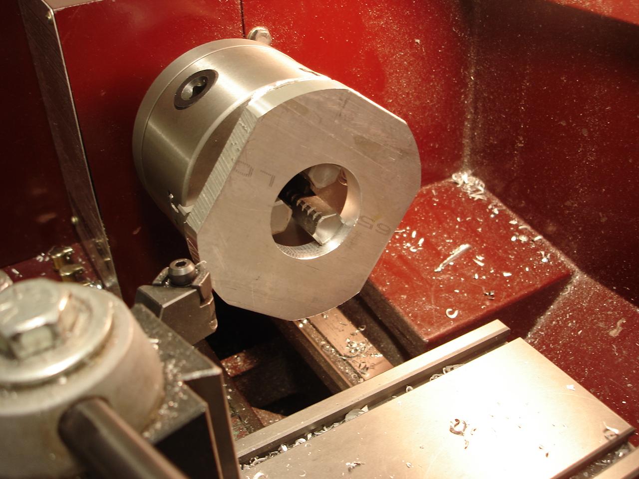

Tonight I was able to get in to the work shop and play around with the lathe.  After a few tries I was able to get a part made at 50% of the size that the finished part will be.  There is just a fine line where the taper and radius meet, but that should easily go away with a bit of polish.
I was just about to run the full size part when I ran into another snag.  The part will not fit in the chuck so I bought a chuck back plate to use as a face plate and simply bolted the part to it.  The trouble came when I tried to mount the face plate to the lathe and found that the face plate is 1/8" too short to fit.  The nose of the lathe sticks out of the face plate!  Now it looks like I will have to make up an adapter to hold the part out from the face plate so the nose of the lathe has room to stick out.
I'm really bummed as this was an expensive back plate make by South Bend and I was planning to re use it when this project was done to mount a new chuck for the lathe.  Now it looks like it will be a $75.00 piece of scrap metal.
Here are some pictures.
Dale P.

« Reply #17 on: October 27, 2013, 01:40:07 AM »
Dale,
Don't give up on the back plate, you may well be able to recess your new chuck to fit! On a chuck, the area around the base where the spindle is rarely critical. Back plates are ideally cast Iron to prevent locking on the nose thread. If you make a steel spacer for a new chuck, a thin plate would suffice, pinned to the back plate.

Thanks Matthew for the advice about mounting a future chuck.  Your probably right about making a recess on the new chuck, it's just something that I shouldn't have to do with a new chuck and back plate.  I send Grizzly a picture and asked them to add some dimensions to the web site so people could see what they were buying.

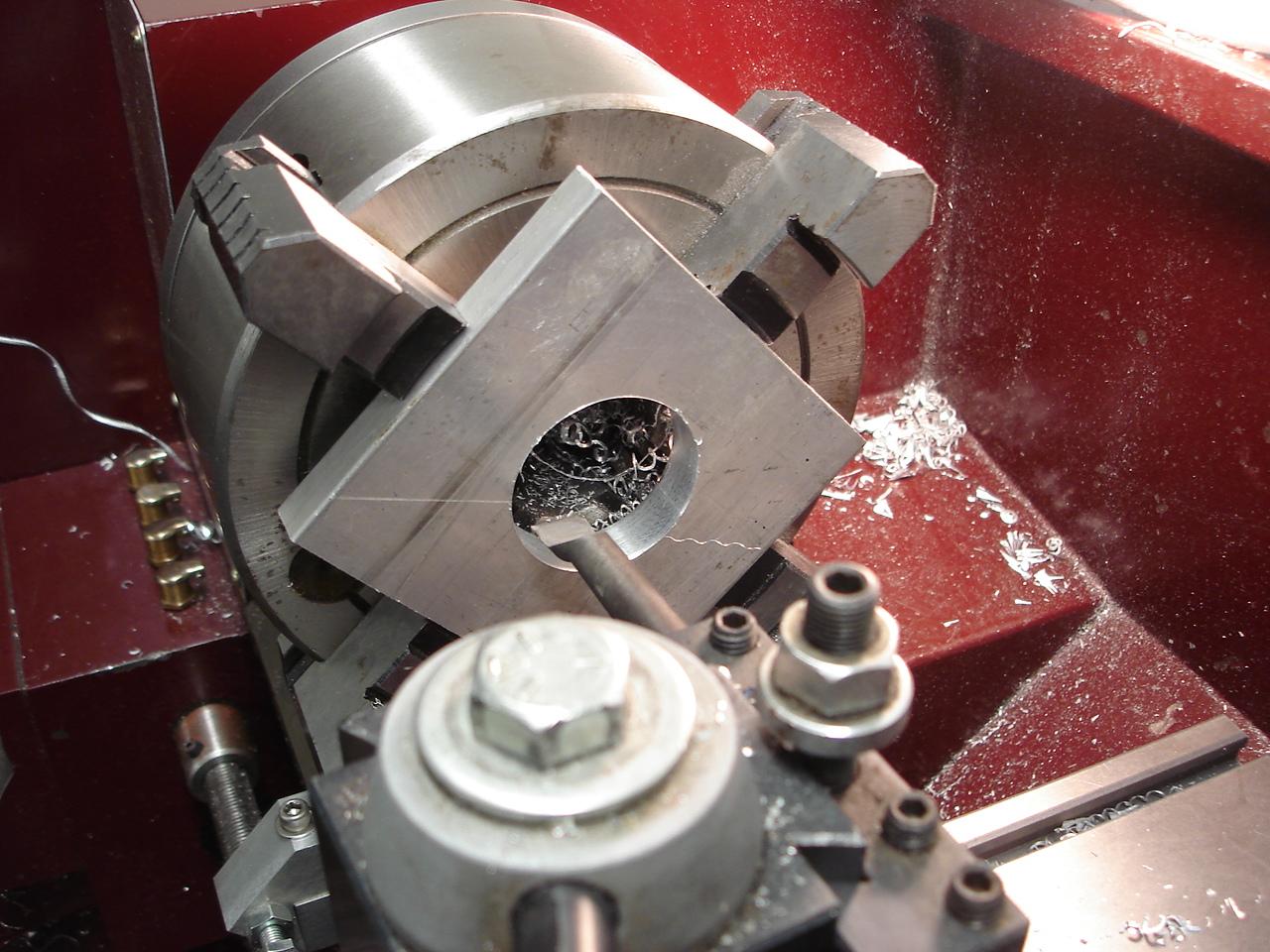

Right now my main issue is mounting the Top Hat parts and the adapter that I will have to make so they can be mounted to the back plate.  I really want to cut the full size parts out and see what they look like.
Dale P.

I understand what your saying about "I shouldn't have to do it on a new chuck" but I feel that machining is about making things work! Machining a backplate is just about making it fit.

The 1/2 sized part looks pretty good. I bet you are anxious to cut the full size part.
Can you get a refund from Grizzly? Or you can just post it for sale.
Perhaps you could machine up a spacer ring? Mount that on the nose and then the adapter?

I don't mind machining a back plate when mounting a new chuck, but I really shouldn't have to cut into a brand new Bison Chuck just to make it fit.  I already drilled holes into this back plate so I can't return it so I will just make up a spacer and keep it for a face plate for future projects.  I will see if I can find a deeper back plate to fit the new chuck when this project is done as I really want to keep the chuck stock at this time.
I spent a few hours in the shop and made up a spacer for the back plate.  I only had aluminum on hand but it should work just fine.  Hopefully I will be able to machine one of the full sized parts tomorrow night!
Here are some more pictures.
Dale P.

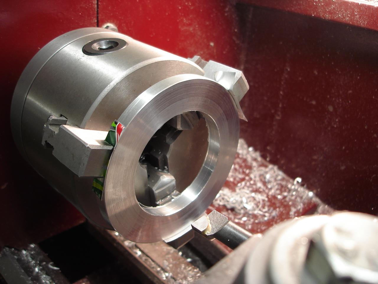

Eric,  I used your idea about putting the spacer between the nose of the lathe and back plate.  I originally was going to place the spacer between the face plate and part, but your idea was a lot better.
Thanks!

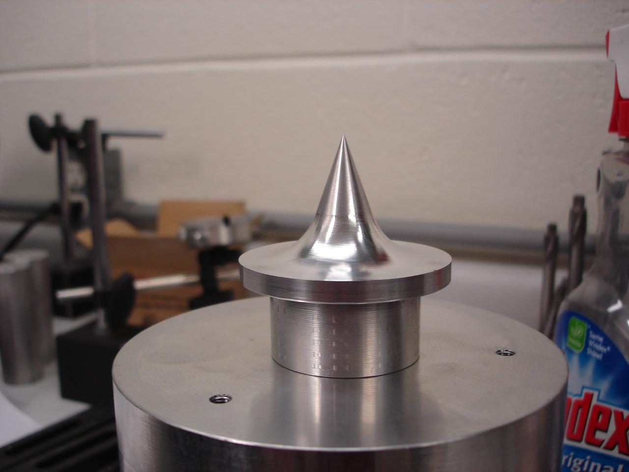

As you can see I had to switch around my chuck from regular jaws to reverse jaws a few times to make this part due to the small 4" chuck that I have which is why I'm changing both of my lathes to a 5" chuck.  Hopefully that will keep me from having to change out the jaws as much in the future.  I'm putting a Bison brand chuck on the CNC lathe, but just a china brand on the 9X20 as I hope to replace this lathe some day with something a little nicer.
Any one buy chucks from CDCO?  Do you think they are the same ones offered by companies such as Grizzly and Little Machine Shop.com?  I'm guessing they all come from the same factory in china.
