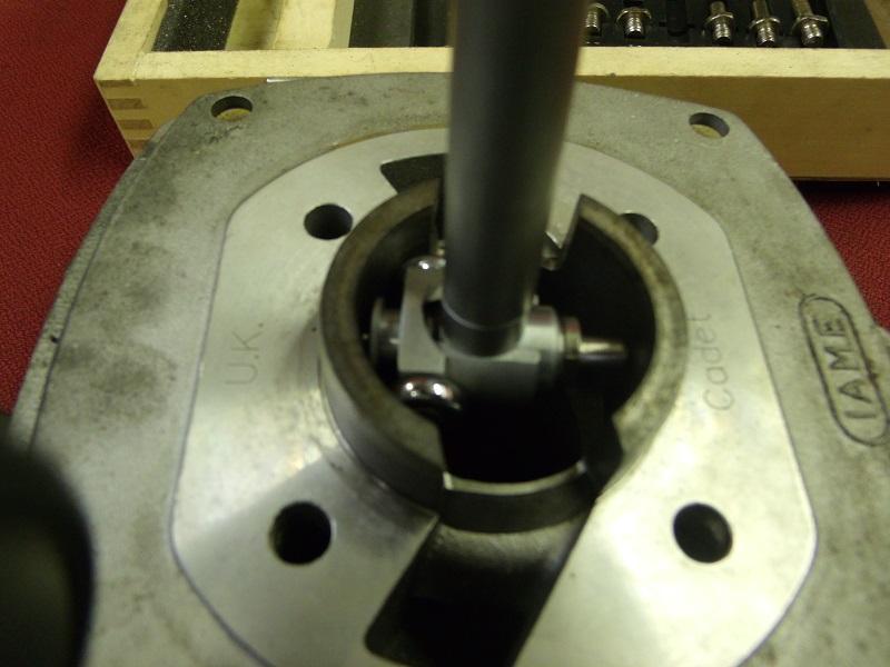

Offline redshift
  • Posts: 47
Re: Dial bore gauge Q
« Reply #5 on: October 08, 2013, 11:31:18 AM »
Pete, it's got three point contact plus the measuring plunger between two of the contacts, I'll put a picture up.
Regards
Offline redshift
  • Posts: 47
« Reply #6 on: October 08, 2013, 11:57:36 AM »
Pete, here you go
« Reply #7 on: October 08, 2013, 02:10:19 PM »
Cheers chaps, much appreciated.
Dave - does the one I linked to look like yours - i.e. 3 point contact? If not, I'm guessing a 3-point is easier/more reliable than a 2-point (or 1 point + measuring plunger)?
« Reply #8 on: October 08, 2013, 02:21:05 PM »
Ade, yes it's just like mine, should be perfect for your intended use. Plus you get real time readings as opposed to the ones you have been using.
