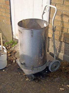

At long last I was ready to start building today I obtained an old vacuum cleaner from a scrap yard that was the right size and is on a wheeled trolley, plus the motor will do for the air supply.
The drum is stainless steel which should solve the rusting problem that I had with my old one.

I lined the bottom of the drum with 3" thick fire bricks which cut reasonably easily with a club hammer and a bolster. I knocked the corners of the bricks off with the bolster to enable me to fit seven bricks around the sides.

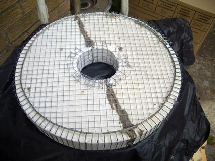

Today I worked on the lid, I cut the ceramic fibre board to shape on the bandsaw and wrapped it in wire mesh from a recycled bird cage and have started to plaster it with refractory cement.

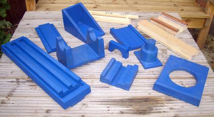

I've got all the patterns made for my next project, a milling machine. The largest will require approx. 11kg of aluminium, I need to start collecting scrap.

« Reply #13 on: September 25, 2013, 01:35:02 PM »
Norman, I had the same problem you do. It was very heavy for the existing vacuum cleaner wheels. The main problem was the location of the wheels. There wasn't enough clearance under the barrel for rolling well on grass, and the handle was located too far aft -- when leaned over enough to clear the wheels, a large proportion of the weight was on the hands. Also the handle was low, so you basically ended up stooped pulling a lot of weight and snagging on things.
Now, I think wheels can be a good idea, but it just has to be proportioned differently than it was as a vacuum cleaner. 3 or 4 wheels would work, for instance. Or even a moving truck would work with a furnace with no wheels, because the proportions are correct on the truck.
On mine, I finally opted for skids, and that has worked well for infrequent moves on grass.

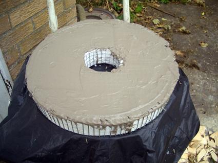

Further work on the lid, I made a band of steel to clamp around the lid that had lugs attached that gives a place to attach the lifting handle yet to be designed. I then plastered over the whole of the lid with refractory cement.
I ran a small fire in it last night and noticed that the smoke escaped around the edges of the lid more than through the hole. This morning I applied a layer of cement, covered it in cling film and then pressed a flat board onto it which has given me a nice flat surface. I have done the same with the lid, this should give me a good seal. When it is dry I will try another fire and I hope to see no leakage.
