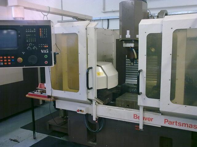

What started this train of thought was my Beaver Partsmaster. The RS232 socket for DNC is on the side of the console box housing the operator panel and monitor for the TNC355 control. However this console box is mounted on a long swinging arm so any cable has to go back to the pivot point then vertically up. However above the pivot there are no roof trusses to fix anything to for perhaps 12 foot making draping wires a right royal pain! Hence thinking wireless! At a push I could re-wire the Heidenhain RS232 port so it exits within the main electrical enclosure rather than the console which would at least get it nearish to a wall!

Dave, it was my bad explanation. I've added a picture a bit further up the thread to show the issue. Picture is of before I bought it so it's still at Bristol University.
