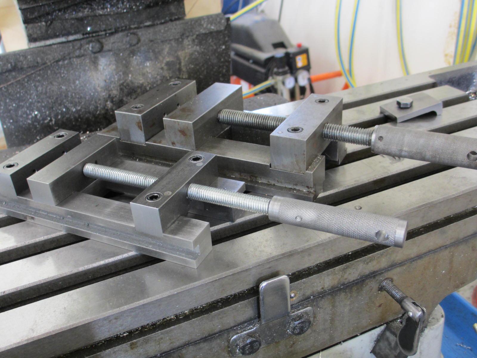

I have a collection of vices of various types but the ones I use most often are a couple of rail vices that I made myself.
They set up in seconds with a simple square and clock to less than 0.03mm across the width of the jaws consistently.
If I need more accuracy, I can tap them with a soft faced hammer or fit soft jaws in the holes I tapped in the jaws and then run the cutter over them.
Perhaps I should do a build thread on them and put up the drawings.

Re: Which vice?
« Reply #7 on: September 15, 2013, 02:02:42 AM »
Hmm, Build log and drawings, Yes please Jim. Yours look much like the small one that came with my lathe milling attachment (for my 7x12 clone before I got my X2 mill). I find this a tad on the small side in the mill and would like to make or get something more substancial for bigger jobs. I guess I could copy and scale up from my exisitng one BUT. If you already have drawings? :coffee: Plus I am sure others would benefit.
Thanks,
John B
Re: Which vice?
« Reply #8 on: September 15, 2013, 04:42:11 AM »
..... rail vices that I made myself.
Jim
Some details please. :clap:
1) How do you prevent jaw lift? I see that the jaw is pretty swallow to start with and the screw is relatively high. That does the trick?
2) Do you have bearing ball between moving jaw and the screw?
3) How did you machine slots on  top of rails and keys on the bottom (if any) of the rails parallel?

« Reply #10 on: September 18, 2013, 05:04:14 PM »
Ok, I have done it! I have posted my first thread.
Video and drawings for my milling vice are at: http://madmodder.net/index.php/topic,9057.0.html
Jim
