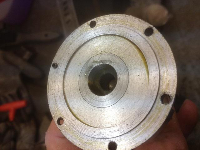

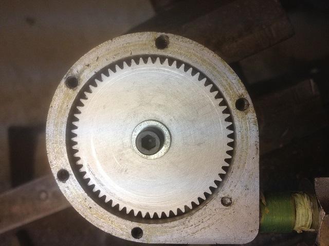

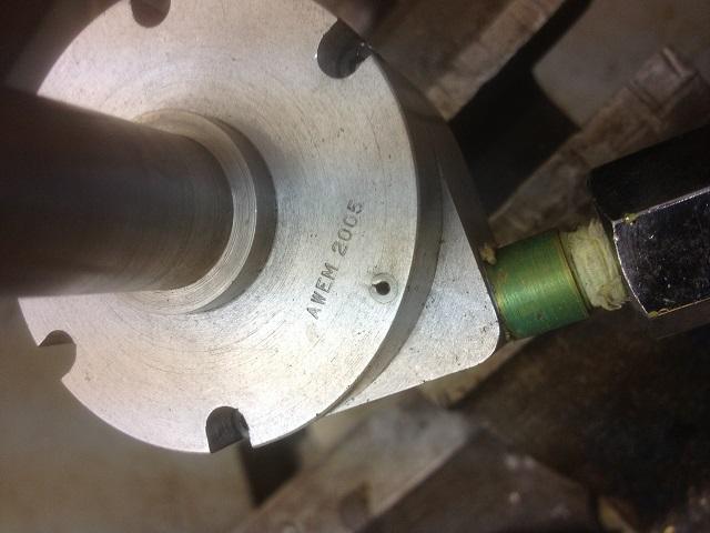

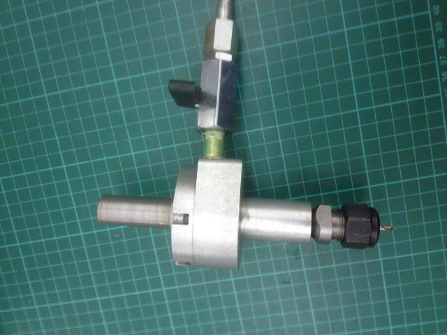

OK some pictures for your delight and delectation!
I cnc milled the shape of the body from the solid, and hobbed the gear in some aluminium alloy that was to hand (I seem to remember it started life as a timing belt pulley)
I bought an ER11 'extension spindle' and modified it for the spindle - don't ask me about the bearings as I cannot remember - it seems I made it in 2005 - they were just something I had to hand probably, but certainly not rated for the speed they are spinning
Just spun it up - yes it screams but not enough to stop the traffic. Took ages to slow down so I could put it back in the cupboard.

« Reply #6 on: August 23, 2013, 12:46:44 PM »
Gotta love simplicity.  Is the spindle held in place just by a press fit in the bearings, or is there some sort of thrust washer behind it?
Re: Air pressure spindle
« Reply #7 on: August 23, 2013, 01:18:49 PM »
I seem to remember that the spindle casing was bored out at each end for the bearings to press in with a collar between them. The spindle had a shoulder resting against the lower inner race, and there is a small collar between the upper inner race and the wheel, but that might all be conjecture !
