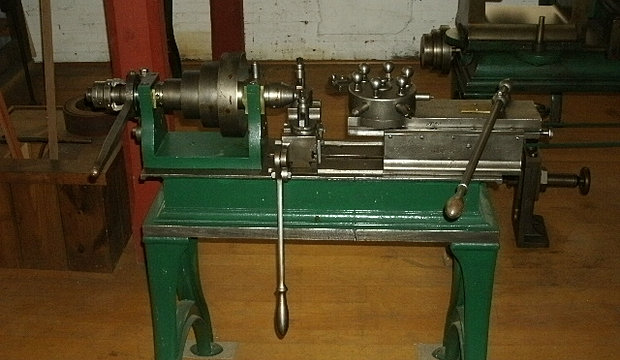

If that does not work plan b is to start toying with piece of crap capstan lathe I have. It has no tail stock, chuck is crap and lead screw is missing. It weights close to 1000 kg and has a gearbox plus about 4 hp 3 phase motor. Spindle speed goes up to 2400 rpm. I.E. it is perfect base for lathe/vertical drilling machine. But plenty of work for few holes....

Plan B: to build a separate tail stock from scratch to allow 300 mm of feed. I have a TR16*4 mm acme rod + nut + geared 24 VDC servomotor, but no electronics.
maybe something like this:
http://www.practicalmachinist.com/vb/attachments/f26/77378d1369344103-schaublin-capstan-handle-tailstock-20130302_110946.jpg
Or like in capstan lathe - like capstan lathe ram. It all looks pretty doable. some serious work thoug. Something like this:
