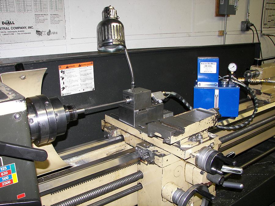

I purchased some carbide 'v' with a through coolant hole from EBay.  I bought some 'v' tubing from Drill Masters.
I hard soldered a gun drill the length I needed, 18 inches.  Ground it to size on the lathe and the T&C G.
Hooked everything up and that is where I stopped.  I have a few details to finish.  I have not made a test hole as of yet, other things got in the way.  One thing I am having trouble with is to keep the solder out of the coolant hole.  I purchased some anti-flux and have been doing some reading.
The material I am drilling is 4140.  I am going to purchase some stress proof before I continue so I can see which is better.  I believe the stress proof will be.
The long, curly swarf is to be avoided.  It will jamb and destroy the gun drill.  The higher the rpm, the slower the feed rate, the smaller the chip, the more success.
Long term project.

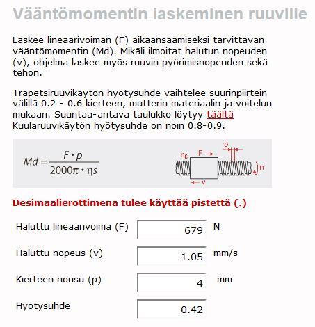

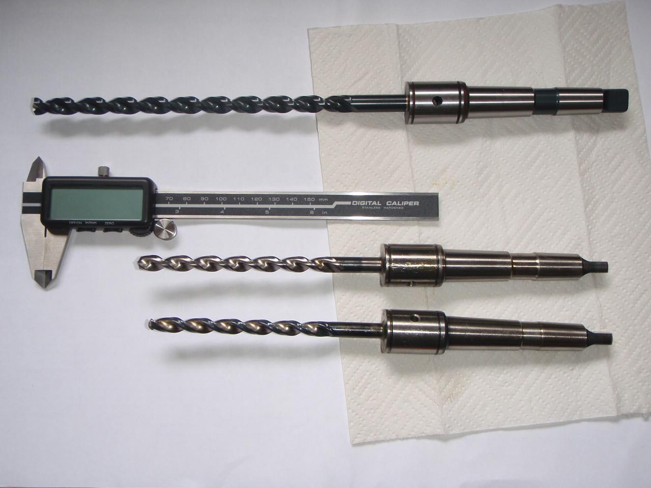

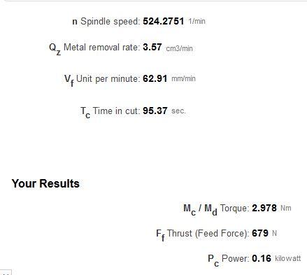

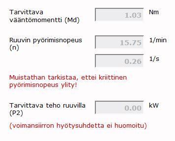

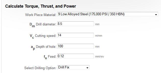

Not sure if this ever going to be much use of anybody or I get anywhere, but I lets see.
I bought three long spiral drills stubby ones are 8,5 and 9 mm diameter and just over 100 mm long. The long one is 10 mm diameter and business lenght is 185 mm. Local toolshop was selling them out, these were smallest ones they had.
Exact drill types are (if anybody is interested):
STOCK 71553 DIN 341 V70-IK Ø8,5 x 250/100 mm
STOCK 71553 DIN 341 V70-IK Ø9,0 x 257/107 mm
STOCK 71567 DIN 1870 V63-IK Ø10,0 x 335/185 mm
All are MT2 taper shank with side coolant feed. They are trough cooled. Just close enough to work with tempered steel, but not much room for error.
The side coolant feed is cylindrical ground surface, very close to 24 mm OD and 30 mm length. Should not be very hard to make coolant mount (inducer?) to it.
Bit more lost with coolant pump requirements. I see sealed collets advertized for cylindrical shank and up to 1000 psi (about 60 bars) that probably gives some indication of max required pressure.
I wonder if those drill operated transfer pumps could be used to test or do I need to source a car motor oil pump or small gear pump (hydraulic pump) for it.
There is some more work to do, so don't expect any results tomorrow (or next week:).
On this picture I'm gloating my spending on local tool shop. They had some guide dog calibers for sale and they said that they really don't suck really that much. I like that kind of sales talk.

I have to work on three fronts:
1) Coolant inducer. This I think is easy one. Lot like that:
http://www.carbideanddiamondtooling.com/thumbnail.asp?file=assets/images/yg1usa/spadedrills/spade_drill_rci.jpg&maxx=750&maxy=0
2) MT2 taper holder. I do have a MT2 taper holder for the cross slide. I am not 100% sure it will be able to hold drilling forces and bit unclear how to put drill bit absolutely straight without test bar. Maybe between spotted pilot hole on the bar under drilling and MT2 holder end on tail stock?
* I can gear down correct machine feed on cross slide no problem.
* Probably really should build a separate tool holder for drills.
Plan B: to build a separate tail stock from scratch to allow 300 mm of feed. I have a TR16*4 mm acme rod + nut + geared 24 VDC servomotor, but no electronics.
maybe something like this:
http://www.practicalmachinist.com/vb/attachments/f26/77378d1369344103-schaublin-capstan-handle-tailstock-20130302_110946.jpg
Or like in capstan lathe - like capstan lathe ram. It all looks pretty doable. some serious work thoug. Something like this:
http://static.wixstatic.com/media/999e2a_e754617990544f3acc20dda4e9e08855.jpg_srz_620_360_85_22_0.50_1.20_0.00_jpg_srz
3) High pressure coolant pump. I probably need 20-40 bar pressure and low flow. Just have figure out what kind of madmodder pump I am looking for? Oil transfer pump? Car engine oil pump, small hydraulic pump?
Ideas?

You have a whole lot bigger hurdle ahead. Gun drilling needs a whole lot more on coolant pressure and is more critical on feed. Haven't tried that but talked some years back on machinist that did some oil holes and such.

I have been playing on drill power calculators and it looks like 8,5 mm drill needs about 200-300w of pure power to punch trough alloyed steel bar on table feeds and speed. Needs something like 4 Nm of torque and 700N of feed force.
Those still needs factoring with mechanical and electrical efficiencies before we are talking about motor speeds and powers.
http://www.kennametal.com/en/resources/calculators/holemaking-calculators/torque-thrust-power.html
8,5 mm dia drill, feed 0,12 mm/r and cutting speed 14 m/min as table values from manufacturer for tough steels.
Screenshots from source values, some results here as text:
n Spindle speed: 524.2751 1/min
Qz Metal removal rate: 3.57 cm3/min
Vf Unit per minute: 62.91 mm/min
Tc Time in cut: 95.37 sec.
Your Results
Mc / Md Torque: 2.978 Nm
Ff Thrust (Feed Force): 679 N
Pc Power: 0.16 kilowatt

Is there a English language calculator for mechanical drive? I used one Finnish one, but like to verify it and show results here.
Excuse my French Finnish:
http://www.mekanex.se/ber/fi-vridmom_skruvdrift.shtml#
Does it transalates?
https://translate.google.fi/translate?hl=fi&sl=fi&tl=en&u=http%3A%2F%2Fwww.mekanex.se%2Fber%2Ffi-vridmom_skruvdrift.shtml%23
Badly. Anyways this calculates rotary power, torque and rpm (for a mechanical drive) that is needed to produce a linear force with ballscrew or acme screw.
I'm using values above
Ff Thrust (Feed Force for drilling): 679 N
Vf Unit per minute: 62.91 mm/min -> 1,05 mm/s! This is the drill spindle/chuck linear speed from spindle rpm and feed
TR16*4 (OD 16 mm acme screw with 4 mm lead) would result about 0,42 efficiency when lubricated.
So, it looks like those values will result in fairly modest feed motor requirements : About 1 Nm of torque at 16 rpm. To me it looks like:
* Pretty hefty stepper motor if directly coupled. Rapids would be pretty impressive.
* But even small stepper would produce that if geared down.
* Any small geared AC/DC servo would produce it and provide good rapids.
* I have small geared 24 VDC motor that nominally produces 18 rpm. I could use it it check this.
How does it sounds? Did I got mechanical drive close enough so far?
