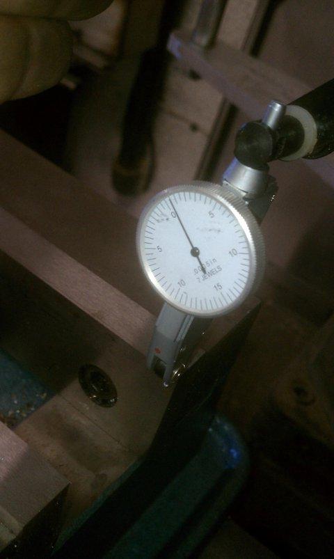

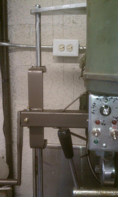

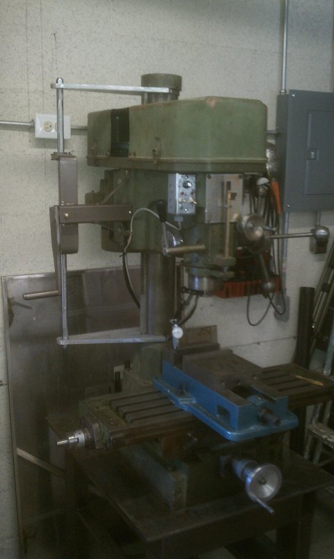

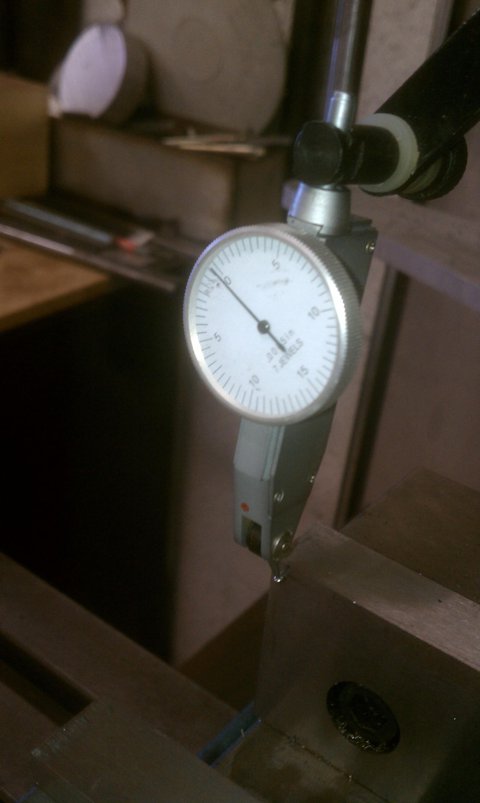

Beware of the round column ones. If you need to crank the head up when changing tools to give you more daylight you lose alignment  which can be a real pain
Don't ignore the round column mills because of the alignment issues.  I aligned mine a year ago, crank it up/down about every other week & alignment stays the same.  It has more play in the table than "twisting" of the head.
I will admit I did make a minor modification, which keeps it aligned.

Re: Mill drill help
« Reply #16 on: August 31, 2013, 09:44:14 PM »
Clever idea Mark but could you size those pictures down a bit please? They are more than double my screen res.
Re: Mill drill help
« Reply #17 on: August 31, 2013, 10:03:13 PM »
(I've resized photos above)
Markball2, thanks for the mill drill mod photos -- that's helpful if I do something similar on mine. Coincidentally we both have Enco mill drills and Craftsman 12" lathes. I do see one difference in my mill -- the pulley cover opens on the opposite side -- it looks like you cut your cover away to clear the upper arm of your guide support post. Did you alter the cover support hinges to get it to open on that side or was it like that when you bought it?
Offline markball2
  • Posts: 13
Re: Mill drill help
« Reply #18 on: November 16, 2013, 03:07:05 PM »
No.  The cover doesn't hinge, it removes by unlatching some clasps & lifting off.
Yes I did have to notch the belt cover.  I was running it without the cover, but the top/front of the cover is a nice place to put my hand when I'm using the mill.  I kinda like my fingers right where they are  :bugeye:
