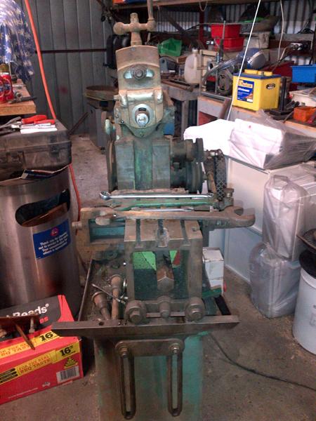

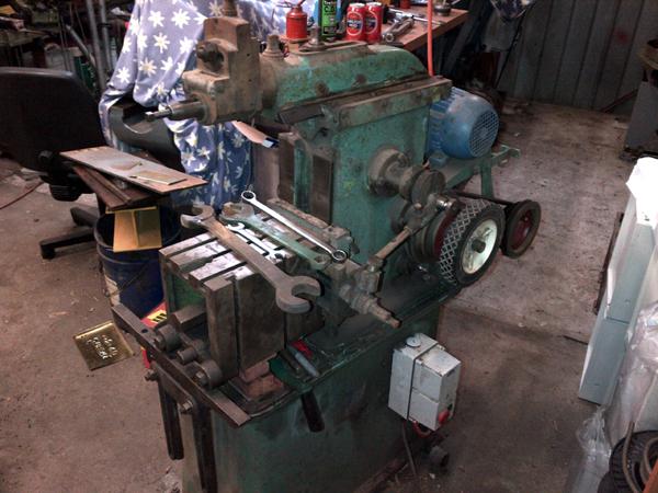

Last week I saw an ad for a Douglas shaper for sale in Albany, some 430km (267mi) South of me. So I did a little reading about them and sent several questions to the seller and decided to drive down and take a look yesterday. Ten hours and fifteen minutes later, I had it back home Big Grin

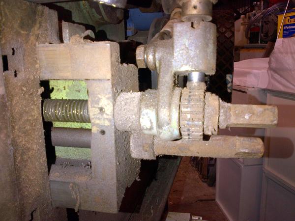

I had sat in the corner of this guys shop unused for several years, so there was no plug on it and it was covered in dust. It had been used exclusively for cutting keyways in pulleys. Whilst he had never used the auto feed, he was confident that it worked. Turning the drive pulley cycled the ram and the ratchet clicked forward but didn't seem to disengage and actual pulled the ratchet back - effectively rocking the table.

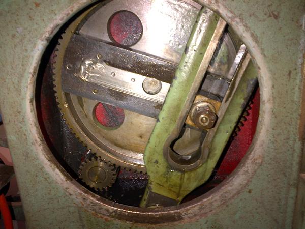

After getting it home, I unloaded it, put on a plug, oiled the ways and hit the green button. The ram actually travels faster than I expected and really hits hard on the return stroke. The motor is a new one, so it may actually be too fast. Alternatively, I may have screwed something up when I removed the ram to clean the old oil from the ways. What are the possible causes for the ram hammering home?
The ratchet mechanism and the gear it drives is covered in years of dust and I will give it a good clean and hopefully see what is happening. In reality, I need to do some reading and looking at YouTube to learn how to adjust and use one properly.

« Reply #2 on: August 08, 2013, 10:05:42 AM »
Sort out any backlash on the cross feed screw/nut and I'll bet that the ratchet will work fine. Mine was just the same until I took up the play.

« Reply #4 on: August 09, 2013, 09:04:22 PM »
Thanks Steve.  I have a copy of How to Run a Metal Working Shaper - South Bend (1966) but that wasn't all that helpful in terms of troubleshooting.  I managed to find a copy of Shapers - Stieri (1942) which has a lot more info in it.
Thanks awemawson, your advice fixed the problem.  As soon as I read your reply it made perfect sense.
Thanks unc1esteve.  What I meant was that on the return stroke there was a loud thump at the end of the stroke and the force was enough to actually push the shaper back.  Reducing the stroke adjustment solved this.  I have since tried different stroke lengths and it seems to be fine.

I have a 7 " atlas  I'm starting to get to know, one thing to watch is if the cutter travels to far past the work as it hits on the return stroke it bounces with more force coming down marking your workpiece somewhere in the middle making you scratch your head.  :scratch:

You will have less problems and a better finish
if you use a lower RPM.
