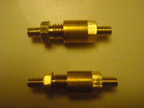

Hi,

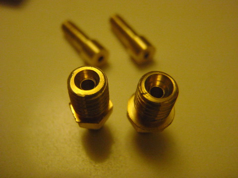

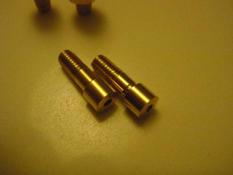

I am making some inline water/steam pipe coupler fittings with a threaded collar and union to create the seal. I have bored out the female cone using a standard center drill to counter sink the cone shape. I now need to cut the male cone onto the matching piece.
My plan is to set the compound on the lathe at the same angle as the center drill to cut the matching cone with a normal cutting tool. Can anyone tell me what angle center drills counter sink at so I can correctly set the compound.
Alternatively is there another way to machine matching cones for this purpose and what is the best angle to machine the cones for best seal.
Cheers Mick
