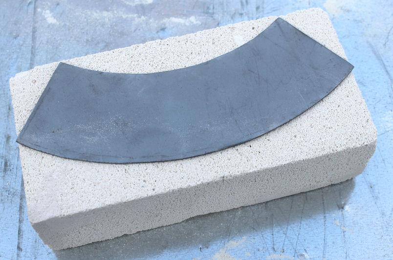

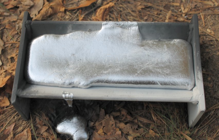

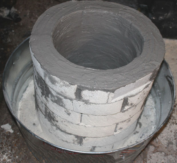

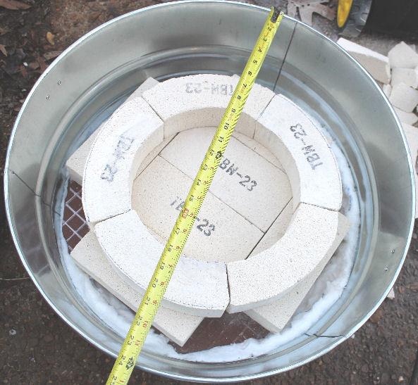

Here is a furnace and crucible I built to melt aluminum.
Aluminum is pretty easy to melt and pour, just don't breathe the fumes, and wear some good personal protection including face protection, and boots perhaps.
I used the soft fire bricks from Budget Castings, but you can also use the hard bricks.  The good thing about the soft bricks is that it is easy to cut holes in them with a hole saw or any other type of saw. for the burner, etc.  Don't breathe the brick dust.
If I had to do over, I would just stand the bricks on end, and put them in a circle, perhaps cutting the sides to fit together, and using a little furnace cement.
I have even melted aluminum by just stacking fire bricks in a circle temporarily.

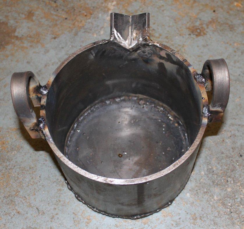

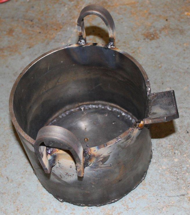

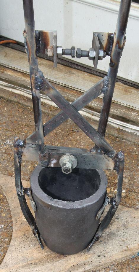

The crucible is welded together from heavy steel.
Some have mentioned that a steel crucible will contaminate the aluminum, but I have not seen any signs of that, and a heavy-wall steel crucible is very tough and long-lasting.

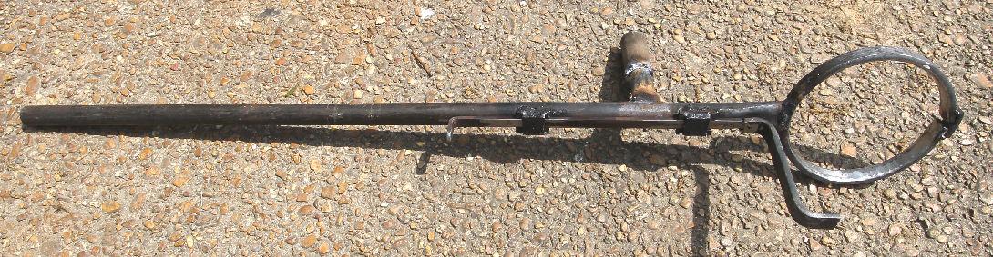

The pouring shank needs to positively lock into the crucible so that you can tilt the crucible beyond horizontal without any danger of the crucible falling out of the pouring shank.
I will look for a pouring shank photo (the one I use).

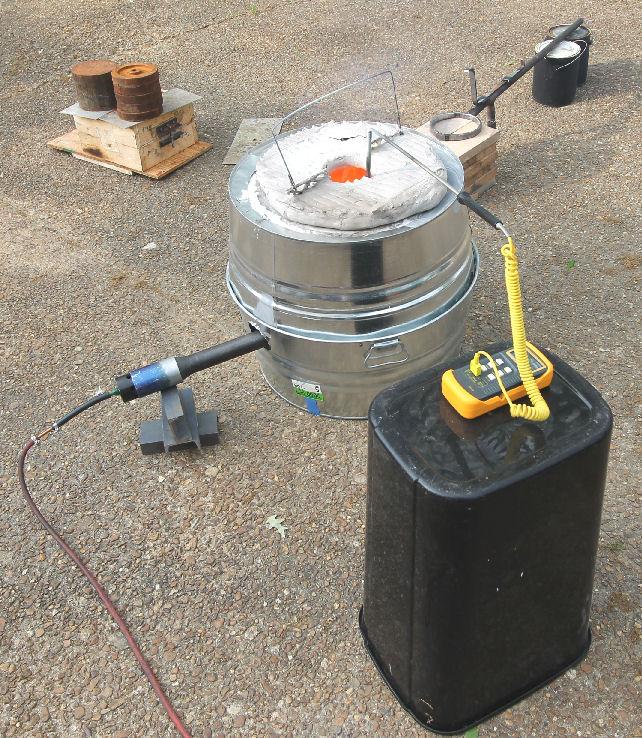

I use propane to melt aluminum.

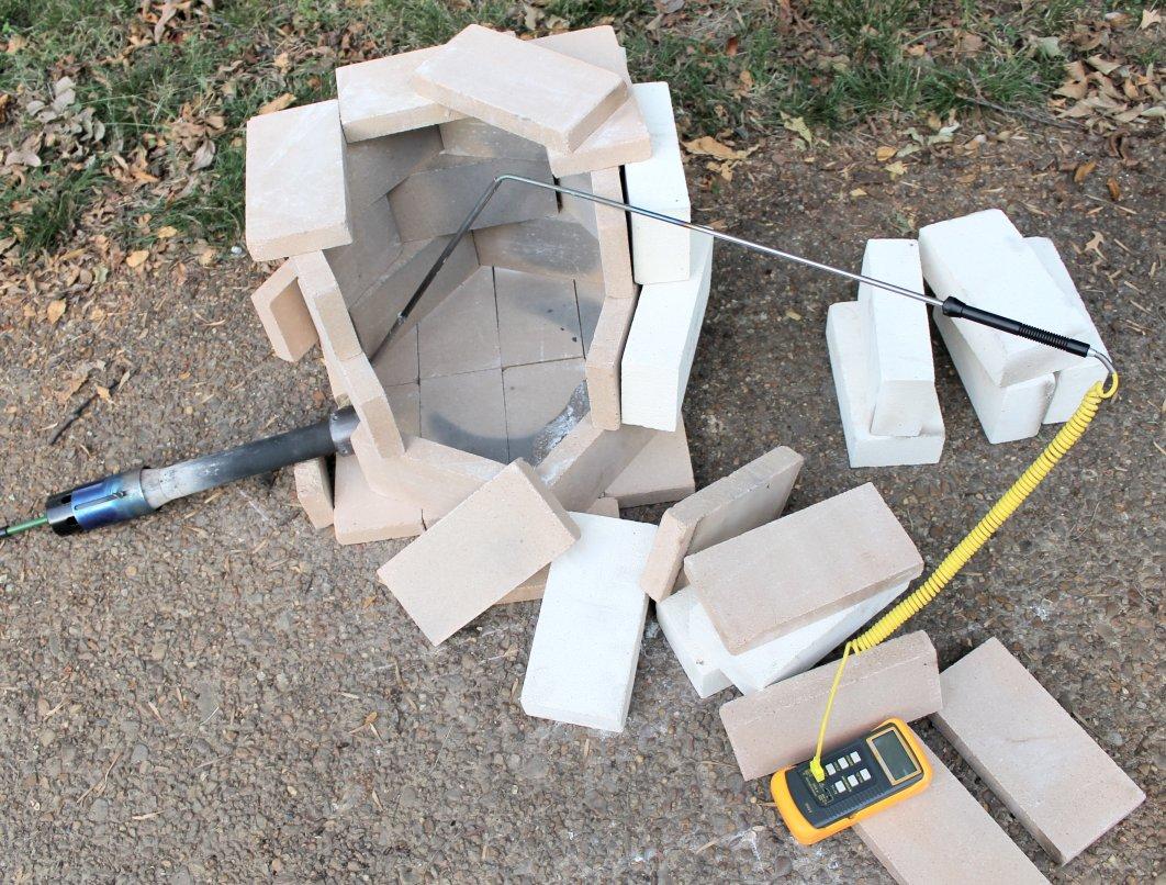

I made a coated ceramic blanket top for this furnace, and I am not too pleased with it, and will make another one out of soft fire brick.
The furnace below is my temporary furnace from stacked fire brick.

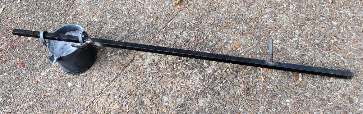

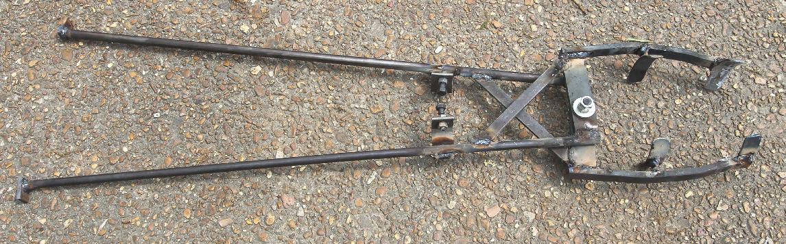

You can also see the pouring shank I use.
Lifting tongs are just two rods with hooks on the end.
Notice the "L" shaped retainer on the pouring shank.
I also added a short piece of vertical round rod on the end of the "L" bracket to keep the crucible from sliding off the end of the shank.
And I added a 6" handle about 8" out from the crucible, pointing straight down, which I grip with my right hand.

And here is the final furnace.

If I were only going to melt aluminum, I would use a steel crucible only.
I wanted to do some bronze work, so I bought a clay-graphite crucible, and made some lifting tongs and a pouring shank.
I need to rework the retainer on the pouring shank, it does not work correctly.

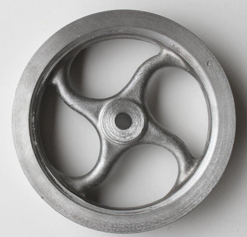

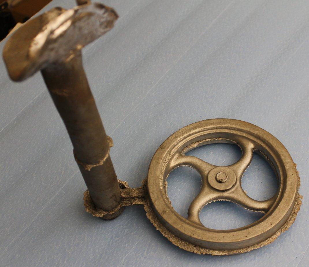

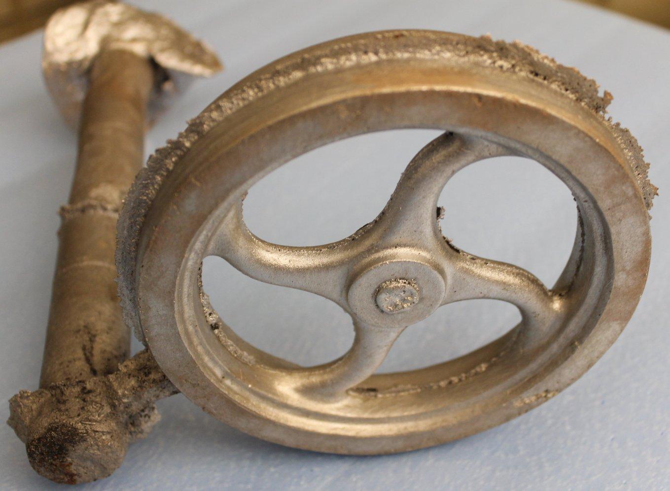

A flywheel I poured in aluminum 356.

I use petrobond sand, which is an oil-based sand.
If I were going to make a limited number of parts, I would try some water-based sand from Budget Castings, and use good venting in your molds.
To use petrobond effectively, you really need some type of muller, or some way to get good mulling action.
Petrobond will dry out, and addtional oil and sometimes alchohol must be mulled into it.
I am not entirely pleased with the maintenance that petrobond required, but have not tried water based sand yet.
If you use water-based sand, don't get it too wet or the water inside the mold will flash and eject molten metal back out of the mold like a volcano.
Be safe above all else and do your homework if you intend to cast metal.
So far I have not had to use any additives to the aluminum I use.  I just melt it, skim and pour as quickly as possible to minimize disolved gasses getting in the mix.

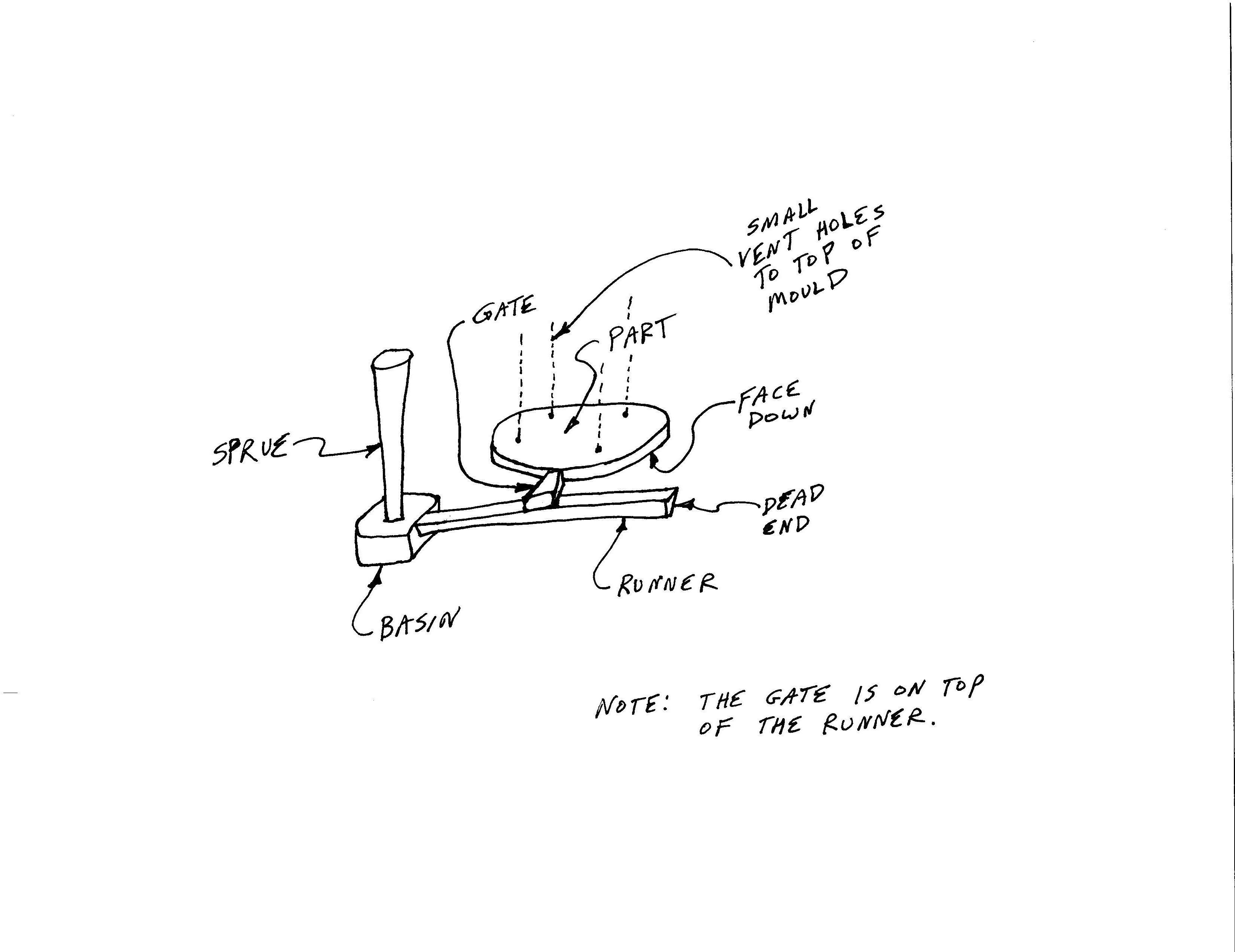

I use a diffeent sprue/basin/runner/gate arrangement now, shown below.
Offline NeoTech
  • Posts: 826
    • Roughedge Hobbyworks
Re: Building a Furnace to Melt Aluminum
« Reply #7 on: August 04, 2013, 12:59:44 PM »
Why the dead end runner??  *curious*
MetalCaster
« Reply #8 on: August 04, 2013, 01:18:28 PM »
Any lose particles of sand, dirt, etc. anywhere in the system will get swept directly into the mold cavity, unless you have a trap, in which case the initial wave front of molten meltal will sweep out the spure/basin/runner system and trap all the particles in the trap.
I always blow out the mold lightly with compressed air, but you generally always disturb a slight amount of sand when you assemble the cope and drag, and no sense having sand inclusions in your part.
Offline NeoTech
  • Posts: 826
« Reply #9 on: August 04, 2013, 02:12:50 PM »
Smart, never seen anyone do that before though. =)

If you use a small amount of Borox, the same Twenty Mule Team stuff, it will make the brass flow nicer and more of the trash to rise. Nice looking casting.
