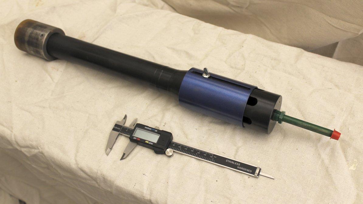

My propane burner is of the jet burner type with a small nossle for the gas flow.. This works great when its cold.. When it has run for a while and it got "distbured" a wind gust came and well blow on it.. What happened the damn thing starts pulsing or dieseling.. anyway sounds alot..  And.. the temperature is dropping alot.. from 730-740C to around 650-680C..
So the first batch i did. no problem at all, the aluminium melted well and it got hot enough to poor without problem.. The second run i did.. well slag formed alot more, unmelted parts needed to be stirred out in the melt.. And the third run was the same.. The two last runs had the annoying pulse jet sound.. It dont go away unless i choke out all the air intake and it just becomes a big sooty flame.. Even if i lower or raise the gas flow it wont stop.. it just sounds more or less..
This is a tad bit annoying.. and confusing.. Any suggestions of corrections on the burner?  Is it not enough airflow that causes it when it gets hot? The only air intake it has is through the burner tube.. I have fitted a piece of steel to the burner tube so it centers in the inlet tube on the furnace.. its quite - snug.. i wonder if it would be a problem or not? I recon the air should come in through the burner not around/outside of it.

Hi NeoTech,
                     Have you any pics, or drawings of your burner, this would make it much easier to diagnose the problem.
                           Cheers David

How big a propane tank are you using? Is it getting very cold?
Or alternatively, is the nozzle getting too hot?
It's a time dependent problem, so those are two things that change over time.

And this is the design of the burner. - it just a 0.8 mig tip on a slab of steel fitted to a 21/32 fitting so i can use the handle, and a tube is snuggly presed onto it.. The tube itself has a centering ring on the air intake of the furnace and a steel tube as a choke. (nothing fancy)

My propane burner is similar, and it can be a bit finicky some times.
On a windy day, I put something on either side of it to block the wind.
My burner is very sensitive to the choke setting.
Occasionally, and for some unknown reason, it starts the pulse-jet thing, which is combustion occuring inside the burner tube (not where you want it to happen).
I have to turn off the burner, pull it from the furnace, and relight it.
The pulse-jet is bad since it will overheat the burner tube and can cause problems.

Propane burners are notorious for cooling off the propane tank, with a resultant drop in vapor pressure.
And when that happens, the burner gets too lean, and yep, you can certainly start the pulse thing with a lean burn.
You may have to watch the pressure, and adjust the choke as the pressure drops off a bit.

You are not letting the end of your burner protrude into the hot part of the furnace are you?
I keep the end of the flair back slightly into the refractory of the side of the furnace so it runs cooler.
And I pull the burner from the furnace if it is not lit, otherwise it tends to overheat from residual furnace heat.

A nearly empty 13 pound propane tank is probably the problem. A small barbecue tank in the states is about twice that size.
The last of your propane in that small tank chilled very rapidly.

So the pulsejet problem is still an issue even with a filled tank.. After closer inspection firing it in my basement without any winds..  the pulsing can occur when the choke is open to wide.
With the full tank its reeeally easy to make the flame go out by opening up the valve to much. and the choke makes it pulse when opened to much.. the dangerous part is that the ignition occurs in the tube, like 1-2cm from the mig tip.. you can see the blue ball form and getting pushed forward.. so most of the ignited heat is taken up by the burner tube..
Should i start over?!? Make a new tube with smaller intake.. maybe only 1 14mm slot and make that slot like half the length??

To avoid 'burn back' your gas  speed at the jet has to equal the flame speed. If it is slower and you get a burn back it is potentially quite dangerous. In oxy-acetylene burners it could be lethal, but as you only have a fuel gas and no oxygen other than that from the atmosphere, it is somewhat less likely to demolish your house  :ddb:

yeah the burn back seems to occur when i let to much air into the tube.. but if i dont it doesnt form a proper blue jet in the end of the burner tube and the heat tend to dissipate into the burner tube body instead..
Dont know if i should try a bigger or a smaller nossle.. i have 0.8 tip on it now.

How big is your furnace I'm asking because the pic of your burner sitting on your lid looks like it is about 2.5 / 3" vent hole.
I think you have a backpressure problem,  As you said the burner is a snug fit so the only air getting in is through it so if the lid vent is too small the pressure I think will slow the air flow basicaly making the furnace/burner gasp for air or pulse.  Have you tryed slipping the lid to the side a bit?  I wouldn't  take this for gospel but others can put in their 2 cents or tupence for the other pond people. A furnace with a blower has the air forced into it so the lid hole isn't as critical thats the way I see it at least.

yeah,. the lid hole is about 70mm, so i guess 3" is correct. The lid itself dont sit "flat" onto the furnace so there is openings around it where some eascaping is done.
But i agree i wonder if i should try to conjour 3 attempts.. one is a bigger nossle for the burner effectivl slowing the gas down and the air pull. Second is a burner tube with a lot less venting, instead of 4 slots about 50mm long and 14mm wide i should try with just one slot thats half the length for starters. And finally testing with a airpressure connector hooked up to my compressor maybe. I thought this was more for the oil burner types though.. But as you suggest the natural aspiration could be severly lacking.
Today its pouring though.. *effin weather*  So i will just make parts. ;)
