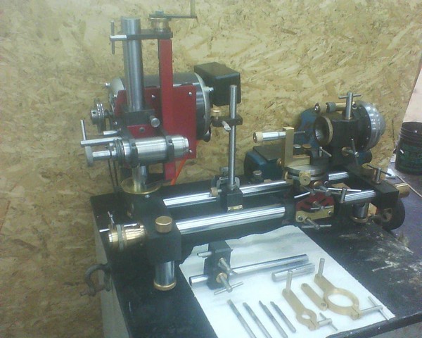

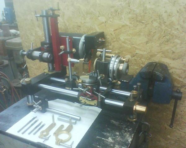

I completed the Bonelle T&CG.  I posted pictures of it on the Quorn owners site.
Hi Steve , any chance you could post a  link to that site so we can have a look at your Bonelle  :thumbup:
Offline unc1esteve
  • Posts: 126
Re: A0 Bonelle TCG - Metric drawings
« Reply #10 on: August 02, 2013, 03:36:18 PM »
Rob,
Here is the link, http://groups.yahoo.com/group/quorn_owners/
It is in the photo section under Bonelle by Steve McKuhen.
You may have to join the site to view pictures.
Edit, There ae 105 pictures of the build.
« Last Edit: September 24, 2013, 12:04:59 AM by dsquire »
Offline unc1esteve
  • Posts: 126
« Reply #11 on: August 02, 2013, 03:39:39 PM »
I just figured out how to post pictures.
Now I need to figure out how to re-size them

Offline puretexan
  • Posts: 19
« Reply #14 on: August 02, 2013, 09:55:54 PM »
I found the best way is in your Photobucket...click edit...then resize. I did 600
on the first number and it chose the second automatically. Then click change
the original. It will give you a size viewable here and not too big. Like this.
« Last Edit: August 03, 2013, 02:24:48 AM by puretexan »
« Reply #15 on: August 03, 2013, 03:41:20 AM »
 :clap: :clap: :clap: :clap: Now that looks a very well made TCG Steve  :bow: :bow:
Thanks for the photos and the link  :thumbup:  , now you have mastered posting photos I hope we will get to see more of your work  :poke: ,,,,,,,,,did you mention EDM in one post ?    :)

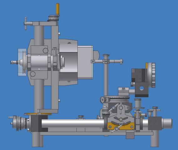

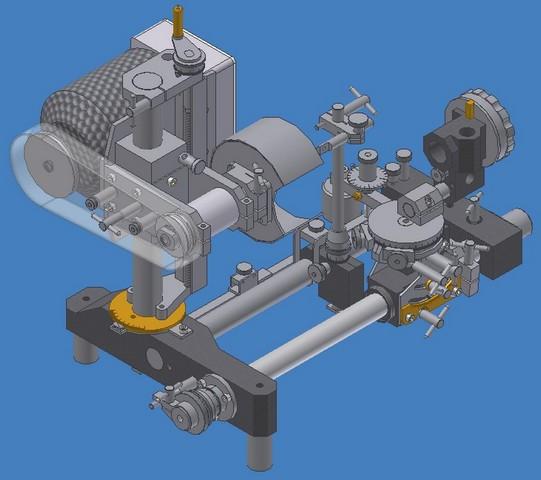

Just another project to finish for me.
I have the raw material roughed and just waiting for some TLC from me.
Drawn from metric plans about 5 years ago now.
« Last Edit: September 24, 2013, 12:06:46 AM by dsquire »
« Reply #19 on: September 23, 2013, 02:39:13 PM »
Ausdier, interesting design it has some changes. Care to elaborate reasoning and choices. Just curious. :coffee:
Thank you,
Offline ausdier
  • Posts: 35
« Reply #20 on: September 23, 2013, 11:24:35 PM »
G'day Pekka,
What changes are you talking about ?
Cheers.
« Reply #22 on: September 24, 2013, 06:34:36 AM »
G'day Pekka,
Cheers.
Hi Ausdier,
Sorry I was tired and I tought that there were differences on workhead assy to bar part, and mike dial looked different off-hand, but now when I'm bit more rested I can't put my finger on anything. It just "looked" different than I expected....I admit I'm here on thin ice. I have Quorn-book, but never got casting, neither made one....just too versatile and complicated to my predicted use.
Is it essentially same Bonelle than on OP's link?

Offline ausdier
  • Posts: 35
« Reply #24 on: September 24, 2013, 10:51:01 AM »
Outstanding idea Borriss.
All good Pekka.
I too have the Quorn book ( paper and electronic ) but no castings and hope one day to build both but at this stage just don't have the room.
When I come to do the Quorn I will be doing my own castings.
Also there may be some slight differances as I converted my Bonnelle from the imperial plans and added some of my own little features.
I also have drawn the Bonnelle in imperial as per the plans with no mods.
