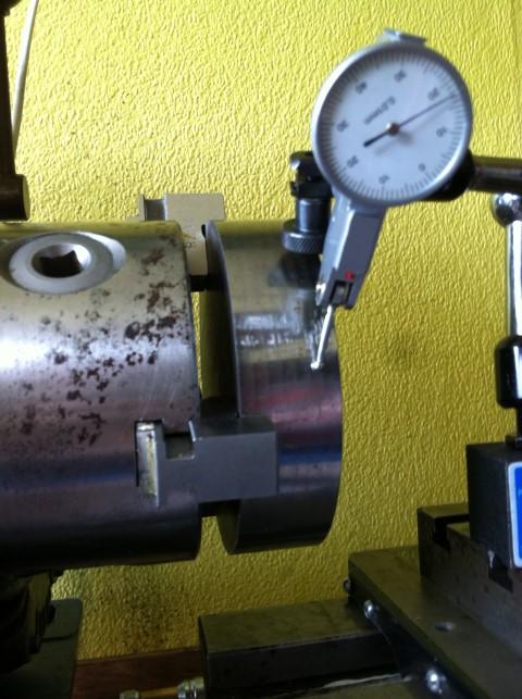

Hi Guys.
Been away doing other things for a while.
My Myford ML7 has been givin me a bit of general gip lately.
It had a good clean over the weekend in readiness for my next Engine project.
I just chucked a 4" Steel slab in the 3 Jaw. Fired it up and I could see it wasn't anywhere near central in the chuck.
Dial gague tells me .15 mm out - A country mile......
The big Jaws had never been used when I got the lathe and this is the 2nd time I have used em.
Suggestions welcome.

Turning it in the jaws produces a very similar result, as does end over end.
The steel is square and sitting flat on the Jaws.
Spindle Outside has zero runout. certainly less than .01mm
Chuck backplate has .02mm run out but the chuck has .01mm.
If the Jaws are incorrectly inserted then it's mm out, not 0.15 mm.
Jaws checked 1 - 1, 2 - 2 , 3 -3 and scroll in in the correct order.
The chuck is Myford, No idea on date or how much abuse it's suffered in the past.
I Stripped and cleaned it a year ago, it was seriously full of C**P and the factory lube was somewhat not....
I do know it was certainly within .05mm after that.

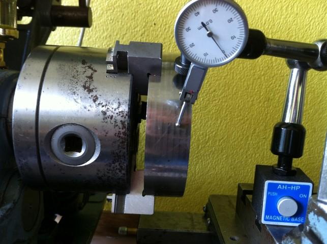

4 Jaw came out and got dusted off.
The steel was round. Clocked it to within .02 mm, More than good enough.
Both sides faced really nicely. Center is spotted as well.
That'll do tonight. Now I need make it into a flywheel.....

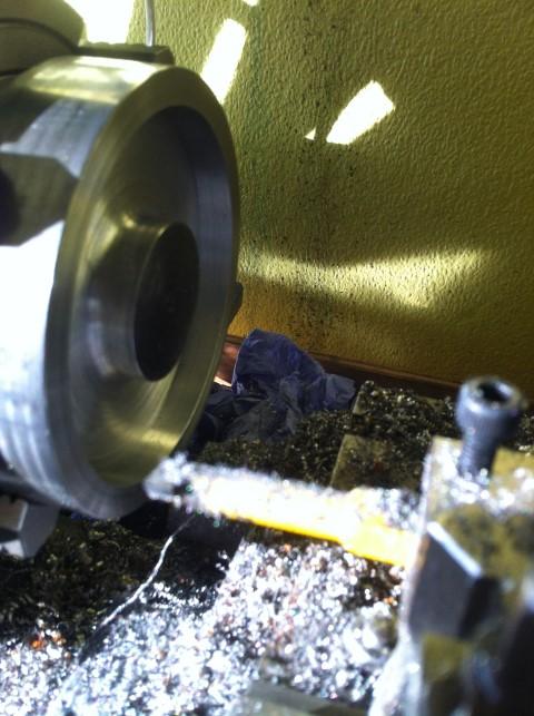

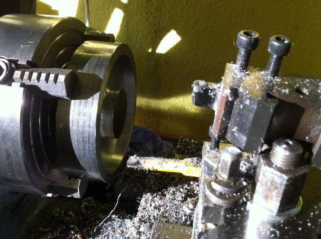

OK - Flywheel blank all Chucked up in the 4 jaw.
I'm using a 4mm dia Shaping tool to hollow out the middle to a depth of around 9mm.
As I started to work to the outside the bottom of the lathe tool starts catching on the work.
Brain in over ride mode thinks Angle the tool. Nope !
So I decide to have a square corner on the outside and put a std tool in. Nope !
I guess I need a Boring tool / Bar / Doofah thing yes ?
Re: Myford ML7: Chuck Runout.
« Reply #17 on: July 24, 2013, 03:09:34 PM »
Not exactly sure what you mean by hollowing out the center of a flywheel -- could mean several different things  -- but it does sound like you are doing a boring operation -- meaning enlarging a bore of some sort outwards, and you are getting interference from the bottom corner of the tool.
Depending on what you're doing, you may not need a boring bar, and even if you did you'd need adequate clearance at the bottom of the tool.
Just grind enough clearance. Also a smaller square tool will help.
One other thing.....the cutting edge should be set slightly above dead center.

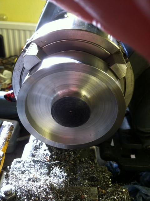

In the bottom of the tobacco tin I found a Boring tool :)
Thankyou for the tip on running above centre for this job. Worked much betterer....
Side 1 is done well enough until I get some real dimensions.
1st pic shows the tools I'm using to hollow this all out.
The others are what I have done.
