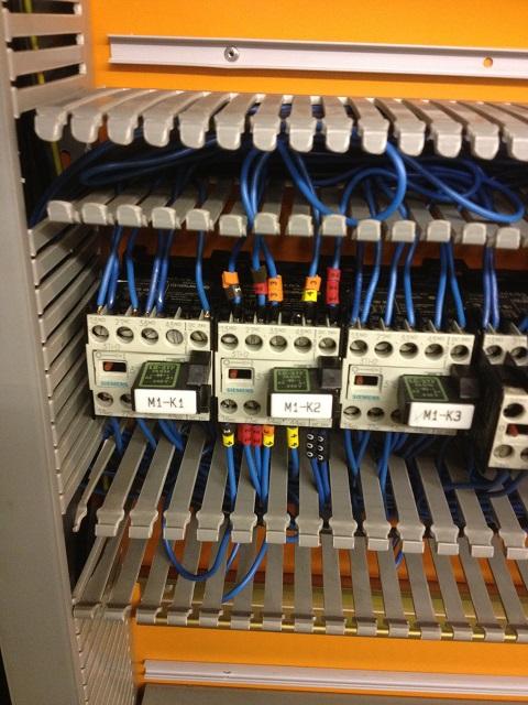

I've recently had to label a load of wires and cables, and for most things the coloured numbering sleeves that slip over the wires are fine:
Re: Labeling Wires and Cables
« Reply #1 on: July 22, 2013, 06:54:48 AM »

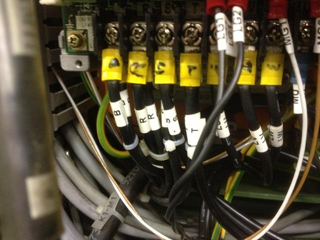

However sometimes just numbers isn't enough - here we have the connections to a three phase AC servo amplfier:
« Reply #2 on: July 22, 2013, 06:56:24 AM »

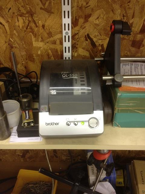

These labels are produced on my trusty Brother QL-550 printer, and are self adhesives, so can be rolled arround the wires

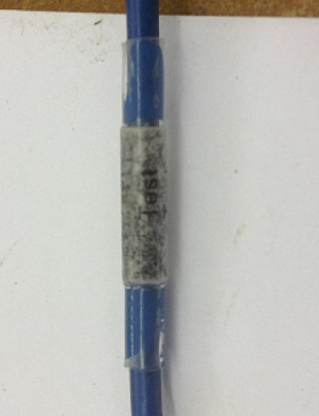

Only problem is that the label tries to revert to being flat - so it gradually unrolls, and in warm places can fall off!
I thought that the obvious solution was to slip a clear heat shrink sleeve over the label and shrink it in place:
« Reply #4 on: July 22, 2013, 07:01:58 AM »
 :bang: Only problem is that you end up with an illegible label   :bang:
Why: well thinking about it it is obvious - the label printer is using thermal paper, and the heat of the shrinking is converting the rest of the label to black.

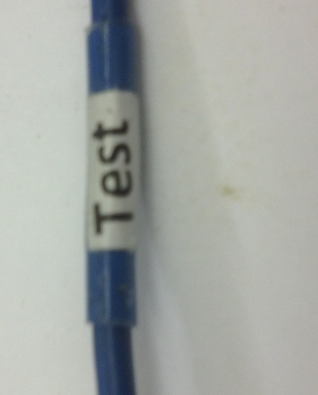

So, try printing out on a laser printer, cutting out the text with a scalpel, and shrinking :
« Reply #5 on: July 22, 2013, 07:04:13 AM »
Well it works, and produces a good legible label that won't come off, but it's ever so fiddly to do  :scratch:

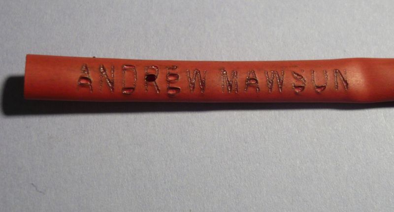

Wondered how the laser would handle shrink tubing ?
Expected it to just shrink it but it's that fast it didn't.
Having said that it's not that neat but worth a try.

Nice one John!
I wonder if the tubing will tear when shrunk round a wire due to the laser etching?
