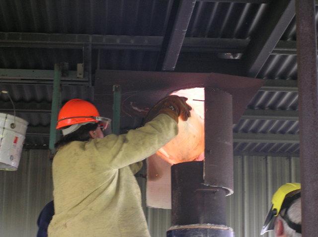

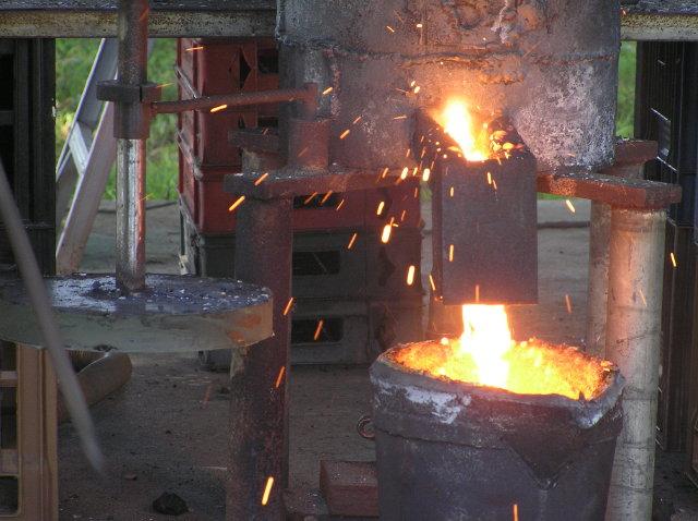

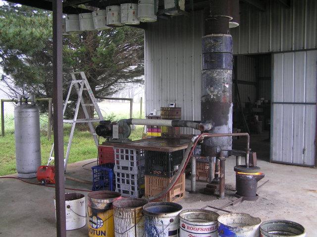

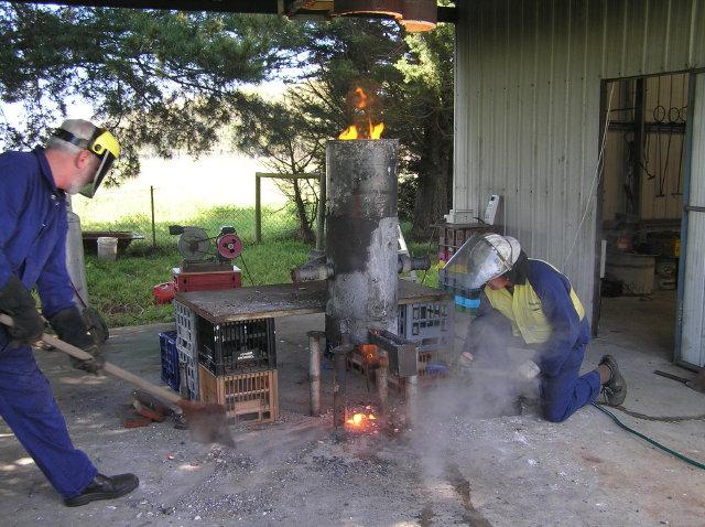

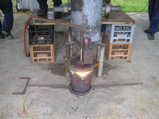

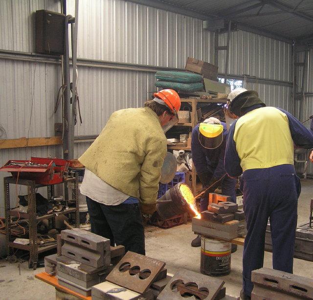

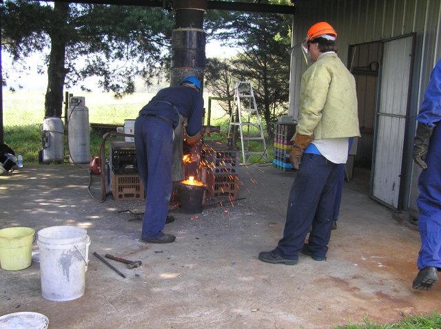

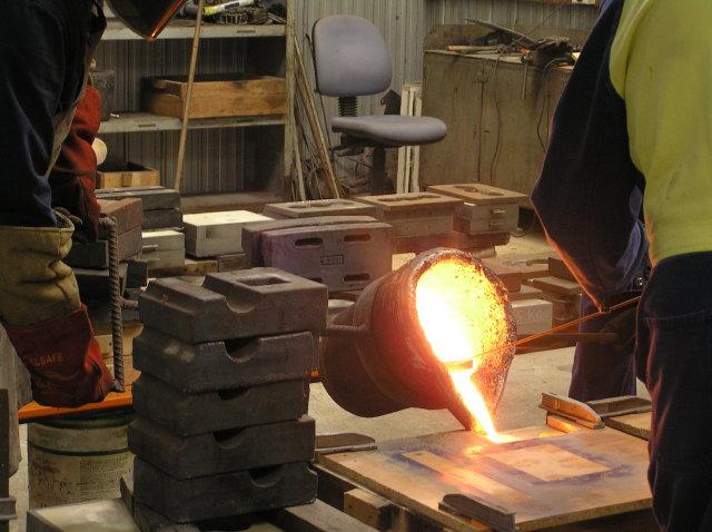

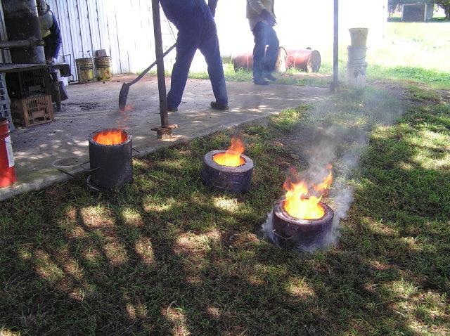

Thank you for posting your cupola photos I thought you might be interested in my photos of it running.
Re: 9" cupola
« Reply #1 on: May 28, 2013, 08:52:00 PM »
Wow, very interesting stuff, ironman!!  :clap:
It looks like you are preheating your ladle with oil from your pressurized re-purposed propane tank, or is that really propane?
And the extensions are really interesting. I had thought that if my little single charge cupola didn't work out, that maybe I could just add an extension -- and here you've already done that kind of thing.   :bow:
I know you're probably busy, but if you ever do get a chance I would really like to see a video of how you make your cores with Portland cement. I just mean a simple cylindrical core. I had real difficulty trying to keep a Portland cement core intact while removing from the core box.  Maybe you just let it cure in the core box?
Anyway, back to your cupola.......fantastic! That's a lot of iron.
I was hoping to manage up to a ten pound pour, myself!

« Reply #3 on: May 30, 2013, 12:20:51 AM »
The ladle preheater uses propane.
With your portland cement cores rap them a little and then let them set before removing the core.
I will make a video about that in the near future.
I thought Browne's Dairy didn't want them any more.
