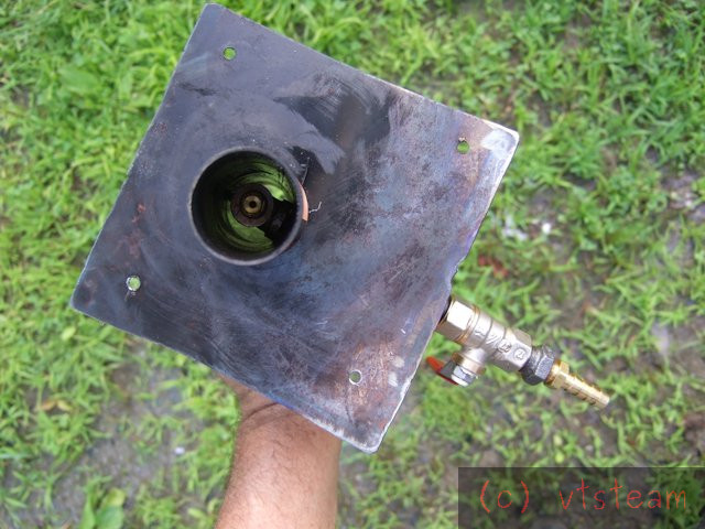

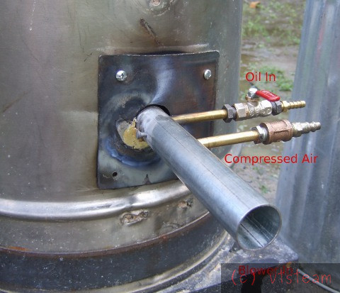

3 inches of rain overnight. Yuck. Rained off and on today. But I managed to quickly set up the new oil burner for a couple tests.
Here's the burner end on. You can see the orifice. Behind it is a mig tip jet that supplies compressed air at 30 psi:

Here it is quickly set up very temporarily to test. Rainwater everywhere!
Performance with kerosene (paraffin) was pretty impressive. With waste oil, inadequate. Mixed, the burner ran okay, but I wasn't happy with the heat output for melting iron using any proportion of waste oil. Feed rate definitely slowed with viscosity. I'm not sure what the exact problem is, because videos of the Kwiky burner do better on oil than mine did. Will have to figure that out.

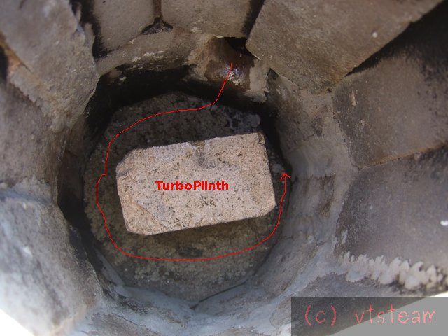

Secrets of the TurboPlinth revealed:
In short........it's a brick.

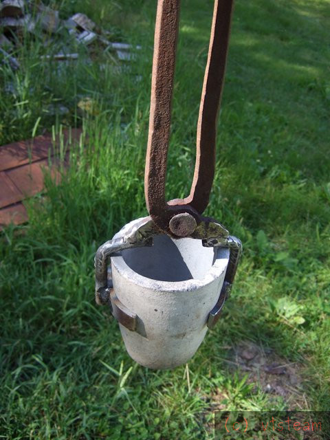

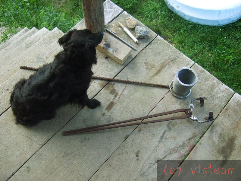

Other things accomplished today (due to sunshine):
Crucible tongs made from blacksmith tongs plus rebar plus sections of 4" pipe scrap.
« Last Edit: January 07, 2018, 10:14:28 AM by vtsteam »

....and a pouring shank.
« Last Edit: January 07, 2018, 10:15:53 AM by vtsteam »

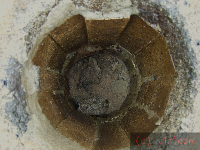

Back to the interesting stuff for you guys. The lining was in perfect shape after the melt. It just had a very thin brown glaze on it, which I might even count as an improvement. Here's a pic -- the broken up stuff on the bottom is fused sand -- I broke it up when it was an orange sticky taffy mass, as I didn't want it glued to the furnace brick. I also freed the "TurboPlinth" since it served so valiantly. It is also intact, though slightly glazed now.
I made no changes to the Kwiky burner, other than the countersinking I mentioned earlier. I ran it at partial throttle all the way through because with my full volume of the vacuum cleaner blower any more throttle would have created smoke in the exhaust. I look forward to completing a dedicated (and quieter) blower.

Also that a brick may be used to deflect a burner flame so that it acts as a tangential swirl burner, and can double as a plinth. No need to make a diagonal hole through a furnace barrel -- particularly a firebrick lined one.

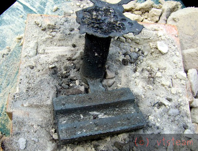

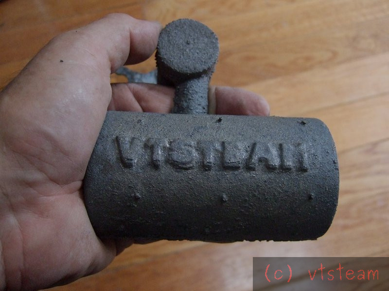

This will be a new upper valve case for my rotary valve 4 cycle to steam engine conversion.
« Last Edit: January 07, 2018, 10:22:55 AM by vtsteam »

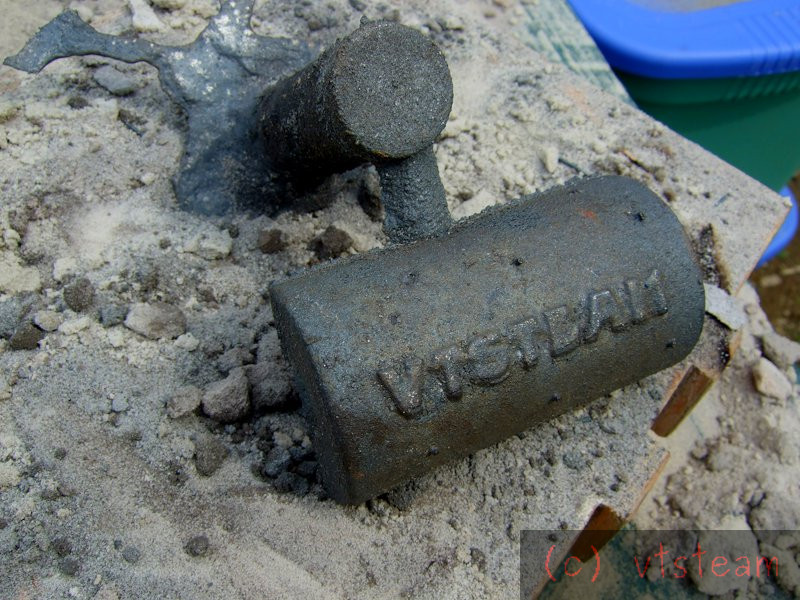

Backside when first broken out -- you can see the channel from the greensand core -- also how very close I was to running out of metal in this pour! The sprue was full when poured, and did shrink down on cooling -- but I don't want to cut it that close again!
Total metal loaded in the crucible was 5 pounds. Total weight of casting and sprue was 4 pounds 3 ounces. I don't know where the other 13 oz. went as I didn't scrape a lot of slag, just a reasonable amount. Maybe I mis-measured?
Also -- just checked the iron with a file -- it files "like buttah". Nice grey iron.
« Last Edit: January 07, 2018, 10:23:39 AM by vtsteam »

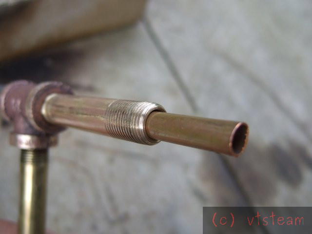

I decided that I wanted to extend the orifice away from the oil inlet tee almost all the way into the furnace so that the spray pattern does not hit the walls of the housing.
The problem with extending with 1/8"pipe is that the tee gives lots of clearance for the oil, but the 1/8" pipe does not -- it is a fairly close fit to the 1/4" copper tube airline which runs inside, concentric with the oil flow.
Here's a pic of the air line inside the oil line:

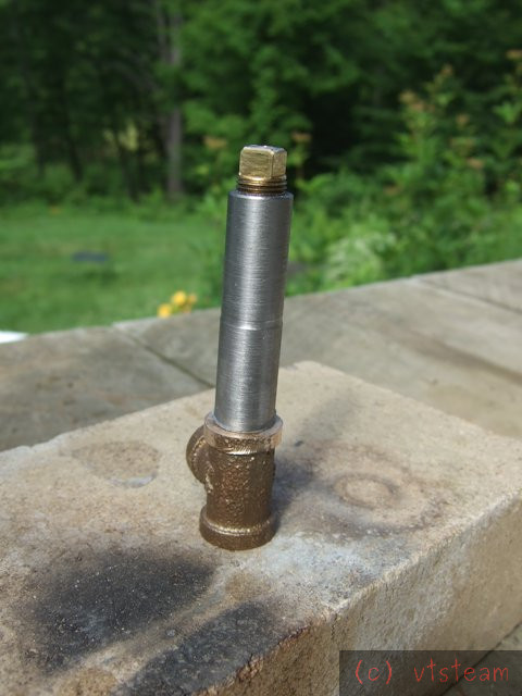

« Reply #174 on: July 02, 2013, 08:17:08 PM »
So the only way to extend the nozzle into the furnce would be to increase the oil feed pipe size from 1/8" to 1/4" ID.
The problem with that was that the pipe fittings would be that much larger and would block more airflow through the outer blower pipe.
I decided to see if I could eliminate any 1/4" pipe fittings but still use a 1/4" iron pipe. The first thing was to check to see if I could internally thread a 1/4" iron pipe to take the 1/8" pipe plug that is used as an oil nozzle in the original Kwiky.  I suspected this could be done but had never tried to internally thread one pipe size to fit another. If it wasn't possible, I decided I'd make a press in plug for the pipe, and drill and tap that to fit the nozzle plug.
Internal threads would eliminate the need for an air inhibiting 1/4" pipe coupler (and 1/4" plug nozzle).
I also decided to silver braze the 1/4" pipe to the existing 1/8" oil tee. This would eliminate a 1/4" to 1/8" reducer.
Here is a picture of the setup for brazing these two.
Oh, it also turned out that, yes, the 1/4" iron pipe could be successfully threaded internally to take the pipe plug nozzle -- shown here on top:
