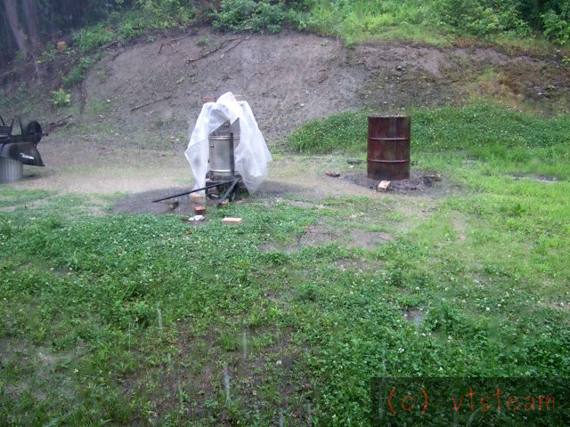

The sun came out and it got hot and muggy, so I started the charcoal burn. When it was just done, and I'd covered everything with sand, the clouds rolled in and we got inundated with rain.   :bang: :bang: :bang:
The furnace area flooded, as did the charcoal barrel. I hope it didn't wash the sand down from the lid into the fresh charcoal below.  Looks like it did from here....:(
This is the wettest summer I have ever seen.

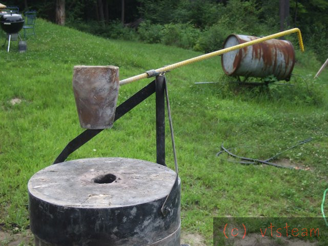

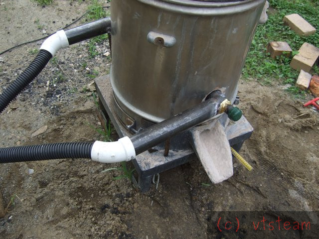

Rained this morning, but cleared by afternoon and was able to work while ground dried. Today's cupola work:
Added view ports to both tuyeres...
« Last Edit: January 07, 2018, 10:46:08 AM by vtsteam »
  • Posts: 6941
Re: Sawed off cupola
« Reply #205 on: July 11, 2013, 05:51:50 PM »

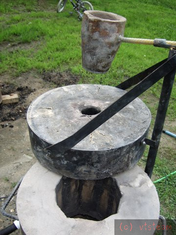

Added a support fixture to the lift rod for pre-heating the ladle:
« Last Edit: January 07, 2018, 10:46:54 AM by vtsteam »
  • Posts: 6941
« Reply #206 on: July 11, 2013, 05:54:16 PM »

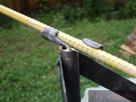

It's just a scrap pipe nipple quickly carved into a sort of spiral with the hand grinder. Not a thing of beauty, but it works well.
« Last Edit: January 07, 2018, 10:47:47 AM by vtsteam »
  • Posts: 6941
« Reply #207 on: July 11, 2013, 05:58:59 PM »
It grips the rebar shank. Stays put even when I rotate the lid of the cupola as seen here, yet is easily removed with a twist and lift motion.
Today I also made up the sand bottom of the cupola. Everything is looking ready except maybe a formal means of moderating blast. Weather tomorrow is predicted at 30% chance of rain mainly after 5 PM, so I may have a go at cupola casting with with charcoal, second time around.
« Last Edit: January 07, 2018, 10:48:25 AM by vtsteam »

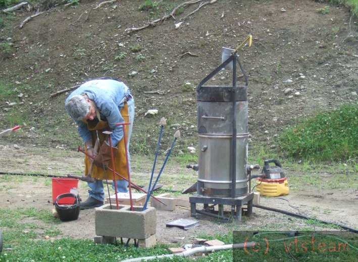

Tried the cupola on charcoal today. Even with the extension the charcoal burned down very quickly. A few minutes and it was down 18 inches. Melting was more thorough than last time but not good enough. The melt froze in the well -- never went completely fluid. I did have one small stream of metal start out the tap hole before freezing . \
Here I'm getting ready to chip out the blockage. I never did get to bod it off. The bod rods are at the ready in the cinderblock in this picture, and the ladle is heating on top of the cupola. The flame had been impressive out the top, but by the time this picture was taken it had died down as the cupola had burned most of its fuel.
I did try a second charge after refilling with charcoal, but had no better results. In the end I dropped the bottom and chiseled the slag off the barrel.
« Last Edit: January 07, 2018, 10:52:05 AM by vtsteam »

When the cupola cooled off enough to remove the extension, I pulled the tuyeres off, plugged up the far one with bod mix on the inside, remade the bottom, installed the new oil burner, and the plinth. Brought up the compressor, the oil and kerosene, and tried an oil burn. Figured I might as well try to fill the mold I'd made while the main furnace body was still hot.
But, no luck there, either. The new burner had an air leak in a silver solder joint, so wouldn't draw the fuel. Just bubbled in the container.
So I took the burner apart cleaned it and re-brazed it. Took two tries to finally get rid of the leak. Tried it again, and it seemed to work, but wasn't drawing fuel as well as the first one had. Not sure why -- maybe there is a blockage in  the jet. There was definitely enough draw for kero, but waste oil draw was weak.
I probably could have melted with kerosene, but it was getting late and general discouragement was taking over. Decided to just put everything away and call it a day. :(

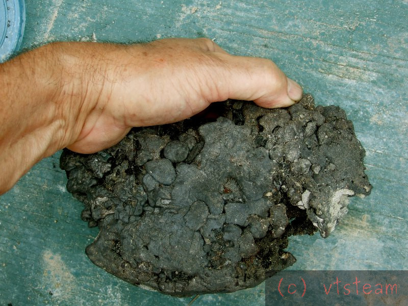

Andrew, in answer to your question yes I did keep adding charcoal, -- I went though all of the charcoal I had --  but only after I realized it had evaporated so fast. And even later added a second metal charge (which didn't help anything). I went through 14 gallons of charcoal. The furnace had been preheated with wood for an hour with blast on, and charcoal, as well as a heat soak period with metal.
Just as observations which may help others on this particular path, I do believe that the iron layer tended to choke up the exhaust and force it out the tap hole. The tap hole was left open to look for the first iron, per most cupola books. But it hardly showed up. I do believed the open tap robbed some heat from the upper cupola and kept it low -- near the tuyeres -- but probably there just wasn't enough heat altogether for the quantity of metal. If there'd been an excess, fire would have come out of every nook and cranny! Well maybe the lid contributed to this upper restriction problem. The lid also tends to stop you from adding -- you can't see what's going on inside, and don't want to cut the blast to check, while melting. So maybe the lid was part of the problem, too.
I should some day try it with the lid off, and try melting a 3 pound charge. But don't have the motivation right now. Not saying it would work, but might be useful to just see what the difference was.
I'm going to work on the oil fired side of iron melting in this furnace. I really want to do some casting and think less about the furnace construction itself. Thank you all again.   :beer:
(Shot of one fused chunk of cast iron found in the drop -- shaped roughly like the well. About 5 pounds.)
