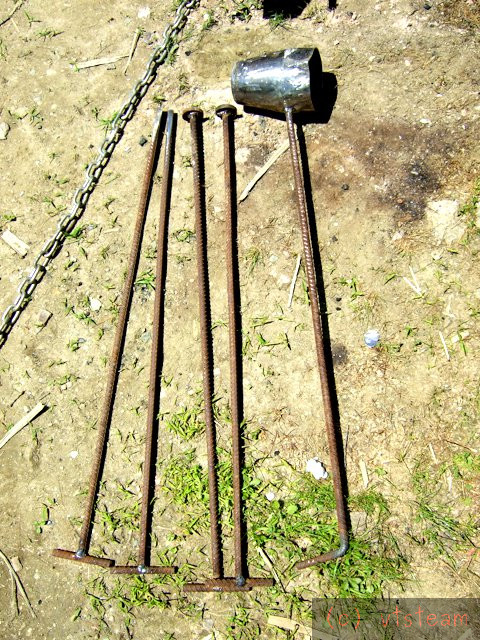

« Reply #128 on: June 21, 2013, 02:18:40 PM »
« Last Edit: January 06, 2018, 02:16:35 PM by vtsteam »

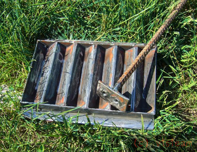

Another two to check off the list.
« Last Edit: January 06, 2018, 11:18:24 PM by vtsteam »

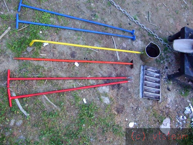

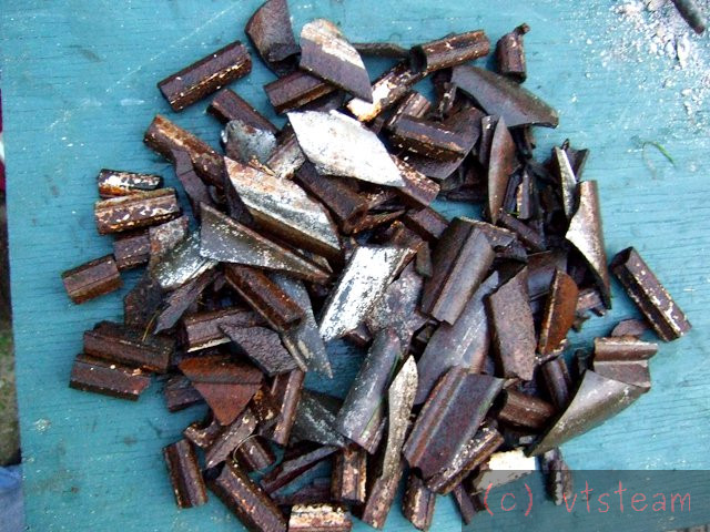

Well was able to sneak in a couple minor things after supper -- painted the handles different colors so I know what is what quickly, and won't lose a tool in the grass.
And I soaked some broken up steam radiator pieces in a little dilute muriatic acid for a couple hours to remove scale and most of the rust. Then rinsed and set out to dry. That's about 18 lbs ready to go --  3 charges @ 6lbs ea. in case they are needed.
Getting there little by little!

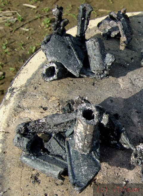

« Reply #139 on: June 26, 2013, 08:45:23 AM »

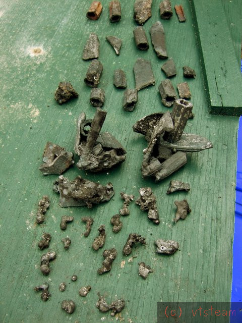

What I found this morning:
It was up on top of about 7 inches of un-burnt charcoal. Extinguished when I shut off the openings. I don't think there is any metal pooled at the bottom, but it's too hot in there to get the charcoal out yet by hand to find out. Still hot at the bottom 16 hours later.
Lining looks in perfect shape, and the top fired well. Yesterday I chipped away at older parts of the top and relined so the top had the concave shape I wanted. I think it fired all the way across. So that's a plus.
« Last Edit: January 06, 2018, 11:23:12 PM by vtsteam »
Re: Sawed off cupola
« Reply #140 on: June 26, 2013, 10:21:36 AM »
I removed the charcoal from the bottom. Lining is perfect. No puddle of iron. But a fair number of frozen droplets mixed in ith the bottom charcoal. Here's all the metal removed from the furnace, arranged by melting range. Sifting this stuff out feels a little like an archaeological dig.  :borg:
« Last Edit: January 06, 2018, 11:23:53 PM by vtsteam »

So you were close in temperature but not quite high enough. Either not enough air or possibly too much air over cooling the burn. I suspect the former as you have unburnt charcoal left. Did you get white sparks out of the top or only orange? Many cupola designs pre- heat the blast air using heat lost in the walls.
« Reply #142 on: June 26, 2013, 11:02:27 AM »
Thanks awemawson.  Air might have been a factor but the biggest problem was not enough fuel height -- at least that's what I think.
The charge burned through in at most a couple minutes. Didn't time it, but should be more like 5-10 minutes for the iron to drop through.
I measured the furnace and the 2" tuyere is centered 7" above the sand floor, and 11" below the top of the furnace barrel.
So that's only an 11" bed height. From readings, a lidded cupola furnace can get away with a shorter bed height. That may be true, but how much shorter? and charcoal would seem to require a higher bed height normally. So I think it might have worked with either coke, or more bed height.
So, options:
1.) I have a nice strip 10" x 48" of clean steel sheet that I can bend into a furnace extension. That would give me 21" of bed height as opposed to the present 11". It will be less of a "sawed off cupola" however, and I will have to modify the lid lifting mechanism as well as make the new extension. The space for a drop may now be insufficient under the furnace, but I suppose I could raise it on blocks, and or trench a little under it.
2.) I could make an oil burner pretty easily and run it as a waste oil crucible furnace, with no other modifications.
3.) I do  not think this furnace will work as a charcoal crucible iron melter -- though I could still try that. But I believe that would require a bigger bore to seat more fuel around the crucible. My crucibles are about 5" in diameter, and with a 7 " bore, most of the charcoal would have to be sitting on top of the crucible, and wouldn't drop past it. A plinth would also block fuel. Wish I'd made the bore larger -- that would have helped the cupola mode as well, I think.  I don't know if crucibles are ever set floating, to drop with the fuel -- that would be the only possibility I think, of melting iron with charcoal in a crucible in this furnace.
« Last Edit: June 26, 2013, 11:32:49 AM by vtsteam »

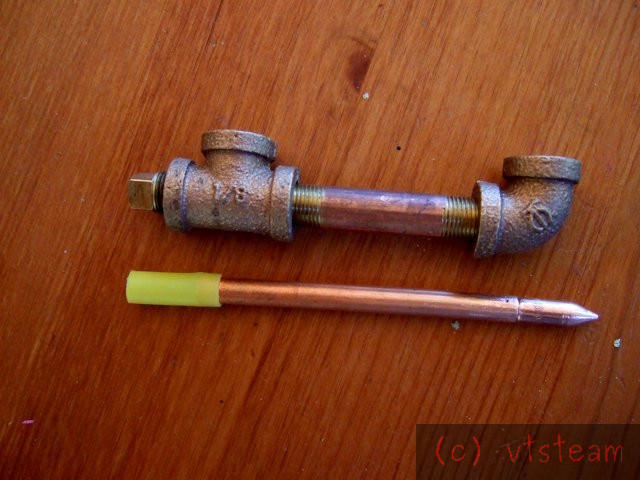

I happened  to have just about everything needed for a Kwiky style burner so I'm making one up right now. We'll see if it's man enough to do the job  :dremel:

I also completed the burner jet -- several parts needed to be silver soldered. I then tested and adjusted the atomization of the burner jet with water, and briefly with waste oil @ 30 lbs of air pressure. No attempt at fire yet, but it draws oil very well and atomizes it. I'm confident it should flame.
I still need to locate the burner jet assembly into a pipe casing and then mount that to the furnace Also, connect the blower, which will probably be my small shop vac.
