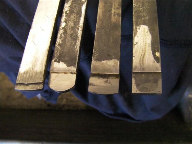

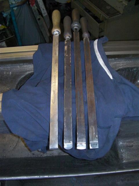

Any chance of a photo of your shop made scrapers  :poke:
Sure - here they are. Obviously not as posh-looking as your stuff as I only have a cheap camera without all the special effects yours has got  :D
The one with the short tip and new handle I made by silver soldering a carbide slip gauge to a steel shank. The others I made after buying a bunch of different-shaped tips off eBay. The sqauare one i made for scraping rust off ways etc but at the moment it's doing serious duty stripping 70 years of paint of my Monarch lathe. The rounded one is a bit too small a radius for scraping but that also makes a great paint scraper for internal curves.

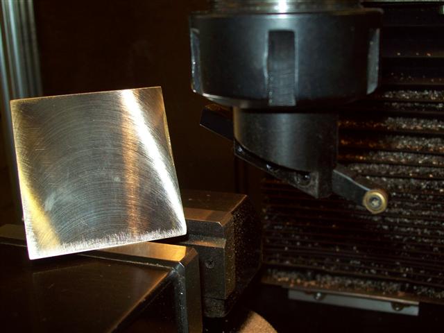

Hi there, Rob,
I was looking at your photo of the cast iron slab being fly-cut and noticed the clamps holding the slab down to the table.
They look very much like the gizmos I've seen listed for sale on eBay and described as face-plate jaws (no names - no pack-drill!).
Thing is, the 'buy-it-now' price for those face-plate jaws seems awfully expensive!   :scratch:   :scratch:   :scratch:   :scratch:
Do they have some hidden mechanism that's not visible in the seller's photos or are they hyper-strong or what?

Hi Pete ,,,, Face plate jaws are normally sold in a set of four , with each jaw having its own adjustment, just like a four jaw chuck ,  , making a set for my CUB lathe is on my too do list  :dremel: . The ones I am using on the mill have one fixed jaw and one moving jaw , basically your mill table becomes one big vice .
The sets you looked at on Ebay were probably a VERY LARGE set .

Came home today from work to fined a parcel sitting there for me  :)  Pete had very kindly made me two of his carbide scrapers .
Being the impatient git that I am I was straight into the shop to try them out ,they still need handles making .  :palm:
Result , they are far far superior to the HSS ones I have been using , they cut like a dream   :med:
Pete had lapped a 5 deg neg rake , my crappy camera skills dont do justice to the edge ,but  I can say is its a  lot better than my scraper sharpening .
One of the two has a thinner blade , just the job for getting into dovetails .
Thanks again Pete ,,,,,,,,,,,,,I really owe you one  :beer:
Nooo problemo!
I would have cut file tangs on them but I was worried they might come out of the packaging in the post.
I hope the tips stay put - I had no idea it would be so hard silver soldering them on with butane gas. Had to cheat a bit to get enough heat from the canister but I won't say how coz it wasn't exactly a right and proper thing to do :)

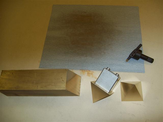

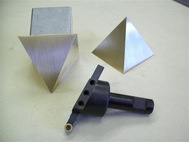

Hi Lads , I managed to finish off the arbors today , spent most of the weekend sorting out my shops and its still not done  :Doh:
All done .
cutters the wrong  way round  :lol: :lol:
The arbors will hold up to a 1/2" wide  cutter .
Now back on with the mill  :dremel:
