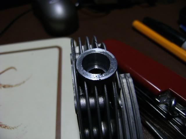

I did this repair a few years ago, but happened on the photo's I took whilst looking for something else  :scratch:
The plane had crashed and ripped out the exhaust manifold.
First job after getting it cleaned in the ultrasonic bath was to mount the head on a lump of something I could grip and act as a heat sink when I did the repair.
Once mounted I could clean up the damaged areas and prepare the casting for alloy welding/soldering.

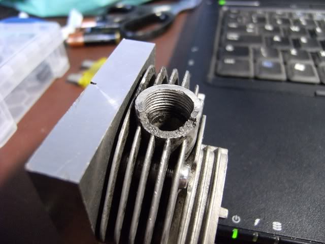

I jammed a thermocouple in the part as I did the weld to monitor how close I got to melting the casting as a fraction too much heat from the blowtorch would cause the whole casting to slump and melt.  I used plaster of paris for dams around the casting and in the exhaust port so the molten metal stayed where I wanted it and played the torch around the casting rather than just at the port.  The above picture is after I re-machined it ready for thread cutting, you can see some porosity in the metal I added.
Part re-threaded and cleaned up.  The welding process burned all the gunk off and left me with a lovely clean part.  I didn't have a means to cut metric threads at that time so the thread cutting was done on a friends lathe.
Finally back together and you could hardly tell it had been repaired from the outside, just cleaned it up with a needle file.  I was happy with the repair and so was the owner who had this engine flying again.  This was the first time I had really used the alloy welding rods in a real application so pretty impressed.   Didn't work so well on the next engine I tried to repair, and of course didn't bother taking photos that time...  :palm:

Excellent repair. I like the idea of putting a thermo-couple in to monitor the temperature - better than the old trick of rubbing soap on the part  and watching it char  :clap:
