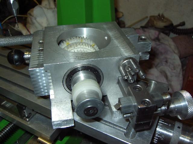

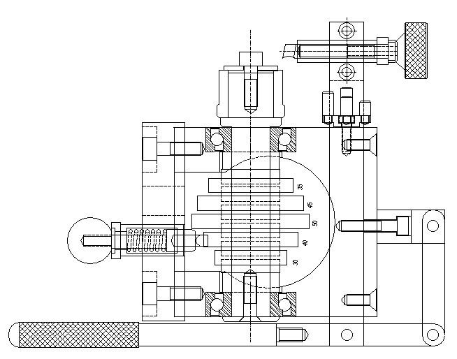

Allego alcune immagini di un indexer che ho realizzato anni fa per incidere i volantini

Dag-50, sorry but I do not speak Italian but I think you are looking for info on the indexer, if so see http://madmodder.net/index.php/topic,8374.0.html

Dag-50, that all-in-one micrometer dial indexing scriber is also very innovative, you are a person with a like mind.
