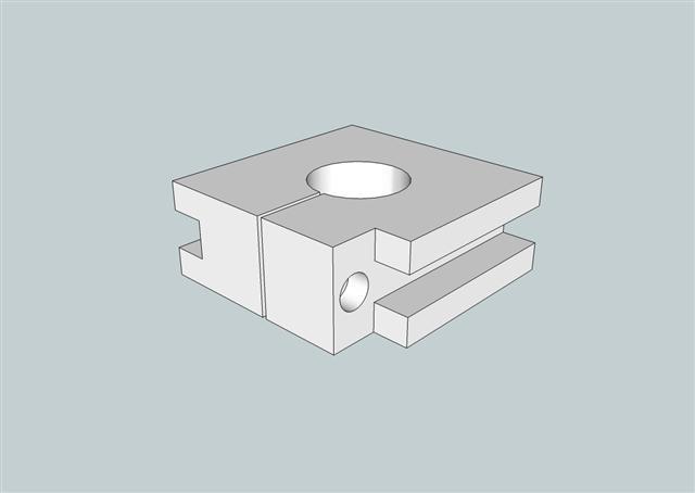

Hi Pete
I don't quite see how that would work.  Where would you put the bolt to clamp it to the round post?

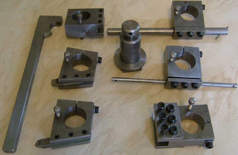

I have some similar tool holders and I can make them so you can flip them over to use either end of a boring bar.  I've also made some cut at an angle so I have more clearance for the tailstock.
Here, Russell. One small design change and you double your number of holders.

« Reply #30 on: April 11, 2013, 09:57:19 AM »
Thanks Pete,  I understand now.

Pete, Nice dwg! I had contemplated putting the tool slot at the side of the toolholder, as you show. Unfortunately, the Mason design is too narrow to do that -- the slots are too near the post bore. Since I've already cut mine out of stock on hand, I can't do it. But if someone else starts afresh and wants to, I'd recommend making the tool holders 2-1/2" square on top instead of 2" x 2-1/2", as shown by Mason.

How about instead of milling a slot, drill the toolholder and cut a slot and add bolts so you can clamp round bars.  Then turn a JT33 taper on a bit of round stock.
Here's a picture showing some toolholders.

Russell: nice collection of tool holders.   Looks like a SERIOUS wrench to go with it.
How about making one of the tool holders to take a tangential cutter instead of a tangential holder mounted in a QCTP holder?  Just an idea.

RussellT, Nice!! I was planning on boring bar and cutoff tool "specials." And I particularly like the wrench.

The wrench was a bit of an afterthought. I wanted to try it so I tightened it up using a couple of short tommy bars - but it moved. I suppose I could have fastened the flange/washer to the post and keyed the washer so it wouldn't rotate in the T slot.  Instead I just did it up tight. :D :D :D

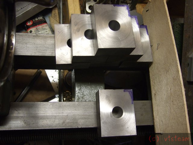

I finally gave up on a good finish with the carbide, since even it was eroding from the mill scale. I finally  just used it to scrape off the scale, ignored the deep grooves it was making, and decided to give all the blocks a final dressing with an HSS tool bit. That went better.
What a bunch of abrasive crud! Next time the scale is removed first before any machining -- thanks for the tip PhilF -- I'll look for brick cleaner. I think muriatic acid is available as such also in our local hardware store.

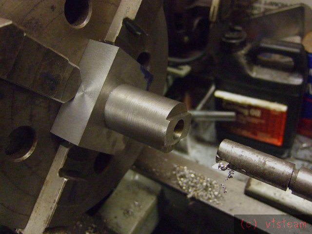

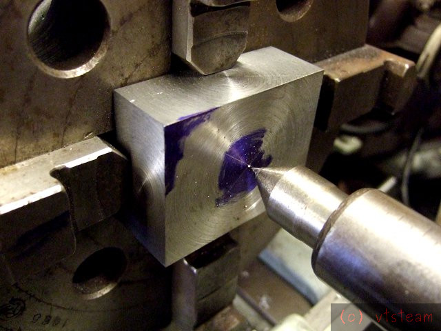

After the blocks were cleaned up, I placed one in the 4 jaw to center it. I marked all the blocks on one corner as a reference when placing them in the chuck. I opened only jaws 1 and 4, and the marked corner of the blocks all went against jaws 2 and 3.
The first block was centered in relation to the tailstock center, and then I replaced the center with a Jacobs chuck to start drilling for the post hole.

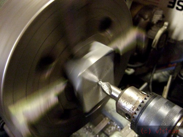

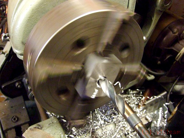

Drilling the pilot hole. All pieces were drilled at each step before changing the drill bit to a larger size. The finish size of the hole was to be 1.25".

« Reply #40 on: April 11, 2013, 07:22:14 PM »

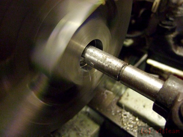

Drilled through 3/8".
« Last Edit: July 16, 2017, 11:19:20 PM by vtsteam »

« Reply #41 on: April 11, 2013, 07:26:31 PM »
Next drilling to 5/8".

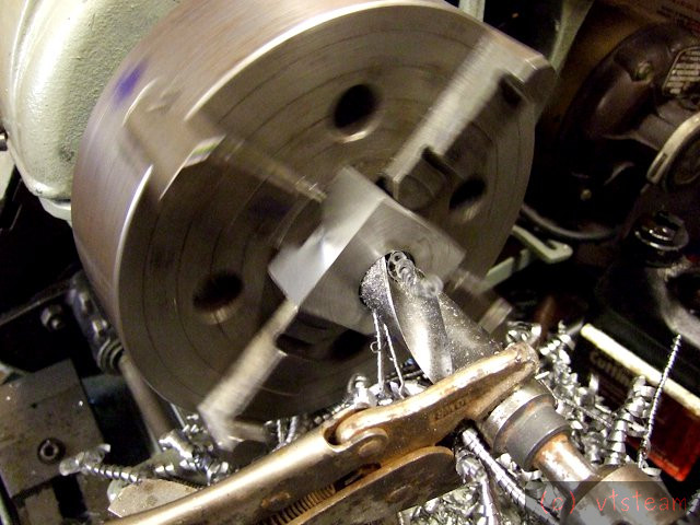

Last drilling operation. The largest drill I had was an odball 1-1/32". don't know where I picked that one up from! I clamped it with vice grips to keep it from turning -- they rest on the top slide (out of view). The blue marks on the chuck are at Jaws 1 and 4.

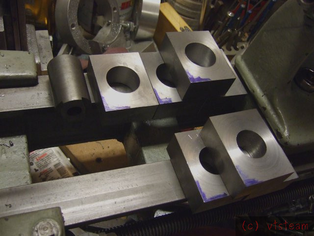

Supper time again. Top four blocks have been bored. Bottom three just drilled. Starting to look like tool holders.  :ddb:
