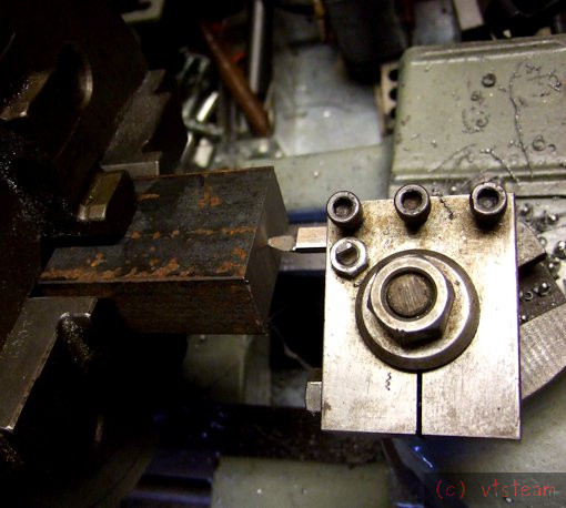

Here is the my one QC tool holder about to face the end of a new one. I used the 4 jaw, and didn't set the block all the way in against the chuck face, since the back of the block isn't faced yet. The jaws alone are positioning the block.
To place subsequent blocks, I opened jaws 1 and 4 to release a finished piece and replace it with a new blank.

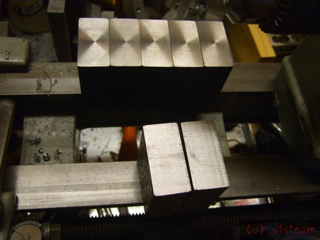

Here are the new 7 blocks with the first machined face on each. I checked them all with a machinist square after facing to make sure they hadn't been misaligned in the 4 jaw.
« Last Edit: July 16, 2017, 11:09:17 PM by vtsteam »

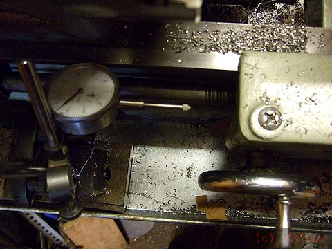

After facing one end I decided to face the opposite end to dimension the block. The finished toolholders are 2-1/2" long.
I don't have have a carriage stop (one more project for another day). So I decided to just place a clock indicator on the magnetic base at the end of the carriage travel.
To load, this time I placed the blocks with their newly faced ends against the 4 jaw chuck face and lightly tightened jaws 1 and 4. I then tapped the block in with a soft face deadblow hammer to make sure it was seated. And then did final tightening.
I took a test cut, removed the blank and measured it with calipers to get the total amount that I needed to take off. I then reset the indicator so that it would read zero when I reached the finished dimension.
I replaced the blank and turned it down to within 10 thou of finished dimension and took it out again just to check the setup. A slight adjustment of the indicator and I replaced the blank and faced it to 3 thou over.
Unfortunately, without more QTC tool posts I couldn't do a finish cut on this face with a different lathe tool without wrecking my set-up. For the second sizing face I was using a more aggressive tool grind than on the first face and that left a rougher finish. I had to take up to 1/8" off, and with an interrupted cut, a finish bit would have been slow going.As it was I was getting about 20 thou cuts at best without chatter. I left the 3 thou over so I could finish up later.

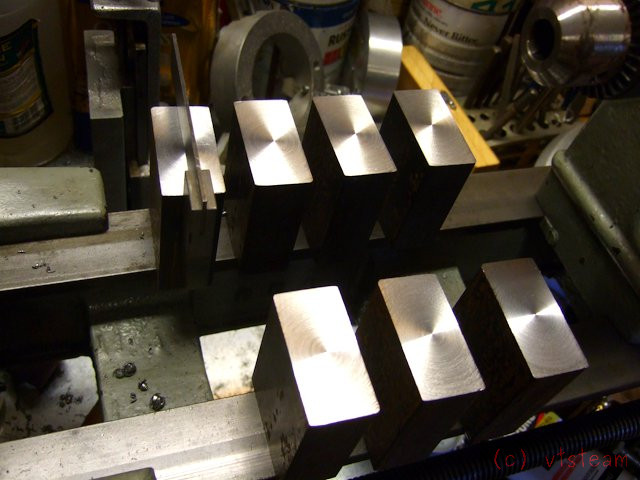

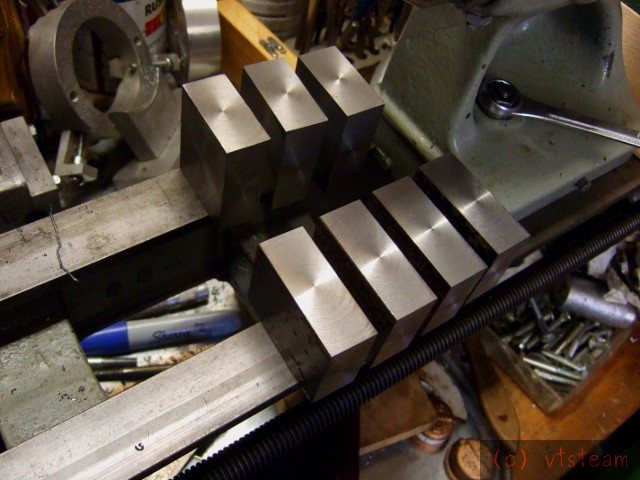

I managed to face 5 of the blanks before it was supper time. The two others will have to wait until tomorrow. About 2 hours work total -- which is pretty good for me. I still have to spend half my time figuring out how I'm going to do something. And this lathe is not as well equipped as my Gingery lathe. But it's coming along.

Faced 4 sides on 4 of the blocks and 6 sides on 3 of them by supper time.
Slow going here, mainly because of the mill scale. It dulls the HSS pretty quickly, and it takes 3 cuts for each side face.  I honed the tool in the toolholder for the last cut on each face.
I used a carbide tool on the broad face to cut through the scale. Not a great finish, but at least it went a little faster.
I now remember that before starting on the first toolholder I made a few years ago, I soaked the blank overnight in a jar of vinegar and salt, and the scale was mostly gone by morning. Probably should have done that again.
« Last Edit: July 16, 2017, 11:11:34 PM by vtsteam »
