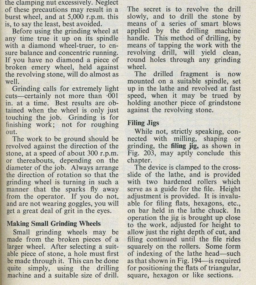

L.H. Sparey in his book "The Amateur's Lathe" suggested a use for broken wheels. (See attached scan)
I'm sure that this will be frowned upon.
Re: Second Hand Grinding Wheels - Usable or Junk?
« Reply #19 on: August 27, 2013, 04:43:31 AM »
Yes there are a few issues there:
a/ Using the drill press to hammer drill through a stone  (goodbye drill press bearings)
b/ Dressing roughly made mounted stone on lathe (goodbye lathe ways)
c/ No precautions regarding how the arbor is glued  (goodbye eyes and teeth)
However I stand by my first posting in this thread - with suitable precautions and for my own use I would (and have) used s/h stones

I have L.H. Sparey, "The Amateur's Lathe" and there are some other methods as well that might be considered dodgy by modern standards. On the other hand it was a little harder back then to search stuff on internet and order stuff with pay-pall. Most of the tools had to be made, unless someone was doctor/dentist/manager and could actually buy them....
