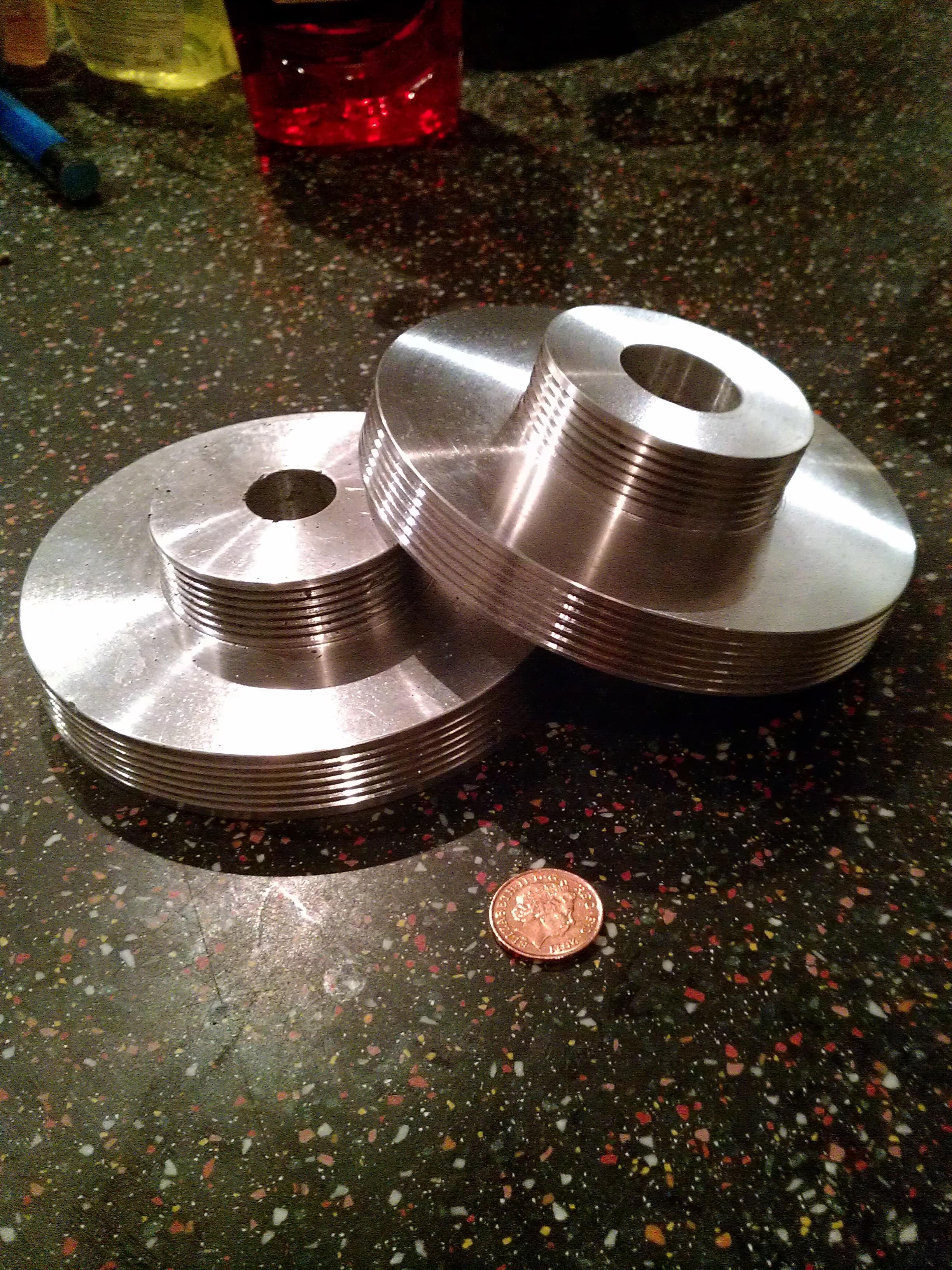

Guys I'm rebuilding a Z axis on my cncmill. I've dumped the gearbox in favor of going down the the 2 step pulley route, VFD on the 3 phase motor. I have messed with htd belt, v belt but never played with Poly V belt?
Poly V is the way i want to go but not sure which would be suitable to use (J, H????). I also want to make my own pulleys as well, preference would be to make a suitable form tool for the job. Plan is to go with 6 groove belt and the pulleys to be 100mm and 50mm steps. Saw stuff about using 11tpi pipe chasers for the job, but I'm a metric sort of guy. Any thoughts please?

I have used Poly-V pulleys on several projects. The last was my CNC when I used a 5 groove belt and a 3 step pulley to give me a range of speeds of approx 200 rpm to 10,000 rpm from a 1hp 3ph motor running at up to 5,000 rpm via an inverter.
Here are a couple of scans of documents from a Poly-V belt and pulley manufacturer.
For my CNC I chose a 5 groove J section because the belts were easy to come by - they're used widely on lawnmowers so can be picked up from a local DIY store or garden centre.
So use 2.309090909 mm pitch chasers

This is is very helpful and the pics are fine to read. Lawn mower specs is probably a good route, like you said Phil makes it common. John i was thinking i could turn a large radius piece with a thread on the lathe and then cut it up to make a chaser from a bit of round? might give that a go. Just need to work out if i can get that pitch.

I have found that Simtek in Germany make profiled inserts for cutting the grooves:
http://www.premierformtools.co.uk/pdf/EZG24.pdf
It might be worth asking Premier for a price (and hopefully you wouldn't have to buy 10!).

I think i'm going to have a go at making one. Just need to find a gap in the weather now to cast up some blanks  :beer:

Poly Vee pulleys have the grooves cut at 40 degrees 2.34 mm pitch.
 BSP is 55 degrees pitch this will make for a very poor contact.

Thanks for the info Eric, Already received a 11TPI pipe thread tool that will do the job. Did a test cut and it will work out just right.

Eric agreed but the belt is rubber and soon adapts.

Big thanks guys, cast the Ali and got them made even though i have to make one of then again.......Note to self, make sure cutting tool is set at correct height or it gets pulled into the work and promptly throws it out of chuck and ruins it.
