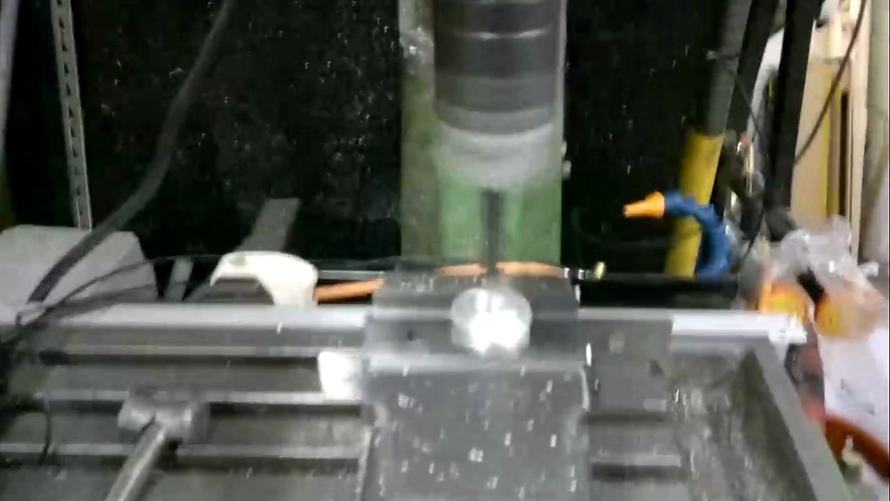

My newer mill' has a simpler affair on it, jjust made an extension plate and fixed the bottom to the bit that already stuck out of the quill  :)
No photo's oddly  :scratch:  But you can see it in this vid... Click on the pic'
Incidentally... Arbalist,
You never use your fine quill feed? :jaw:
 I use mine all the time... And modified it as in the vid' above to make a great automated fine boring rig.
Hope something in there helps? I've got hundreds more pic's if you wanted to see any?
