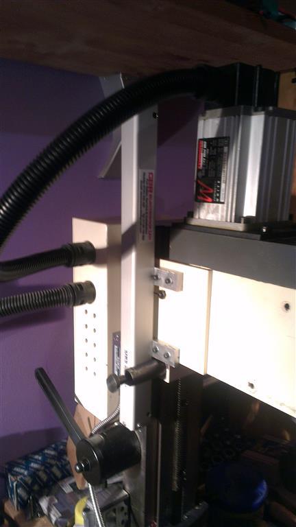

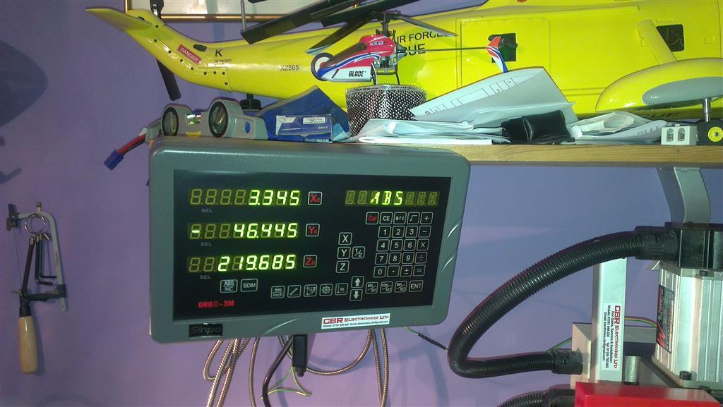

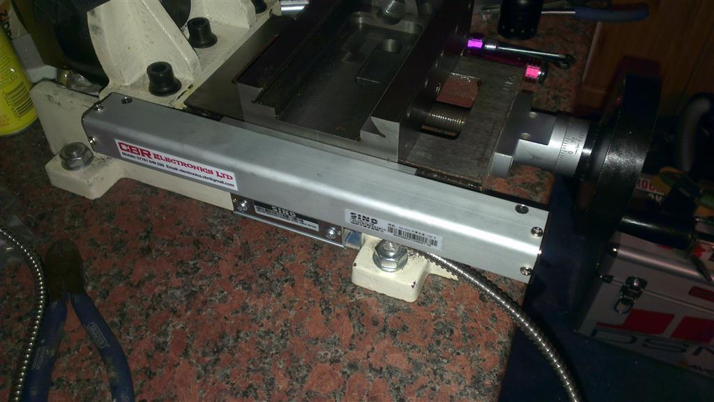

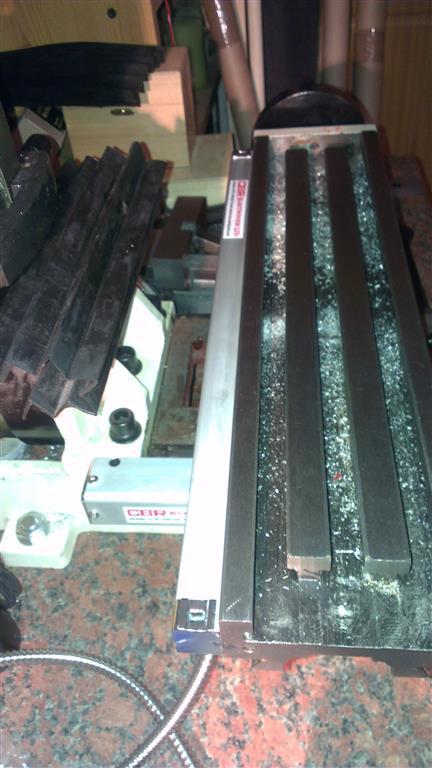

I have just fitted a 3 Axis DRO to my SX2 mill, and even though I am still in the 'Lets Play Mode', I am very impressed.
The *bay site that I used had the option to purchase stock from a UK agent, which meant that I had quicker (Overnight) delivery and knew what price I had to pay instead of running the excise/VAT/delivery gamble
You do have to be creative in fitting the scales, but after chatting to the UK agent I ended up with 3 slimline units which have fitted on very well.
The quality seems good (time will tell, but have seen good reports on various forums), and I am extremely happy with it.
I have posted a few pics to show my set up to give you an idea  :thumbup:
