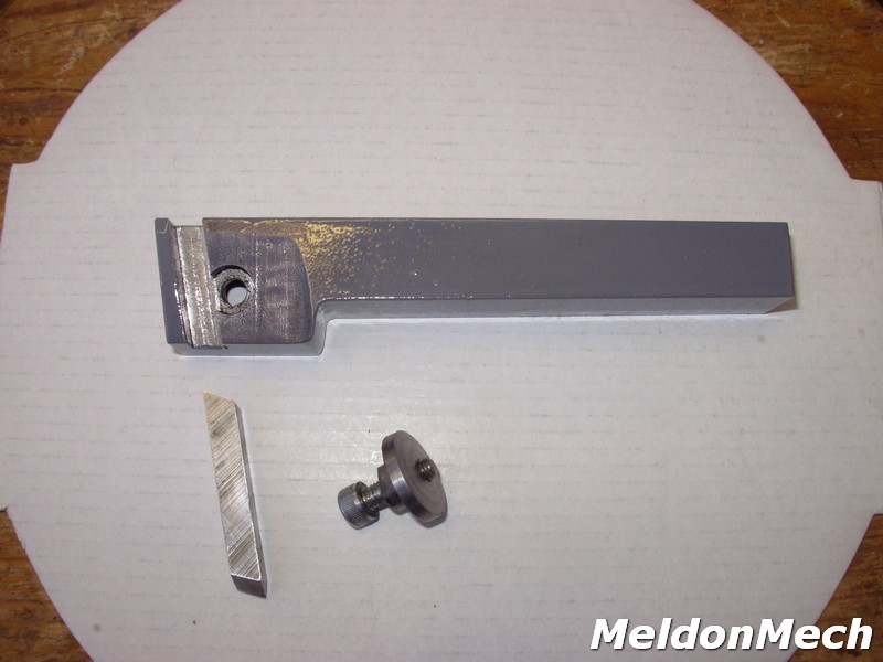

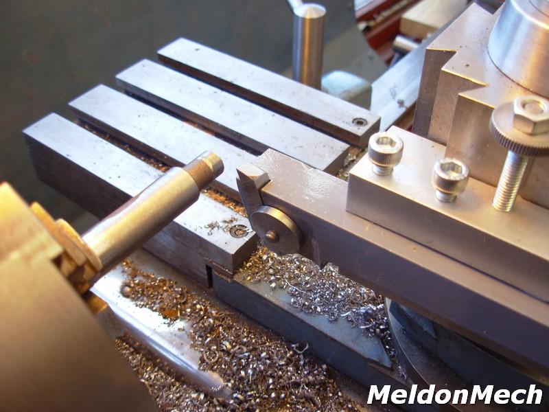

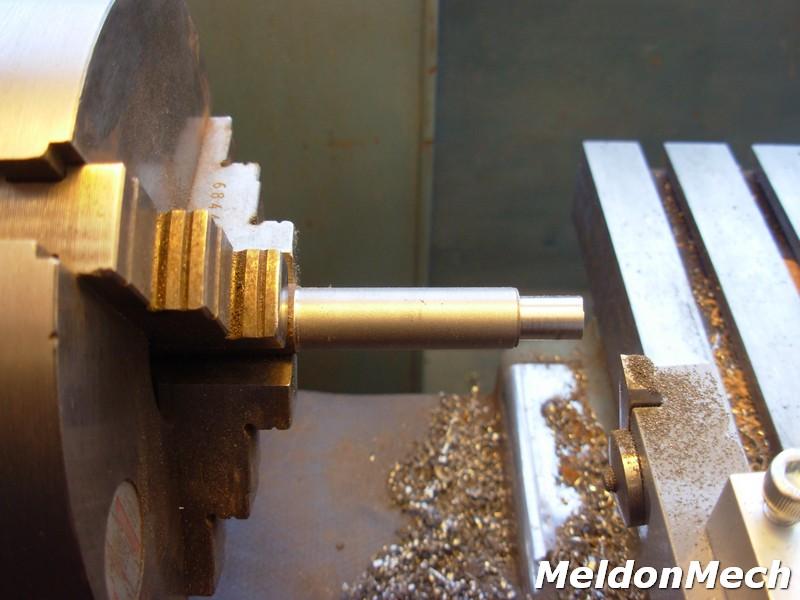

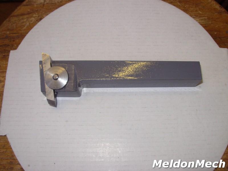

Hi Guys,
             I had a number of 1/4 inch square HSS tool bits, and have been using them in J&S tool holders. I have fancied making a new tool holder to what is a very old concept, where the tool bit is held in the vertical mode. Up to now I have have only seen shop made designs that are big and clumsy. I have been inspired to make this tool holder to a design recently posted by Arbalest on another forum. The machining is a little tricky and I used a compound angle vice on the mill. I used a 10 degree front and side rake for mine. Used a simple wooden block with vee slot milled in for grinding the tool bit. I tried the completed tool on a piece of rusty old cast iron, and was very surprised how good the finish was, when feeding towards the chuck, and even better when feeding to the tail stock.
                              I have no hesitation recommending this design, thanks Arbalest, well done  David

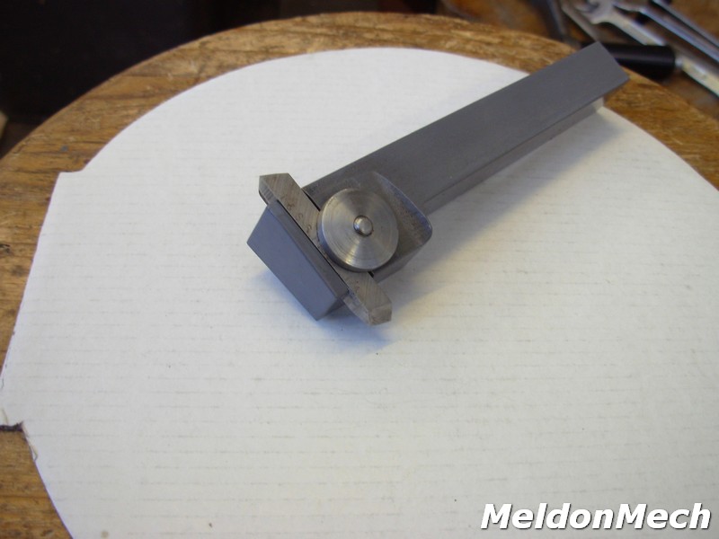

Hi Andy,
             Yes it does look like Mikes tool holder, and there are many more that achieve the same result. The end view is not a parallelogram, but it produces the same cutting geometry. It is a rectangle, large side vertical, with a 10degree angle milled on the R.H. side,  viewed from the front end.
           Have you made one? I am going to make another, to take 5/16 inch tool bits, and one to take broken center drills.
                                                                   Cheers David
