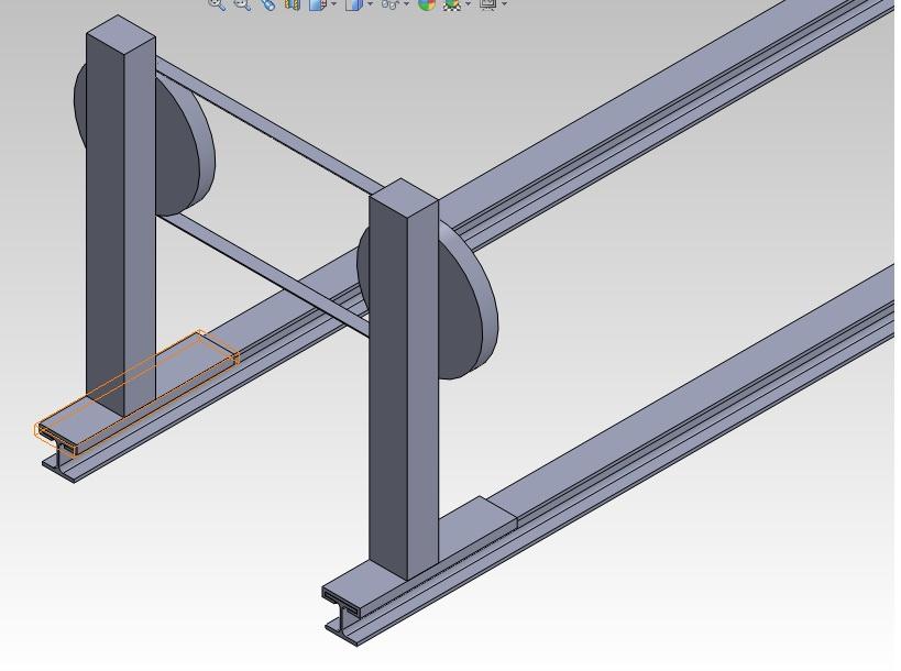

Hi! A bad case of  :proj: On top of all the other projects!  :doh:
I'm currently drawing up a 'small sawmill' with about 12m capacity. (Portal type for saving space)
My first thought was to have the feed driven by a rollerchain, but looking at the prices I suddenly changed my mind!  :D
Racks an pinion also comes to mind but they of course is equally expensive!
Just having two rubber wheels make contact to the frame do not appeal to me because of the possibility of one wheel slipping and the portal twisting.
Wire seems in my mind the way to go! I'm thinking of putting one motor on each end let one do the feed and then the other do the return (also a way of having a rapid return by letting one motor go faster on the return)
Are there any other clever ideas from the wise people in here?

A quick sketch of what you have in mind could help.
Alan

« Reply #2 on: February 19, 2013, 02:26:14 PM »
A really quick sketch of the general idea.
Nothing fancy

« Reply #3 on: February 19, 2013, 02:51:48 PM »
I assume that the idea is to hold the log on some form of cradle or fixture and use the cables to pull the horizontal bandsaw through it, cutting off a slab. It might be better if the bandsaw were vertical so that the weight of the slab being cut doesn't pinch the blade, but the commercial units all seem to have a horizontal blade.
By the way, there are commercial band mills that use a hand fed blade. You might start there and then add power feed.
Alan

« Reply #5 on: February 19, 2013, 03:01:26 PM »
Alan
Yes there will be 'hooks' on each end of the log.
And there is going to be some kind of separator behind the blade to avoid the pinching
I think (And I am not sure) that they cut horizontally to avoid the slab from 'falling' and breaking the end of.
I have tried cutting slabs with a handheld chainsaw sawmill and that is something you really get tired from fast!  :D Of course with this setup it will be easier, but being so damn lazy that I am I think that adding the powerfeed from the beginning is the way to go!  :D
Thank you for your input!    :thumbup:

« Reply #7 on: February 20, 2013, 02:38:46 AM »
The bandsaw leaves a much smaller kerf than a chainsaw so you will find it a lot easier to push through even compared to a chainsaw fitted with a rip blade.
Again the set of the teeth will give you enough clearance just behind the blad so unlikely to pinch. Cutting horizontally also makes it a lot easier to dog the log.
You say hooks in the log. Are you intending to pull the log through a stationary bandsaw? You would be far better moving the saw through the log thats how most bandmills work like woodmizers, logosol, etc. Also takes up half the space.

By hooks I mean hooks to keep the log in place and then move the saw. Clamps is most likely a better word.
I actually think you all have me convinced to forget the powerfeed and just push the saw.
