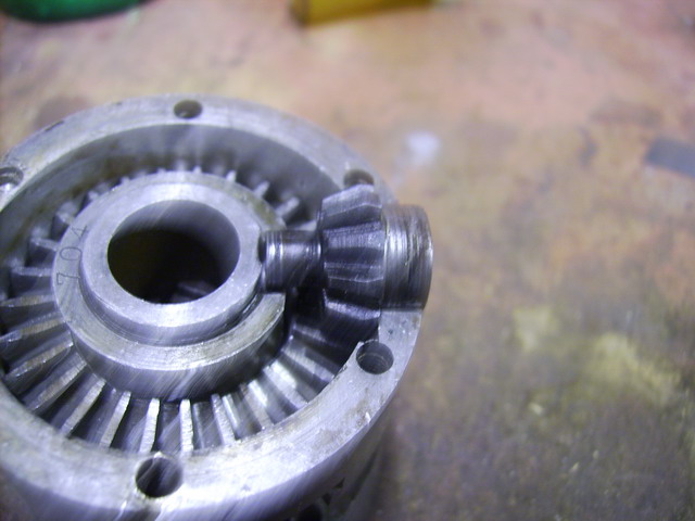

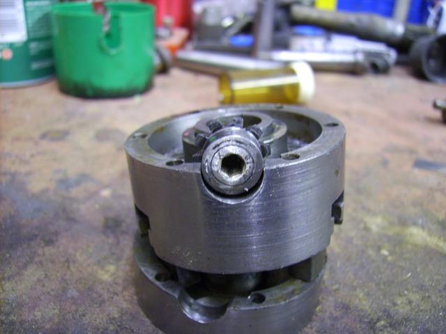

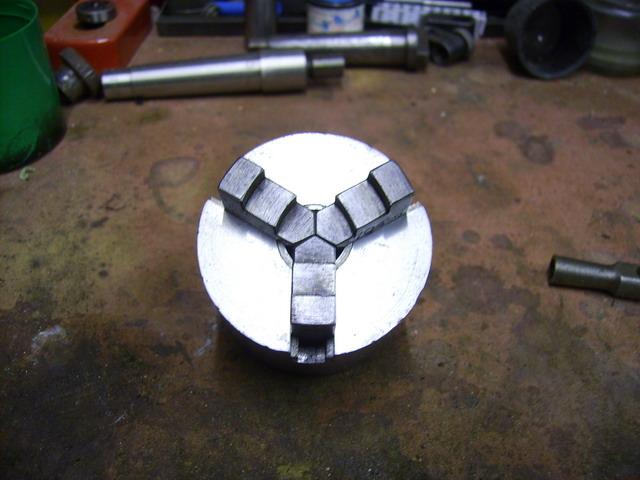

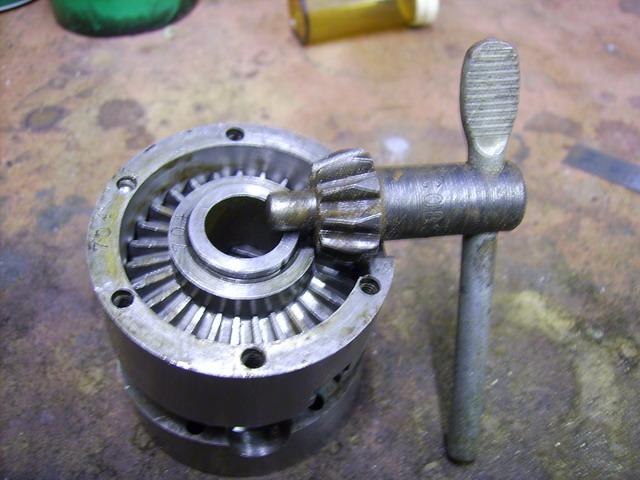

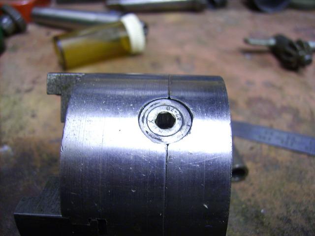

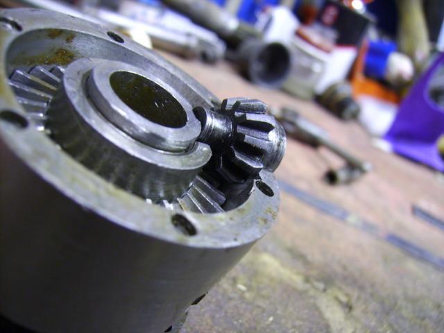

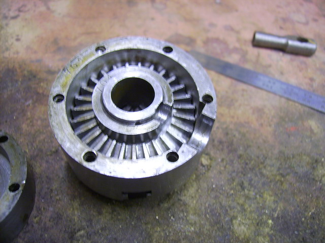

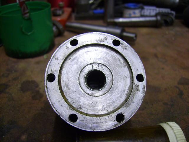

hi all was given this as it was gowning in the bin their is no makers name on it it just has a number 704 on all of the bits it was dismantled to clean but the fixing screws and the pinion was Miss palest and never fawned a gane so the first job was to have a rut in me chuck key box to find a key that wood mach the scroll i had one but it needed a bit of work the bit that fits in to the chuck body the out side diameter on the chuck key was to Small so it needed a sleeve putting over and a sqear in the middle for a chuck key well i cheated as all i did was to drill threw a m5 stainless steel cap head Field it out so that a Alan key wood go all the way threw then the hole lot silver soldered up still need to find sum screws to fit it as they will be inch can any one help in identifying the mack of chuck right pics

and another fantastic save.. :thumbup:

That fix is what I call think outside the box. Well done!

thanks all for the coments no i wast nothing
