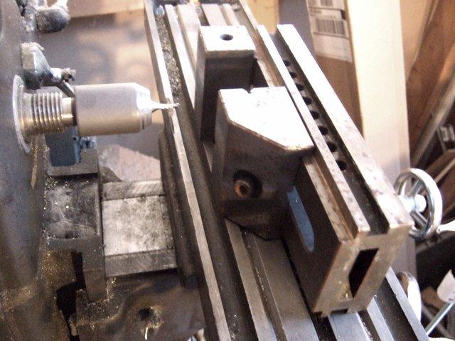

I forgot to mention this last post, but if you have a toolmaker's vice and you mount it on edge, it has the same positional relationship to a horizontal mill that a regular milling vice has  when mounted upright on a vertical mill. And you can do the same operations with it using the same types of end mill held in a collet.

Of course you can orient the vice upright as well and even on end, like a vertical milling attachment on a lathe.
A toolmaker's vice is nice because it is square all around, and can be clamped with toe clamps in most any position. This one isn't clamped -- I just put it on the table for a quick photo.
You can also move it to the near edge of the table so a piece can extend below it. Or you can block the vice up off of the table. There are a lot of combinations for setups.

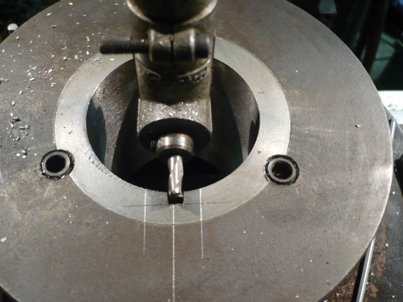

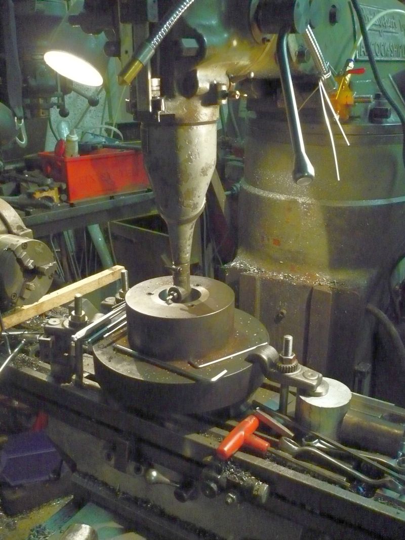

I'll try to show some setups I've used with my horizontal mill here. Can't get to some of the things I need right now -- blizzarding out. But I would strongly suggest anyone interested get David Gingery's book on building a horizontal mill from scratch.
The process of building the mill actually uses the mill to perform many operations, as well as building accessories to make it more useful. It therefore shows in very practical fashion ways of working with it nd ways of thinking to make it more versatile than just running the standard slotting and surfacing cutters. Even if you already own a horizontal mill, rather than wanting to build one, there are many things you can add to your mill using ideas in the book and the same -- or possibly different construction methods
