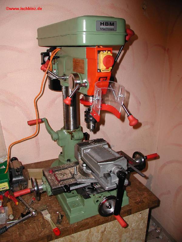

very nice use of limited resources for a job that actually does not need more resources. I am currently building the same setup as yours (even my spout seems to be exactly the same, as well as the fittings).
What I have not yet decided upon at all is how to make the tray. First, my column goes below the table, i.e., the table has a big hole to allow the column to sink down. Second, I'm not sure how to avoid the coolant pooling on the tray and just staying there; the lower body of my machine does not seem to lend itself well to be raised on posts like you did.
My machine is this (well, not the actual one, but just like this): http://www.ischbinz.de/maschinenpark/P1010016.JPG
« Last Edit: January 24, 2013, 05:56:37 PM by CrazyModder »

Re: "El Cheapo" Coolant System for Mini-Mill
« Reply #8 on: January 24, 2013, 02:44:02 PM »
Two pieces of square tubing can replace my posts or even channeling.
Regards
