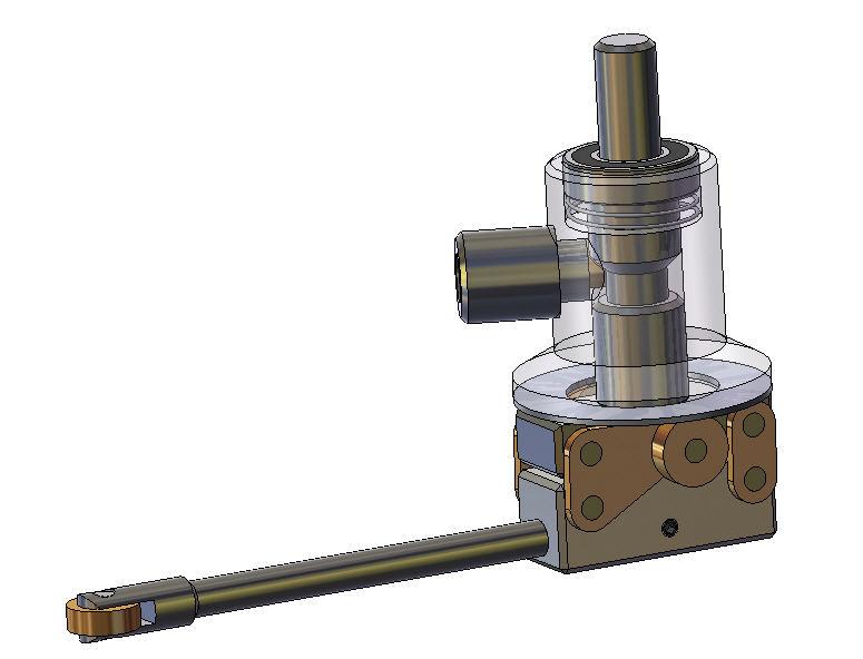

Locating the centre of a hole tool desired
« on: January 15, 2013, 05:52:07 AM »
I often do small jobs that require either the holes in the casting to be enlarged or other machining work needs to be carried out using the centre of the holes as reference points. Tuypical sizes for me are from 25 to 150mm. Currently I have found the best way is to machine a piece of Aluminium stock to an exact fit in the hole, centre drill it, then use my mill centreing tool (Starret - the pointy end) to get the correct position to clamp it onto the rotary table.
Thing is I seem to be getting a large collection of randomly sized bits of aluminium and I feel there ought to be a better way.
Does anyone know of a tool which will do this with fair accuracy ?
Just off to turn up another one .. .
Many Thx in advance
Picclock
(If it exists I may be able to pick one up at the show on ay Ally Pally this weekend)

Standard kit, if you've got the headroom is a Blake co-axial indicator (lower cost clones available from Allendale etc.).   Mr Todd of this forum is evolving lower-profile designs of co-axial indicator.
Another option is visual - either a centreing-microscope or a miniature camera. With those, if there's a marking then you can pick it up; otherwise if its a bigger hole, traverse to one side, note reading on DRO or dials, traverse to other side and halve the reading to get the centre co-ord.

How about something like a very small 3-jaw chuck? Put the chuck "jaws" down in the hole to be centred, wind the "jaws" out until they are a snug fit in the hole (doesn't need to be a grip fit, just an accurate sliding fit); the back of the chuck would be accurately centre drilled to give you your hole centre.
The hardest part, I guess, of building such a device would be cutting the spiral track for the "jaws" to run in; so it might be better to buy the smallest "real" 3-jaw you can buy, adapting the jaws to suit this task & adding a back plate which is centre drilled.

To get my round column mill back into registration over a small hole after altering the head height to accommodate a tool change I forgot to allow for, I made up this affair:
The conical end is retained by an internal spring, and slides around like the end of an edge finder. It is lowered into the hole, and X and Y are adjusted until I can't feel the join anywhere round the circumference. Fingertips are sensitive, and this gets me centred on the hole again within a thou or two.
If you don't need absolute accuracy, maybe you could fabricate versions with fat business ends on thin shanks, and truncated cones of varying major diameters to suit your 25 - 150mm holes. Mine is silver steel/drill rod and the cone is hardened, but silver steel in your size range would be expensive, even if you could find it.

@AndyF that's the same as the starret edge finder, but the edge finder only goes up to 8mm or so. Its a great way of getting the centre of smaller holes. I use this in conjunction with an aluminium disc that has been turned to fit the hole and centre drilled. I'm trying to do it without turning the disc.
@ Adev I have a 'real' 3" Lathe chuck that I have experimented with but its just not good enough. It was never very good as a chuck anyway which I why I use 4 jaw's now with a dti. The chuck centre varies substantially depending on the size of hole. I don't know if a better make would do the job either as you are working off of the wrong side of the spiral. The jaws are being forced inward rather than outward as they would be in normal use.
I keep thinking that it ought to be easy making something like this but I'm out of ideas, and I know you forum members are way smarter than I will ever be - hence the post :beer:

I don't want to labour the point, Picclock, but I was thinking that making two along the lines of this sketch would cover your range of hole sizes.

Thats an excellent way to do it - it makes me feel stupid for not thinking of it before. Its much simpler that my other thoughts, and it will easily lend itself to having sections of the cone removed leaving either 3 or 4 flutes, which is sometimes useful for me. I had thought of something along the lines of the mechanism used in adjustable reamers, but I think simpler is likely to be better - especially in my case. I may need more sizes but I think the idea is very sound, especially if I make the shaft(s) out of a single piece of Silver steel, fixing the cone blanks then turning them, before parting off the cone part so that its all kept concentric.  The only slight downside I can see is that it references the edge of the hole which is often damages or chamfered. So I might limit the cone angle to 30 degrees to get round the worst of that.
I'll give it a go - its probably easier to make one of these than it is to get an exact fitting plug - or at least not much harder.

Now I look at it again, my suggestion might need the cone jiggling a bit with your fingers as it is poked into the hole, to make sure it is sliding on the shank rather than tipping over and opeing up the join on one side. Once it's properly engaged with the rim of the hole, it should be OK, allowing X and Y movements to line up the join.

Pic --  Starting with Andy's sketch, make the tool shank (say) ø.500/ø12 mm and bore it out to (say) ø.375/ø9 mm.  Face the ends flat, true, and very smooth.  Mount (using collars) an appropriate radial bearing on the tool shank and make an adapter that will support a rod for your test indicator.  The test indicator will be used to measure the concentricity of the conical end.
Make the conical end such that you can insert (say, jam threads or the like) a ø.1875/ø4.5 mm rod that will pass through the tool shank.  Use a low friction (teflon, delrin, etc.) washer on each end of the tool shank.  Retain the conical end using a check-nut (call it ø.281/ø7mm) and a Belleville washer.
You can then have multiple conical ends for a given tool shank.  The rod connection will help keep everything aligned and the test indicator will tell you when the shank and conical end shank are concentric.
