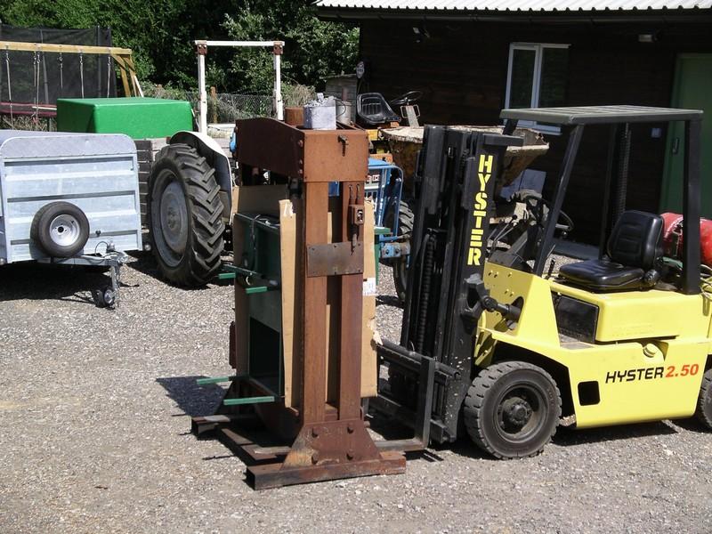

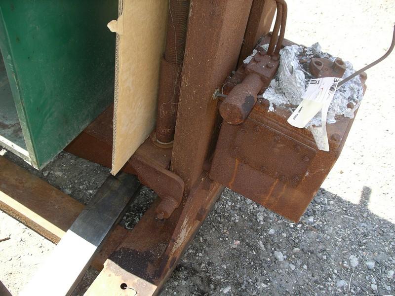

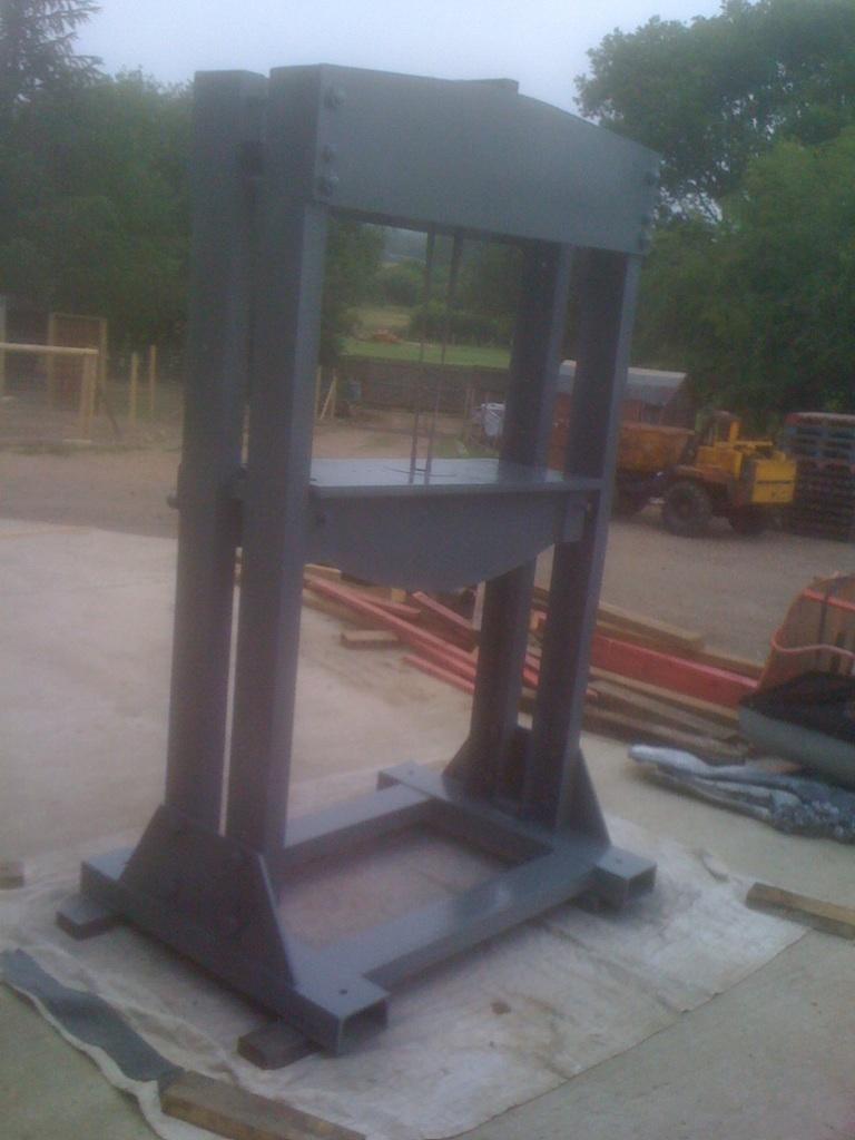

Well yes that's what I did when I first tried it - vigorous shake forms a temporary emulsion but it soon separates out again. It was this formulation I used to pull my fire damaged hydraulic press apart last year.
