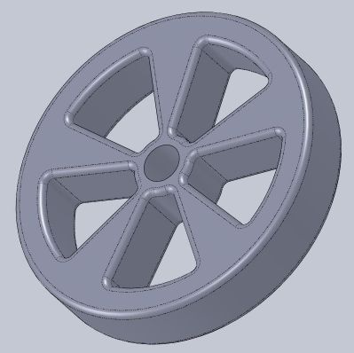

OK, so I've finally started to get the hang of SolidWorks. I've now got a wheel designed, with cutouts to make spokes, nicely filleted edges, yada yada. Now I need to turn it into something the Bridgeport will understand...

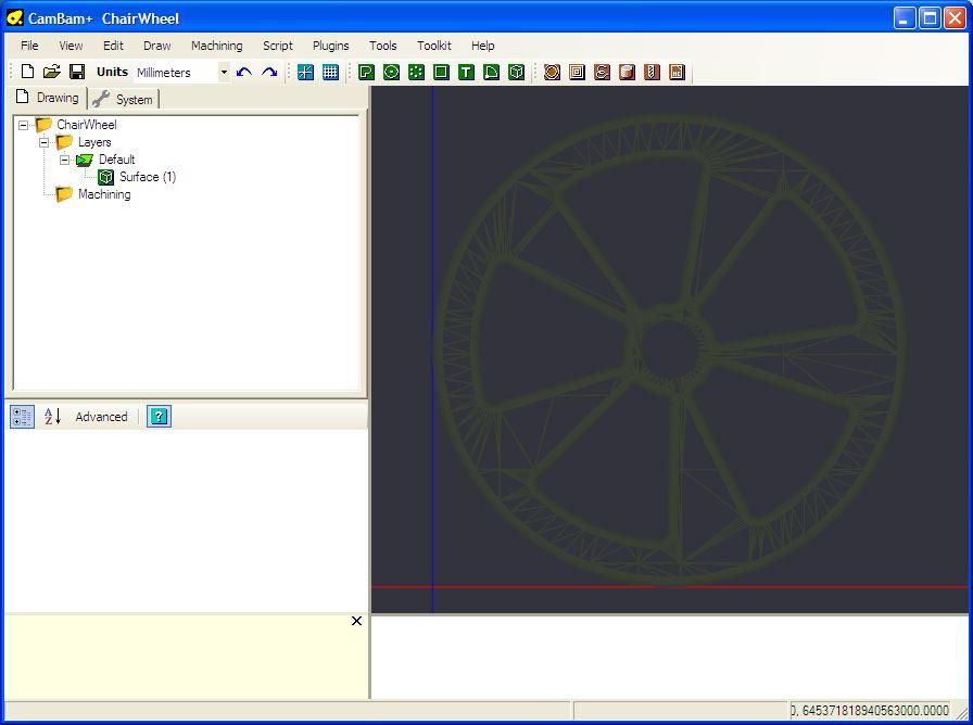

OK, so I've used SolidWorks to knock up my spoked wheel, and got to the attached drawing. I've exported that as a .STL file, which is the only common one between CamBam & SolidWorks.
So, now I have a picture of the wheel in CamBam - what do I do to turn it into machining instructions?

That will now need to be turned into polylines at least so that you can plot the machining lines. Then it is a case of creating a MOP from then on. Have a look at the Vids on their website, will get you going very quickly. I've not tried creating anything from a STL

« Reply #4 on: January 08, 2013, 09:02:28 AM »
http://www.cambam.info/doc/plus/cad/DrawSurface.htm
This is what a STL is normally used for

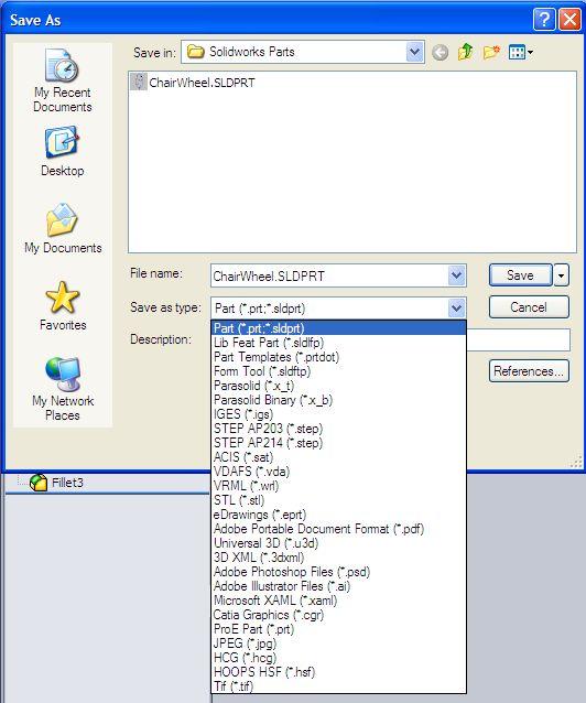

can you post the pic in 3ds or dxf format?

Apparently not.... these are the formats available to me (see pic).

Problem i see with the mesh fille (stl) is that the object does not always come out exactly as what you want (perfectly round etc). Attach the stl file so i can have a look in cambam

The STL format was developed for STereoLithography.  There are a number of settings that will determine the fineness of the resulting output that easily become either too coarse or too large a file for the intended recipient.  The resulting output is dumb (or blob) geometry.  I most normally deal with this (mess) for actual stereolithography operations and I quick discussion with the owner of the STL machine usually gets my file settings reasonably close to optimum.
I most normally work with fairly high-end CAM systems, so I am unfamiliar with the ones under discussion here.  Do these systems not import STEP, ACIS or Parasolid file formats?  Any of them would provide actual, mathematically founded geometry for processing.

CamBam is (as far as I can tell) aimed at the low volume/possibly amateur market(?), its import options appear limited.
Oddly, SolidWorks (2008) output options also appear limited, such that there is no decent crossover; SW will output STEP and parasolid files. Then again, SW costs many thousands of pounds, if purchased properly...

I can take the fillets off easily enough, can't do a DXF though, unless SolidWorks will output a sketch in DXF format....

It does DWG though i believe?

DWG isn't on the list of "save as" options.

If your going to machine the part as a 2d  part , you will need to do make a drawing of the part in SW , un check the display sheet format box , insert the correct view ,set drawing scale to 1:1 , then you can save as  DFX ,DWG.
PS remove/delete  other SW auto generated features from the drawing , like centre marks.
Re: What CAM?
