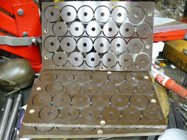

Chris, I used a home-ground trepanning tool to cut the biggish hole in the 6mm rectangular steel plate in the pic below, before boring it to finished size.
The tool was rather like a parting tool ground on the end of a square HSS blank but, viewed end on, the sides of the blade were curved to match the sides of the groove it would make, and then a bit more to give some relief.
If your brass sheet is relatively thin, you might get away with a threading tool plunged straight in,
particularly if you can work halfway in from one side and flip it over to finish the job. Then the circumference could be turned to size.
Andy.
