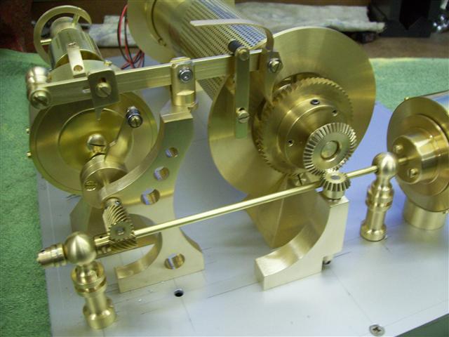

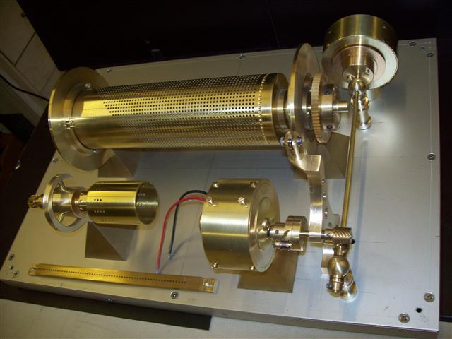

Hi Folks

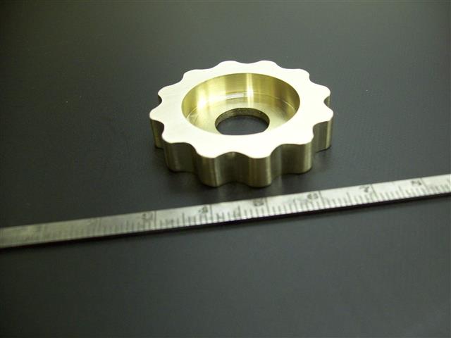

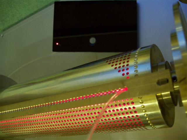

I thought i would inflict this on you as there seemed to be a bit of interest on a few other sites.  When finished it will be a clock that uses fibre optics to show the time.  In the pics there are four cylinders, one with an arm and a helical gear fixed to the shaft. This holds a synchronus motor doing 1rpm. the other three are all controled by the motor, the short one connected to the motor with the helical gear is for showing the seconds,and the other two for the minutes and hours. Inside the cylinders,lining up with the holes will be a row of LED's, and outside a row of fibre optics. As the cylinders rotate another fibre receives light from a LED to show the time. The other end of the fibres will be arranged in concentric circles around the clock face, seconds on the outside,minutes in the middle circle,and hours in the center circle.  I hope you can make sense of this. I first had the idea for this 32 years ago,but had neither the time or the means to do anything about it. It may be some time before it gets finished,but if there is any interest i will try to keep you up to date on progress.  Any questions, i will try my best to answer.   --------Some pics
Cheers Dek.

« Reply #5 on: December 19, 2012, 05:42:52 PM »
Thank you for the kind comments gents,I feel very flatterd.  Eric, I have no plans, i make it up as i go along. I made a prototype about 10years ago when i only had a X1 mill, then about 2 years ago i bought a new lathe and mill and i am using the clock as a way of learning how to use them.  Rob, I have to admit that the two parts that i have NOT made are the helical gears, ( they came from some scrap M.O.D. stuff ) but i did cut the two ratchet wheels using a 60degree dovetail cutter. I hope that one day i will be able to make things like your taper turning job to that kind of standard,  :bow:  Ralph, I think i may have thought of a way of cutting the cam on the mill with the indexer and a slight tilt on the mill head, but i will let you know if it works ok. LED's arived ok and look like being just the job. Next time you are over i will do you a swop for a few blue ones. (i bought 100 red, 30 green, and 10 white )  John, my pleasure to share, and i will keep posting, allthough my progress i fairly slow. :med:
Thanks again chaps.  Hope you all have a great Christmass and an even better new year. :thumbup:
Cheers Dek.

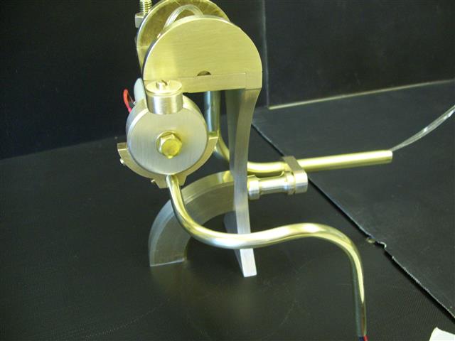

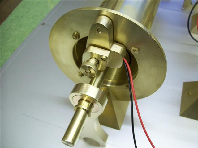

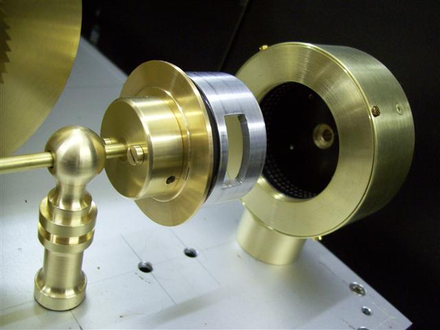

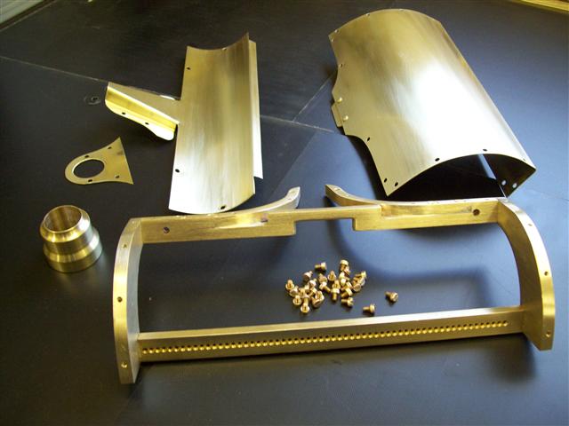

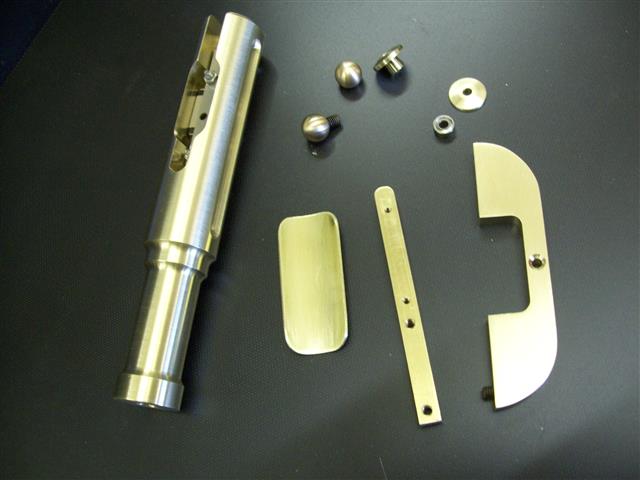

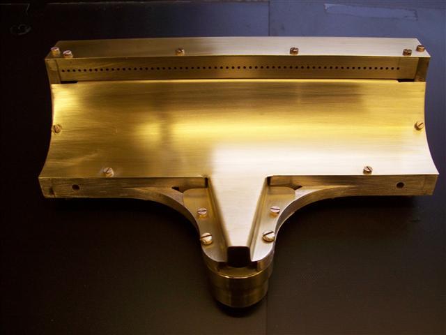

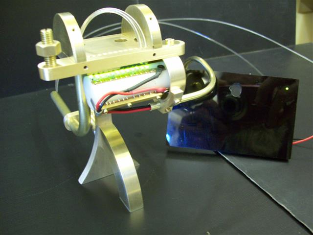

Hi Folks. Had about a month with no workshop time but back on the case again now so here are a few more pics of progress so far.

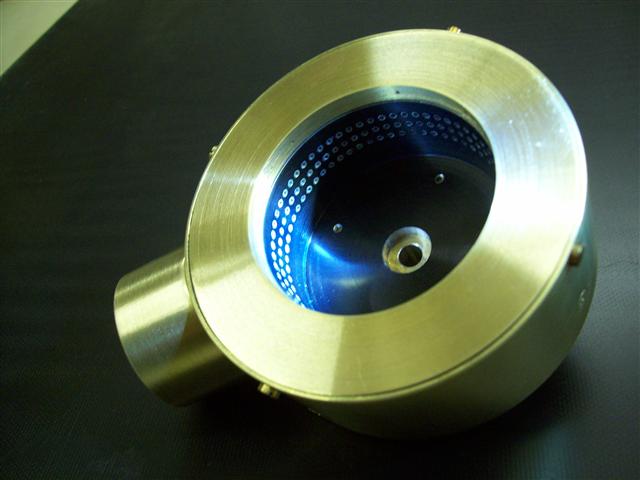

First pic shows linkage from motor to mins cylinder, and beval gears for setting the time ( sorry Rob but these are from the scrapyard as well ).   Second pic shows the ajustable holder for the LED unit.   Third pic has the bar that will hold the fibres, resting on the top with a single fibre in place, the other end of which is stuck in a piece of black acrylic to show the effect i am trying to achieve.

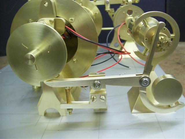

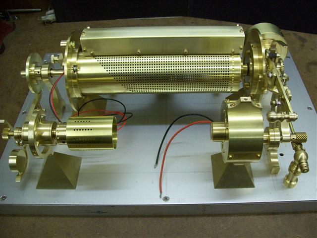

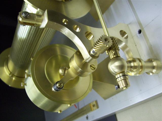

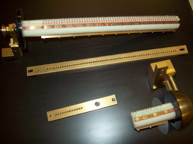

           It's him and that dammed clock again. :wack:  Got a bit more done, but slow progress, a few more pics here.

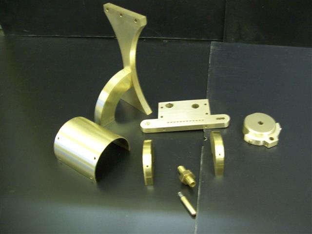

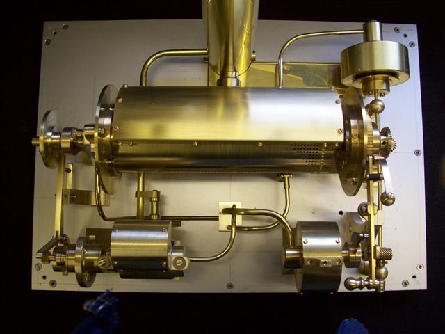

Not sure what order they will appear but they include :-the bits for the assy that will hold the mins fibres, the bits assembled, a view of the cam and link to the hours cylinder, and a view of the whole so far.    Much more to come but it may be a while as "men in sheds" may be having a go at the Red Bull soapbox race and i will be very involved in building a soapbox. :scratch:

« Reply #15 on: February 06, 2013, 05:25:06 PM »

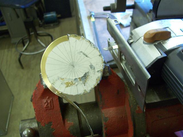

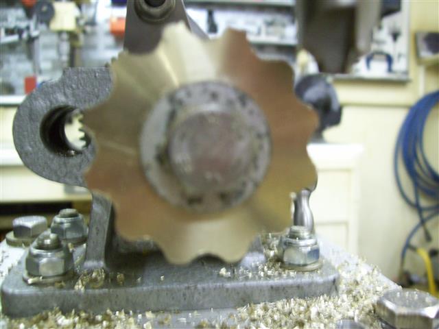

Do me best Ralph, do me best. :palm: Remember talking about that cam ??? well here is a pic of how i went about it. I first drew it on a sticky label then cut out with jigsaw and a lot of VERY carefull filing and checking with a DI. :scratch: Should have let Ade do it realy.

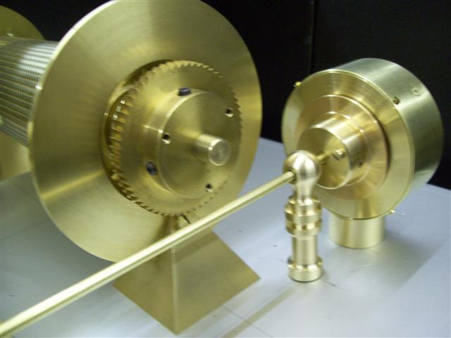

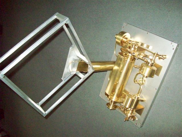

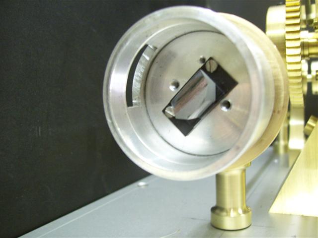

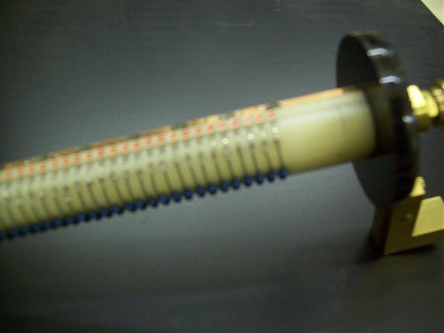

Slowly getting there with the clock. :coffee: Allmost finished the main mechanism, then it will be sort out the perspex , strip down, polish, and final finish. Sounds easy when i say it quickly.  The latest pics show the bits for the hours unit,then the unit assembled with a piece of black perspex to the right. This has a fibre in the top right hand corner just to give an idea how the fibres will look on the face,allthough at the moment the LED's are running under voltage so not as bright as they will be on the finished item.
There are a few pics of the (allmost complete) mechanism,and a very distorted one with the frame for the clock face in place. The frame looks much bigger than the base in the pic allthough it is realy smaller.

             I have only managed to do a few more bits (pics below) since my last post on here as I have been
quite busy at "men in sheds". They have bought an SC3 mini lathe from Arc Euro (fantastic service from Ketan)
and I have been sorting that out.  You could allways pop over and visit John and myself and see it "in the brass"
             Cheers Dek. :med:
