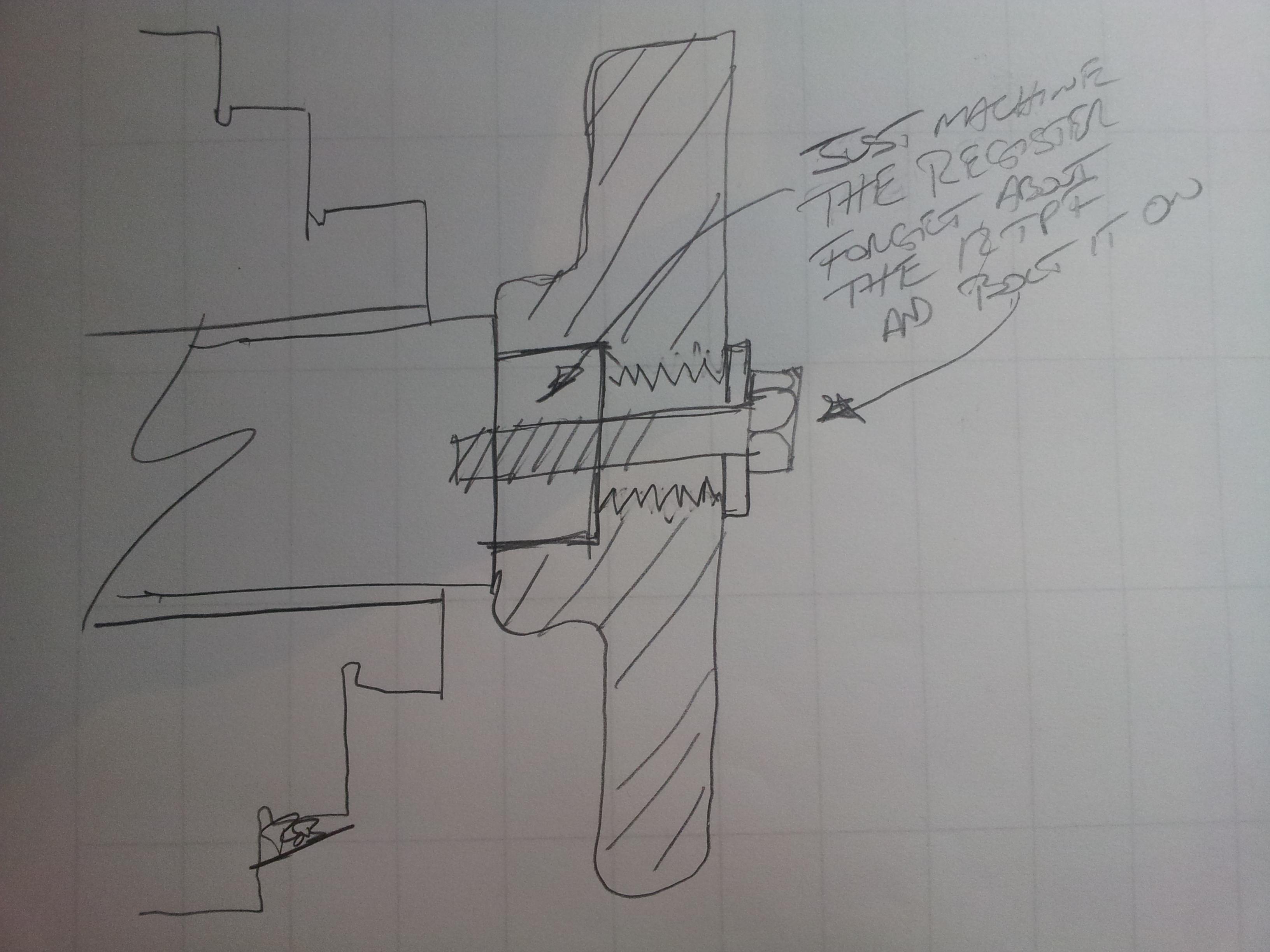

mount a  length of bar and only turn the register ,forget about the 12 TPI and bolt the back plate to the bar for turning .
A Gold Star for you Rob!  :clap:
Why didn't I think of that?

Forgot to say after mounting the  back plate to the mandrel and screwing the bolt in I would centre drill the bolt head and use the tail stock for a bit more support .
Rob,
I didn't see the huge photo.
I wouldn't have used a left hand threaded bolt! :lol:
