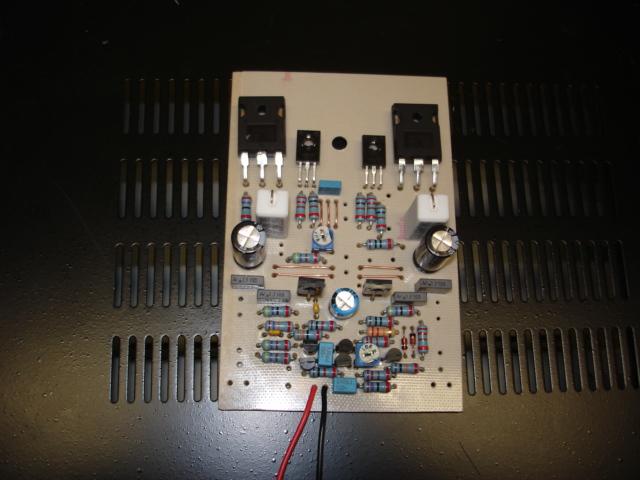

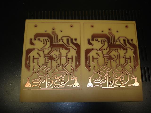

I made this board up for an amp project last month.  I take my paper to Kinkos and have them print it for me.  I have them crank up the toner for me which seems to help provide more toner to transfer to the circuit board.  I also bought a non contact temp gun so I can test my iron which helped me find a good setting to use.
As for the drilling, right now I'm using a Dremal tool with a 90* head on it.  The bits I'm using are really tiny diamond balls which seem to be working good, but I plan to buy better bits in the future.
I don't buy the special etching acid any more and simply brew my own.  It works better and is cheaper.  I buy Muriatic acid from the local hardware store for $5.00 a half gallon.  Then I add hydrogen peroxide to the mix and it's ready to go.  If the etching slows down add more hydrogen peroxide and it will pick back up again.
Good luck!
Dale P.

Dale,
Nice job on the boards...
What are the o/p devices? transistors or mosfets?
Care to share the schematic?

The amp is not my design, I found the plans on this web site.
https://sites.google.com/site/quasisdiyaudiosite/nmos-series/nmos200-1
I'm building the TO247 version
