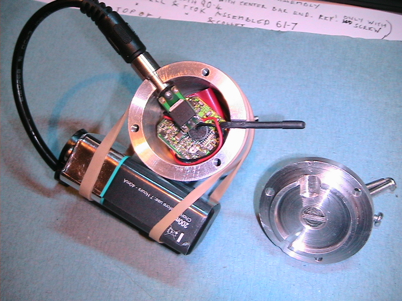

Hi pekka and all,
Got some pics of my cam.
first one shows the general idea. the innards came from the little black case on the right.
I put the brass adjuster in but its not really needed if the case is extended a bit. just trial and error to get the best mag/size/depth of field required. The lens is the one that came with it mounted a bit further away from the sensor.
the sensor board was glued to a chamfered brass ring which is centred with the three cone point screws
Second is the back.
The body was bored from this side then the lens mount bored and threaded without removing.
The back plate was made and the pin (which locates in a bore not just by the screw) tightened into place with thread lock prior to machining the diameter that locates onto the bore.
Basically I just made it all as concentric as I could, probably didn't need to be so fussy.
The insides. Note the socket on the lead from the camera had a voltage reg moulded into it !
Don't just cut the wires!
The view on a tiny 5inch B&W tv sorry the pic is rubbish this looks a lot better in real life.
The rule in view is 1/2mm Divisions -yes half millimetre so about 40x mag 80mm screen height.
Using this is a bit weird as the camera is free to rotate, its worth putting a big mark on it to indicate bottom of picture.
optical - mechanical alignment is in two parts
Lens to axis - can't do much about it, it's as good as it is.
Sensor to axis set with screws so sensor centre is roughly mid screen.
doesn't seem to matter much.
I mark the screen with an edge in view, rotate 180, mark again split the difference to mark the centre.
Do the same on the other axis.
Now you have a spot the  middle-ish of the screen that corresponds to the axis of the spindle.
Hope some of this makes sense.

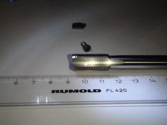

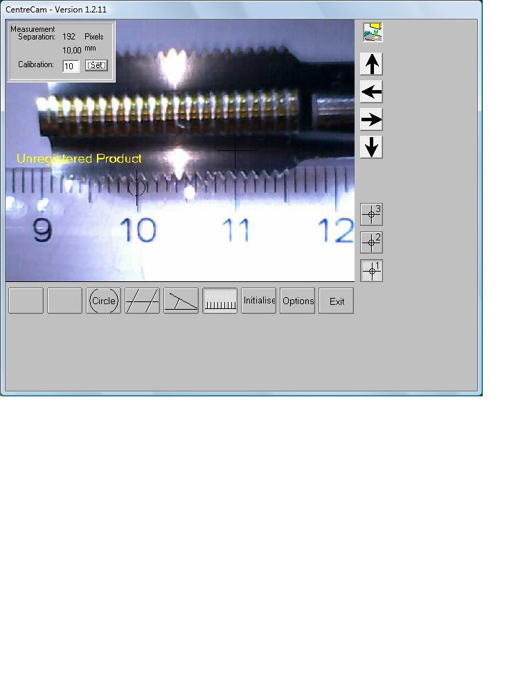

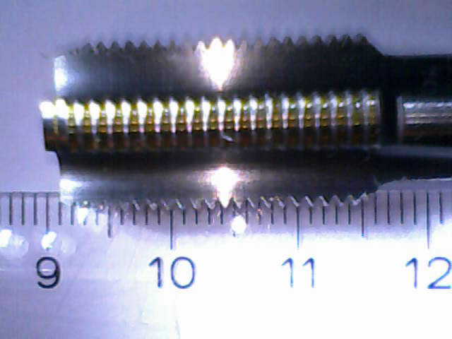

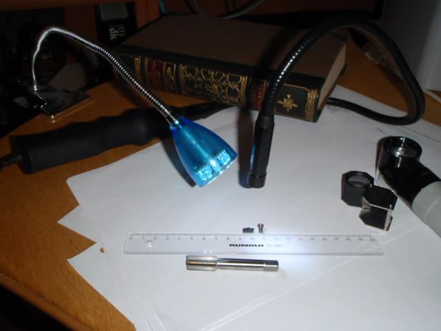

Thank you. I tried it and almost gave up installing it to celeron/vista combo. When I gave up and pressed a wrong button, it proceed to install. After something like five trials.
Only USBcam available was this contraption, sometimes described as snake cam, but it seemed to work with AMCAP.
http://www.clasohlson.com/uk/USB-Inspection-Camera/Pr363804000
First picture is test setup
Then picture capture trough AMCAP
Same view from CentreCam (screenshot)
Same view with Olympus 850SW
Bottom line: This camera/light combination offers far less than 10x loupe or 3diopter magnifying lence.
Probably this is allready clear to everybody else, but I noticed that the object to be measured and calibration reference has to be very close to same level. I could not get even close to 0,1 mm accuracy with centrecam/snake cam combination, no matter how much I calibrated. But this cam has something to do with it.
I suspect that camera has to perpendicular to the sample and reference and manuals focus would be highly desirable, probably also one good magnification.

Centrecam- I did issue more than a hint about problems with  new versions of Windows.
Ah well :doh:

Yup. You did. I read. But had to try! I'm sure there is something in this cheap camera set-up that has to useful and I'm not going to leave no stone unturned until I'll fiqure out where it stops being viable.
I have been eyeballing Hemigways centering microscope kit. An alternative to it would be AV-camera just like above, but I need to figure out how much resolution/magnification is needed to center Mill/drill accurately.
I would very much like to have solution without too much complication, but if a PC or laptop is needed it must then provide something extra and not just sit there processor crunching something stupid and let me do all the work!
I think that most cost effective for measuremet would be to construct some sort of shadowgraph with 20x stereo microscope and micrometer movable stylys to measure objects on one axis. I could use this to inspect my lathe/milling tools and check grinding quality (with my present skill and equipment - lack of it!).
For centering I could build/modify led ring light and I would like rest of it be purely optical, but I have no skill needed to design/build one from scratch.....and I have given up finding one old in working order AND one that won't break my back&bank.

Just to add to my post a little (Did anyone see it?)
Once you have a mark on screen you can just use the mill handles to measure anything. my main use is to measure things that are flexible specifically razor blades, but pitch of screws, thin sections etc. would be easy.
as edge finding or lining up to a punched mark goes it's simple.
I can easily repeat within .025mm and with care .01 or less.
once linear dimensions are taken it's easy to just draw it in a free CAD package to get any angles or other info needed.

I built one like yours Steve, using the innards of a Logitech webcam. As you say, having the sensor on axis is not a big deal. I was worried that it described a cone when the quill was rotated. In retrospect, that probably did not matter either.
But I put it to one side when I realised that the 640x400 pixel resolution of the (free) CentreCam software would not give me the accuracy I wanted - not down to 0.01mm. Perhaps if I had bought the updated software it would have been alright.
