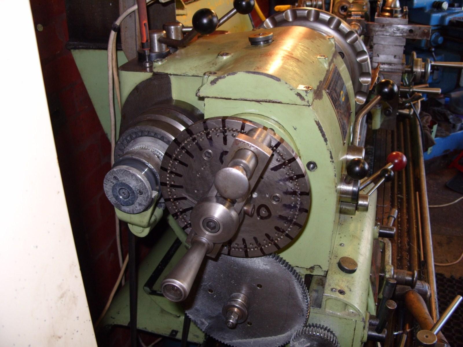

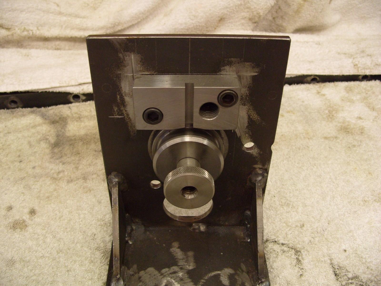

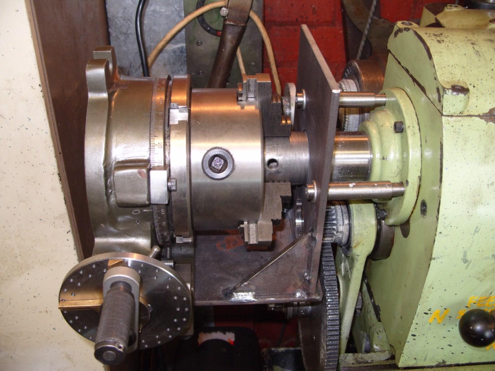

PeterE, your idea for a direct dividing attachment for the spindle, reminded me of how I got around that problem on my Master.
I wanted to make some more dividing plates for the miller, so I went this route...
Pics are fairly explanatory, the first was totally direct, the second was a bit more involved to get other combinations..
Chris

That rotab application is so clever it hurts me! :doh: Could have used something like that VERY many times.
THANK YOU!

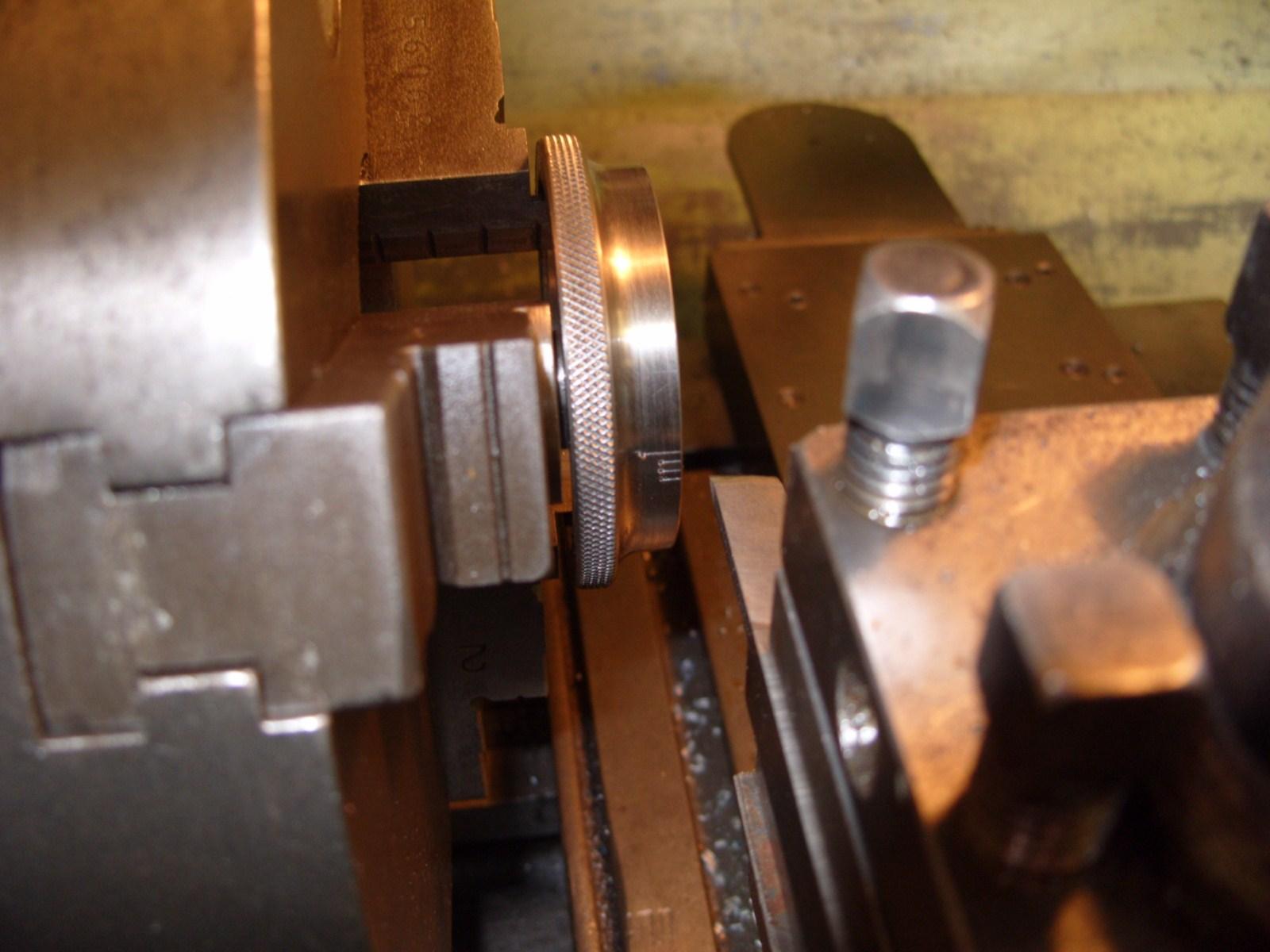

I received a notice whilst prepping this reply, the crank is located by a rusty looking tapered caphead screw, directly into the spindle protruding out of the rear, it's a handy place for all manner of attachments.
I also made up bar centering sleeves, an adjustable screw type chuck, drawbar  guide and a backstop, I'm afraid my backstop was very limiting to length
I actually posted the pics wrong way around, I used the rotab to help make the division plate for the end of the spindle.
I was making some 125 div micrometer dials for my MkI Clarkson, the MkII comes with that refinement.
The bracket was also used to help get the number stamping in line, on the dial seen doing on the lathe.
