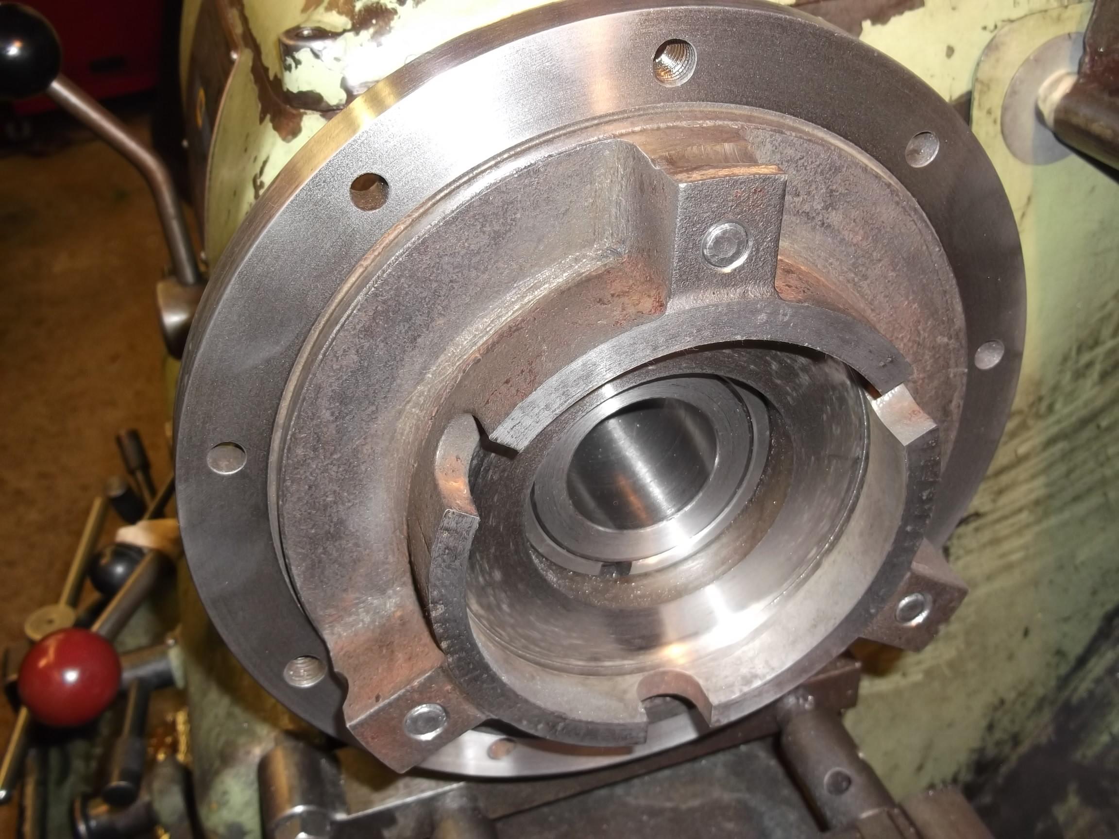

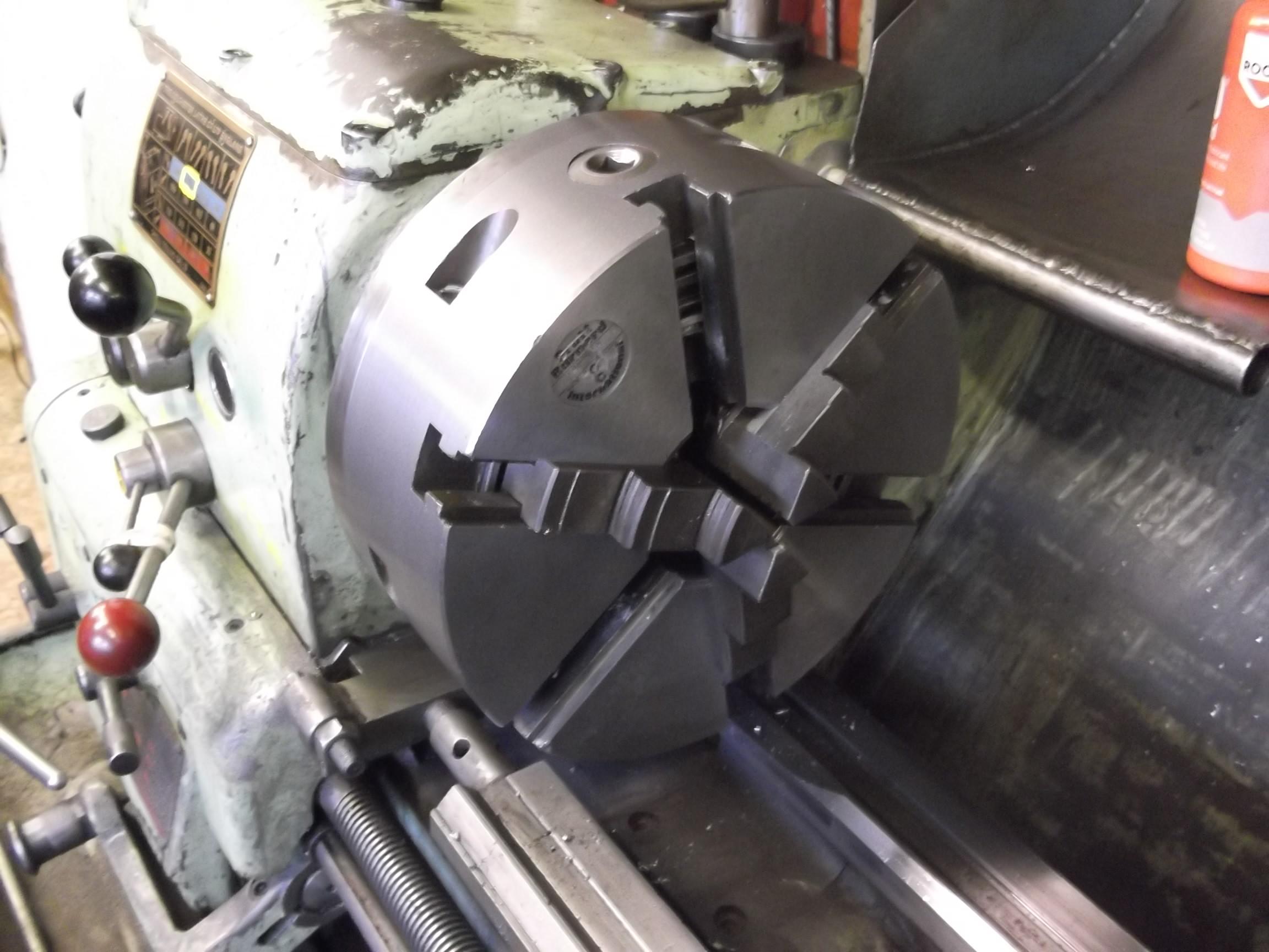

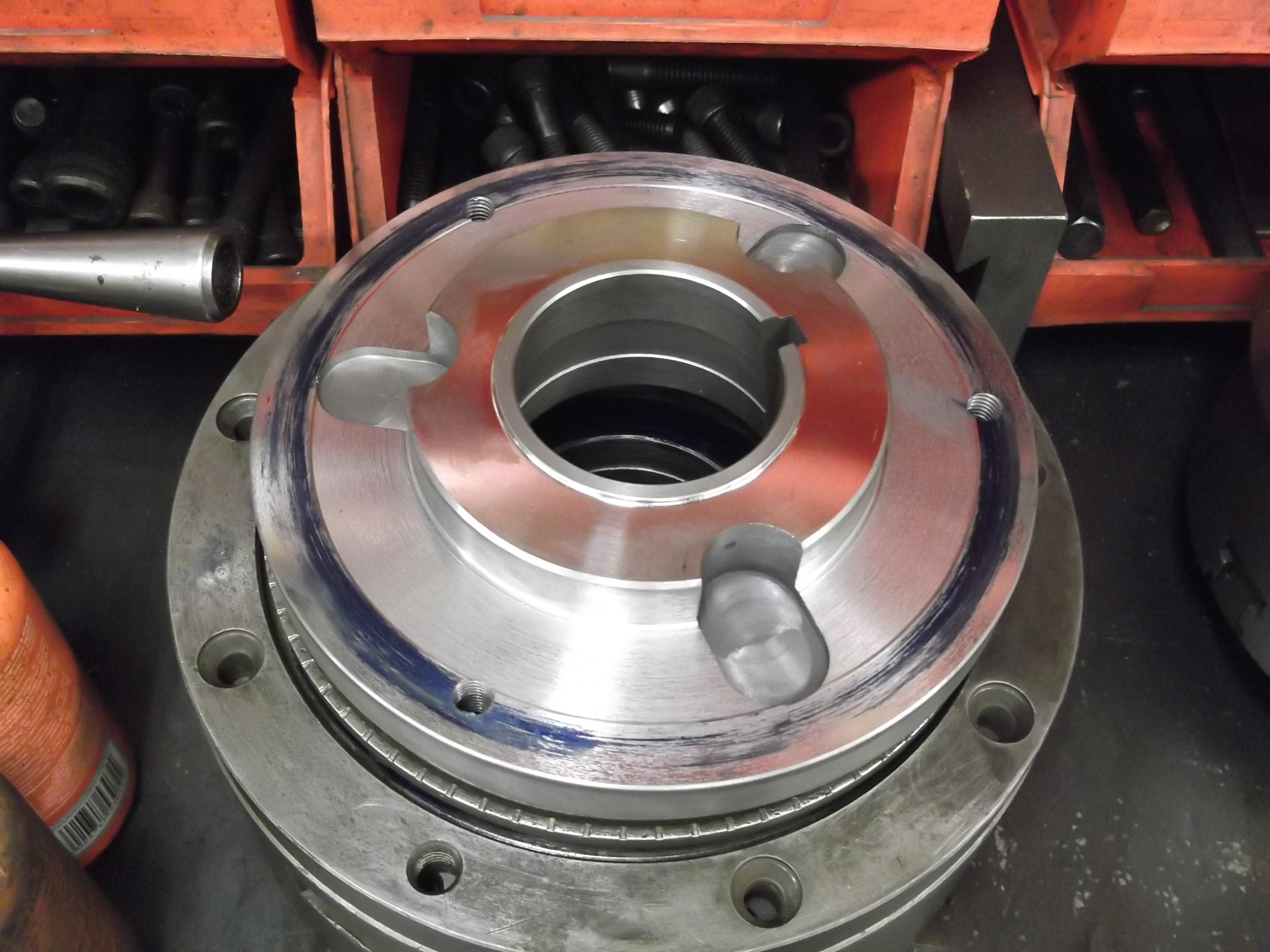

Hi Folks,

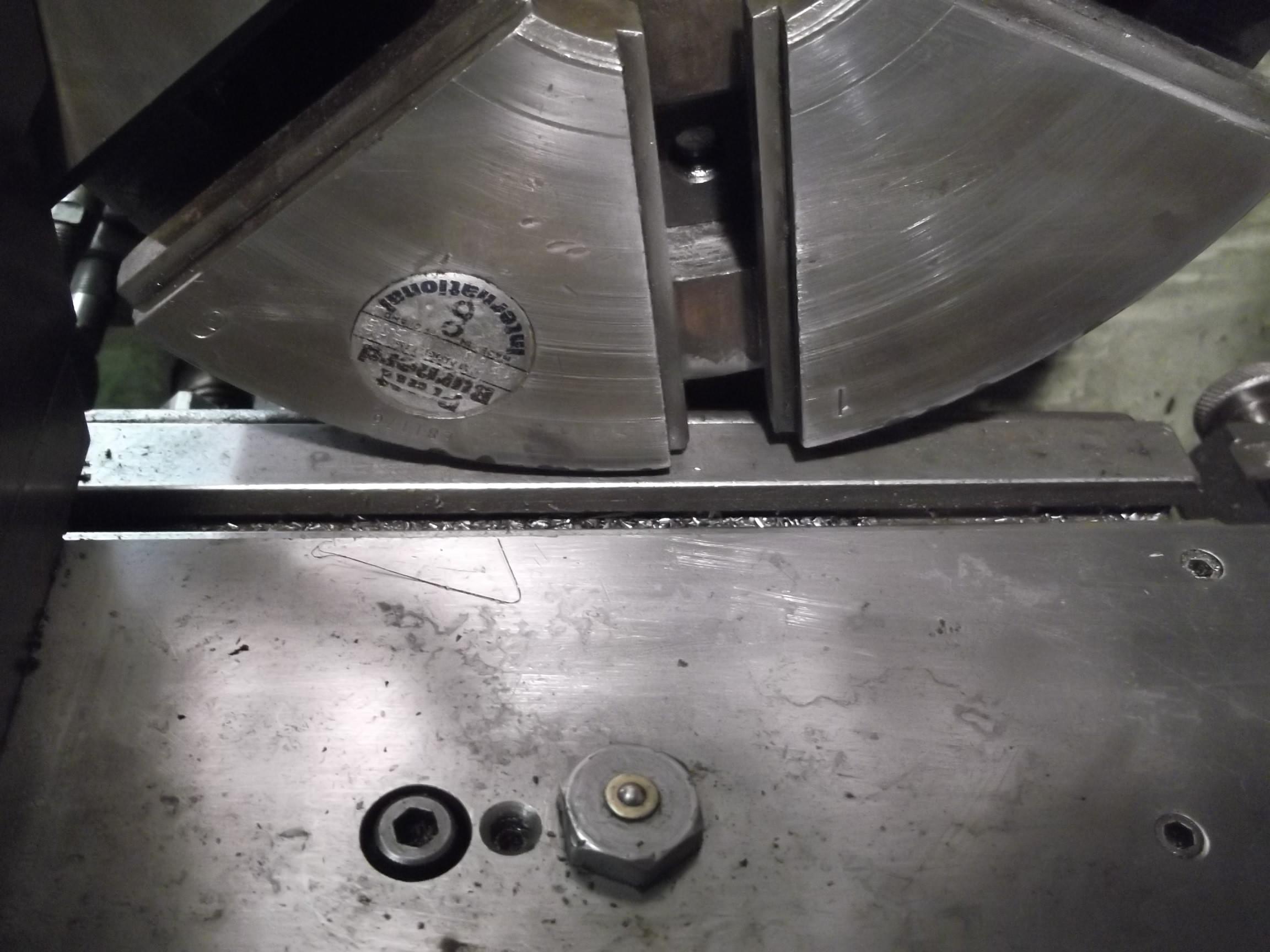

After seeing krv3000's mag chuck reformation, I thought I'd add my attempts at revitalizing a 250mm Griptru 6 jaw for my 6 1/2" Master.
I bought this for £125, but upon stripping, found it in a very sorry state, it was full of rust and gunge, most of the internals were quite badly pitted, and it was a sod to dismantle.

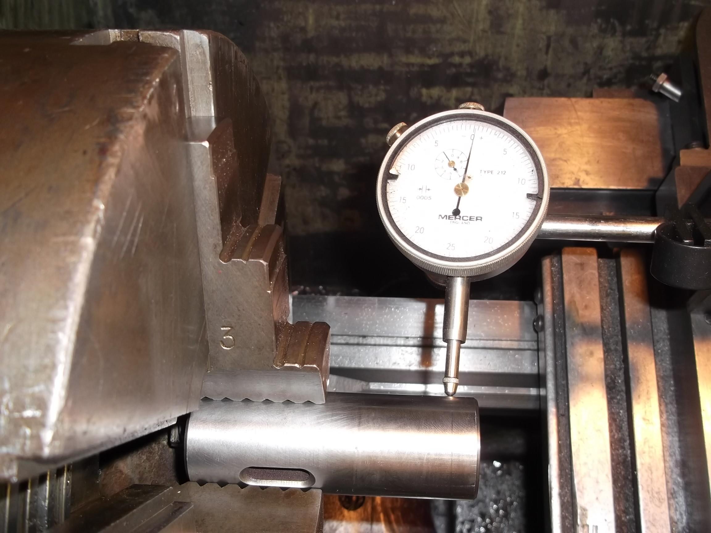

Starting with a much modified L0 backplate, (I'd tried making my own version of a Griptru, but failed miserably)...
Then to fitting it to the chuck back body, mounting on the spindle to true up faces, and reduce clearances to ones supplied by Pratt...
Chucked it all back together to test, and was pleasantly surprised at the accuracy so easily obtained...

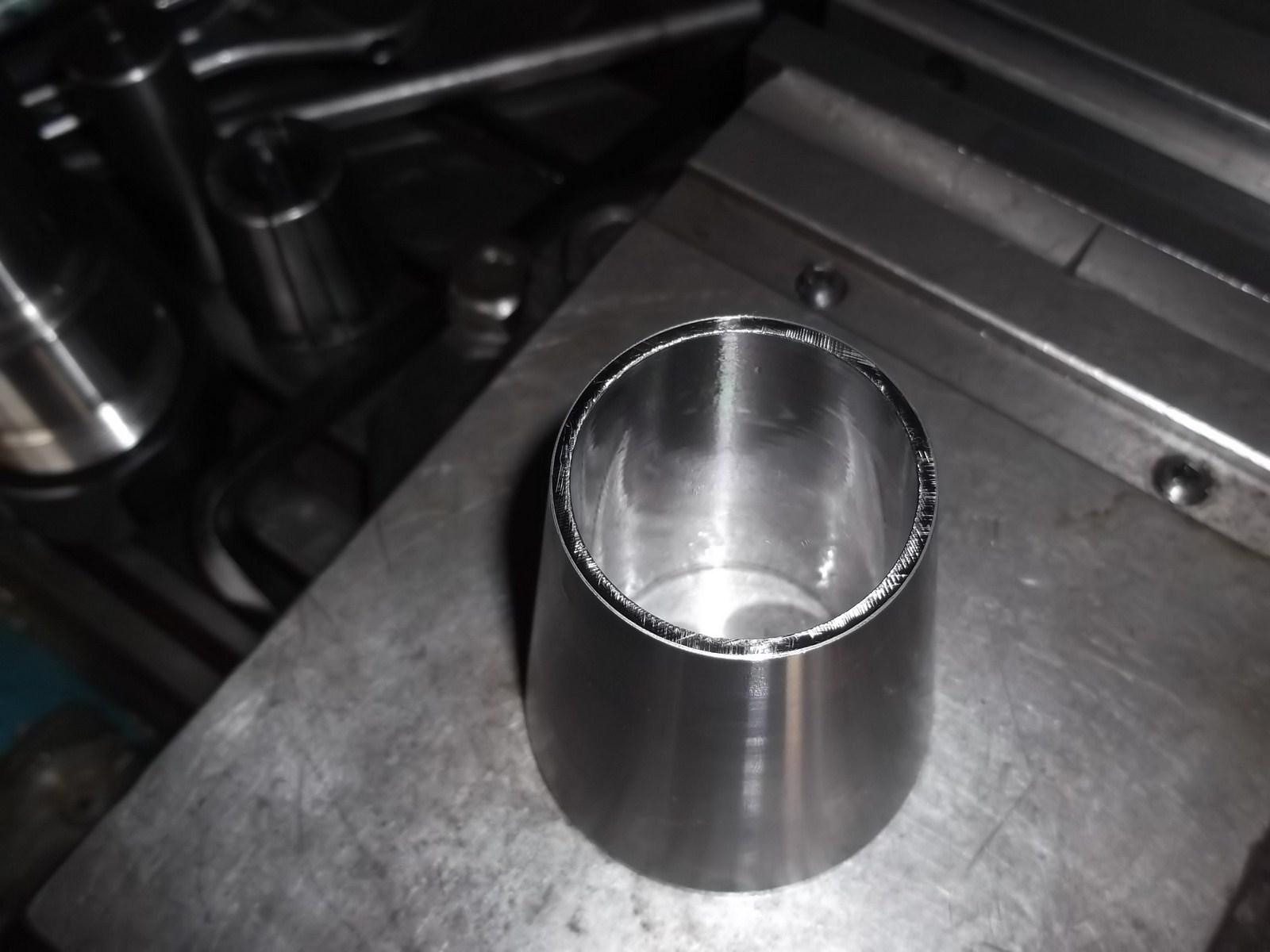

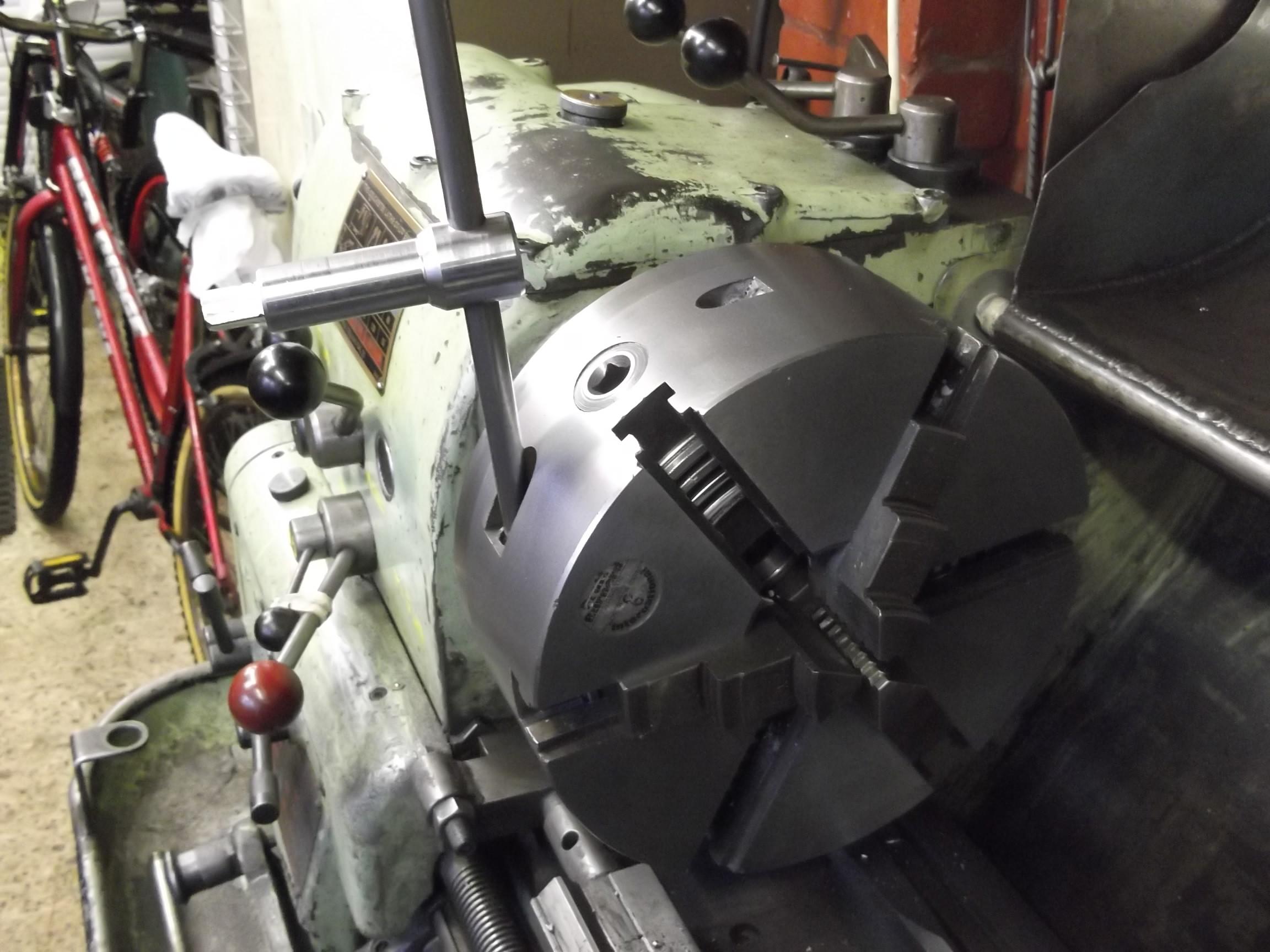

Stripped it again to clean up the outside of the main body, made up a new dual purpose key, and hey presto looks quite good...
Not much clearance to the apron though, but look at the bore.....

Hi Johnny,
I'd ordered a brand new 200 mm 3 Jaw Griptru @ £526 from Buck and Hickman last December, April this year with not even a likelihood of a delivery date, I got a refund.
Asked about at our local Autojumble (Normous Newark), and a tool stallholder said he had this 250 mm for £125, so I jumped at it, even though it only had the inside jaws.
No 6 jaw has the first scroll guide broken off, so I went for using just 3, apart from the likely ingress of swarf in the empty guide slots, the improved visibility far outweighs any perceived advantage of the 6 jaws.
On re-assembly as per advice given by a technician at Pratt, the 6 countersunk screws holding the body together, should only be hand tightened, I'm presuming with say a 'Tee' handled key.
I'm experiencing a slight juddering, (not previously noticed with my original 200 mm 3 jaw), whilst parting of at high speed, on materials such as En8M & En24T, so I'm wondering if the screws are tight enough, I'm thinking that some sort of torque setting would need to be applied, to give consistent sliding pressure to the movable body parts.
What size are you after? and what price range are you looking to pay, all the new ones I've Googled for, are as dear as a decent sized secondhand lathe, Jubilee Tools in Derby are listing an incomplete 200 mm 6 jaw Griptru for £475, I offered them £350 inc tax, but they said it would have to be with the tax, so I left it, I believe they still have it.
By incomplete I mean only the inside jaws and only 2 adjusting screws.

I think you will only get a Pratt Burnerd made Griptru, I have made several and numerous searches through the net, but sadly found nothing readily available, those that were, are too expensive and or incomplete.
How about adapting some soft jaws, with wider attachments, skimmed out to your desired gripping sizes?

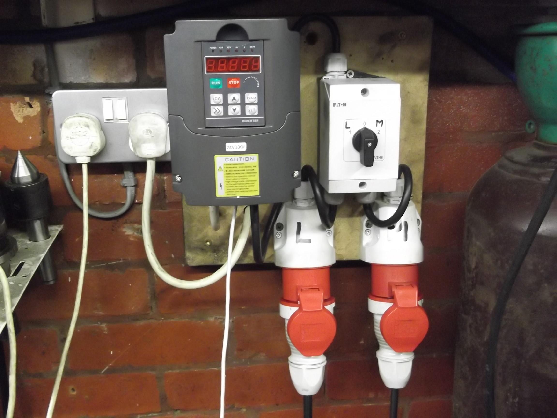

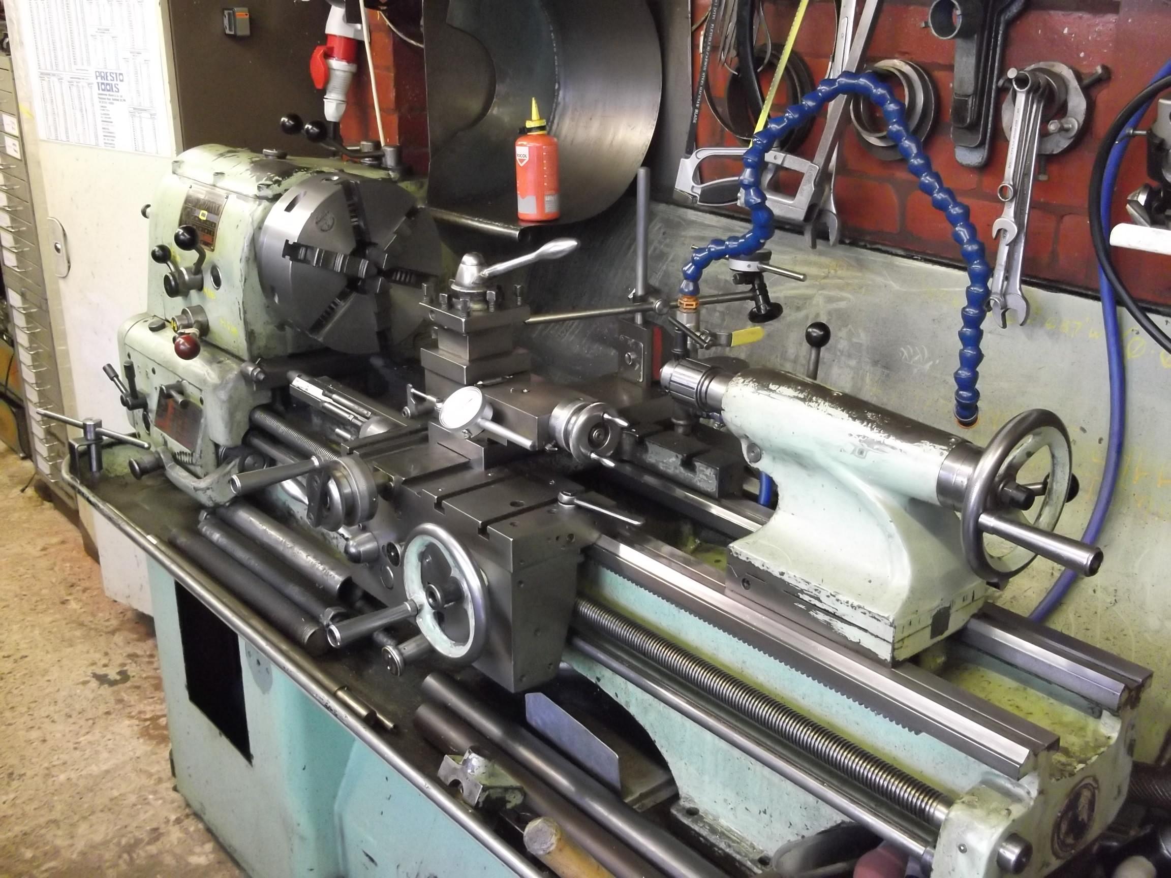

Funny you should mention startup problems though, I have to pull the clutch lever up very carefully on the Master, whatever speed setting I'm in.
Using a 4Hp VFD with a 3Ph 3Hp 3000rpm motor trips the overload protection in the VFD, if started a bit vigorously, anyway I'm of the mind that starting steadily is far better.
This is the case for both the Master and the Elliott Miller, with the miller I wind the speed up from 0 to 60Hz on the potentiometer, as there is a lot of drag through the gears.

Not being altogether very electronically savvy, but managed to wire up the remote for it to work as intentioned, as the vender whom sold it to me, did include a very simplified wiring diagram, I don't have the requisite skill to go down the route you have kindly suggested.
I'm not really sure soft starting is the problem, as this VFD does start up slowly even with the variable switch set at full Hz, on the lathe it's the sudden inertial loading of spinning up the heavy chuck mass, that can cause the trip out, then it's just a case of switching off the power, to, I presume let it reset itself and then restart it.

I was fed up changing over plugs from the lathe to the miller, so now I've installed a changeover switch, to have both motors plugged in, but just turn the switch.

You can kill the output devices on a VFD by switching it's output. I'm sure you only swap plugs when everything is off, but your arrangement would allow 'hot swapping' which would likely result in the VFD dying.
Offline rotorhead
  • Posts: 165
Re: Newish from Old
« Reply #10 on: November 15, 2012, 06:51:54 AM »
I do let the Hz drop to zero before either swapping plugs(before mod), or switching over, as I thought there might be a conflict with the VFD.
But do I actually need to switch the power off to the VFD?

Yes, I would turn the power off to the VFD before switching from one machine to another. Better be safe than be sorry.
Just thinking that, if you use the VFD to stop the lathe, you made need to set a long decelleration time or connect a braking resistor to the VFD to dissipate the energy stored in the lathe.

As I'll be trying the soft start method now, that'll mean engaging the clutch before starting the VFD.
To stop, I can release the clutch, then switch off or turn the down Hz, thereby protecting both.
It's starting to get a little more complicated to achieve a more satisfactory result, but better safe than sorry, eh?

Luckily all my motors are dual voltage, I certainly now like the ability to raise or lower the frequency/speed of the motor, since assembling the remote control box.
I don't use that feature with the Clarkson, I usually run it at just 50Hz, that seems plenty fast enough with the pulley gearing.
It's only since fitting the 250 mm/10" Griptru that I've experienced the startup overloading, but it IS far larger/heavier even that the 10" 4 jaw.
Also I'll tighten the rear body countersunk screws, to see if that eliminates the juddering whilst parting off.
Time will tell, I'll give the suggestions a tryout this next week or so, and give an update of what I find to be best for myself and equipment.
Once it's running, taking a 50-75 thou cut on a 75mm dia 24T bar, with an 08 tip I have no problems.
