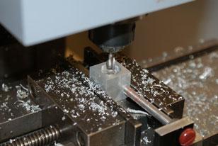

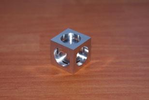

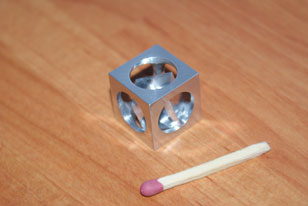

I don't have the necessary skills to make one of these on a lathe but with a CNC milling machine it is not difficult to do.
This was my first one but when friends saw it, their first words were "could you make one for me" - so I ended up making many more.
Tweakie.

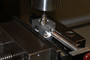

Making these is not rocket science – Once you have a cube of aluminium, using the Mach3 Pocket Wizard - pockets are cut in all 6 sides with an end mill / slot drill, then another pocket in each side with a dovetail cutter to create the undercut and release the cube. It is only a few line of GCode and cubes within cubes can be made in exactly the same way. The only secret, if there is one, is to use an end stop on the machine vice.
