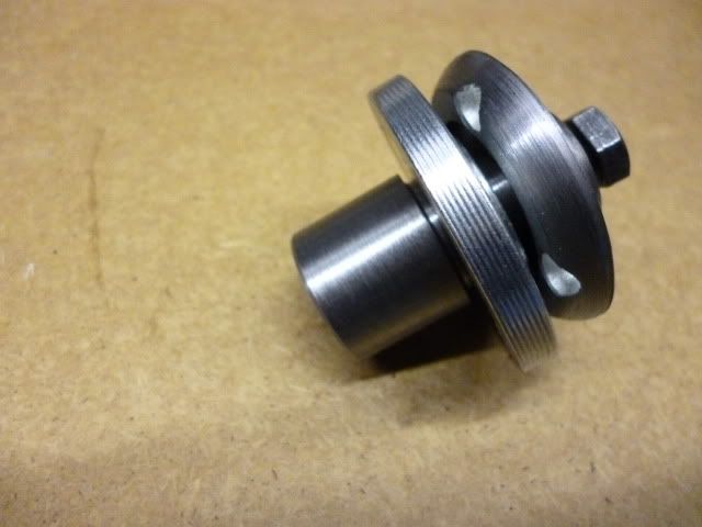

I bought a couple of sets of angle grinder disc nuts, and mounted them on stub arbours.........
Didn't bother with the M14 thread, just a slide on fit, and an M6 screw and heavy washer.......
Slips into the chuck........
Diamond rougher disc.......
Not quite so rough, diamond disc........
Old faithful, finisher..........
Works for me!  :thumbup:
